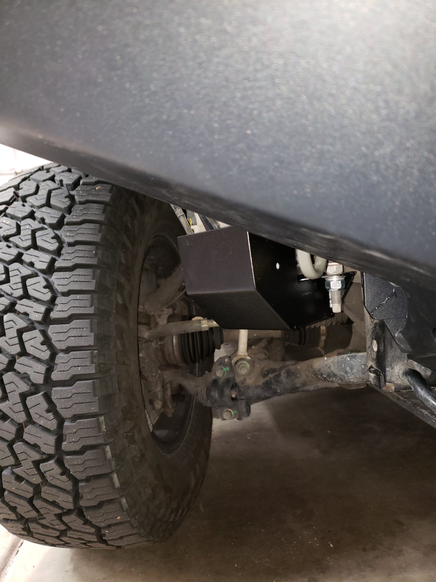

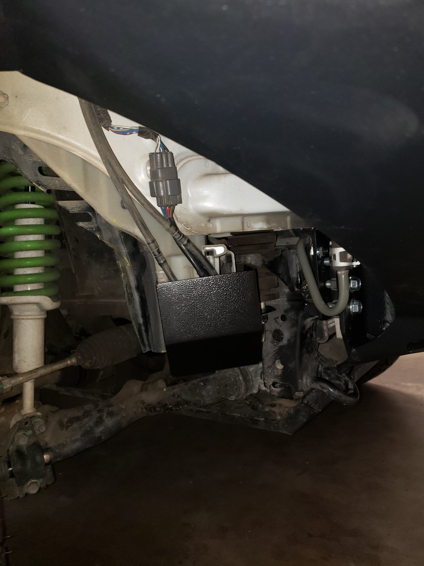

I got the SSO washer tank cover on mine. Seemed pretty straightforward? It only attaches using the body mount bolt, and didn't have any included hardware. I grabbed a 12mm fine thread nylock nut and some washers. I only have 2 pumps though. The single mount makes it a little flimsy, but I guess it's only there to keep road debris and branches and junk from hitting it.Washer Tank Skid. I am adapting a C4 part to cover my washer tank hoses. While fitting it in place I broke a very brittle head light washer outlet . It was very sloppy plumbing as OEM no issue for the first 100k until someone cut the bumper off a perfectly awesome car. I thought the head washer pump would fit better behind the skid box/plate if it turned a 90 upward just out of the pump. Pictures if progress. 5/16 x 1/4 brass elbow from Amazon.
The SSO one doesn't fit a three pump GX. I've been hacking on mine.I got the SSO washer tank cover on mine. Seemed pretty straightforward? It only attaches using the body mount bolt, and didn't have any included hardware. I grabbed a 12mm fine thread nylock nut and some washers. I only have 2 pumps though. The single mount makes it a little flimsy, but I guess it's only there to keep road debris and branches and junk from hitting it.

I just figured this out as well. I thought they sent me the wrong piece. I guess we are too “booshie”.The SSO one doesn't fit a three pump GX. I've been hacking on mine.
Standby I hope to have a solution by cutting it up, in the next few weeks.I just figured this out as well. I thought they sent me the wrong piece. I guess we are too “booshie”.
Both sides were pretty tight. It required a bunch of test fittings and trimming. An extra set of hands would of made it much easier.Is yours tight on the left side as well?

Both were tight for me as well, but for some reason the left side sat higher. Tried raising the right side but it didn't do much.Both sides were pretty tight. It required a bunch of test fittings and trimming. An extra set of hands would of made it much easier.
This was my 5th or 6th cut type bumper, second on this vehicle. After the first one I cut (Nissan Xterra) I bought the cheap trany jack. Heck I even use it on rock sliders.Both were tight for me as well, but for some reason the left side sat higher. Tried raising the right side but it didn't do much.
A cheap trans jack was absolutely pivotal.
