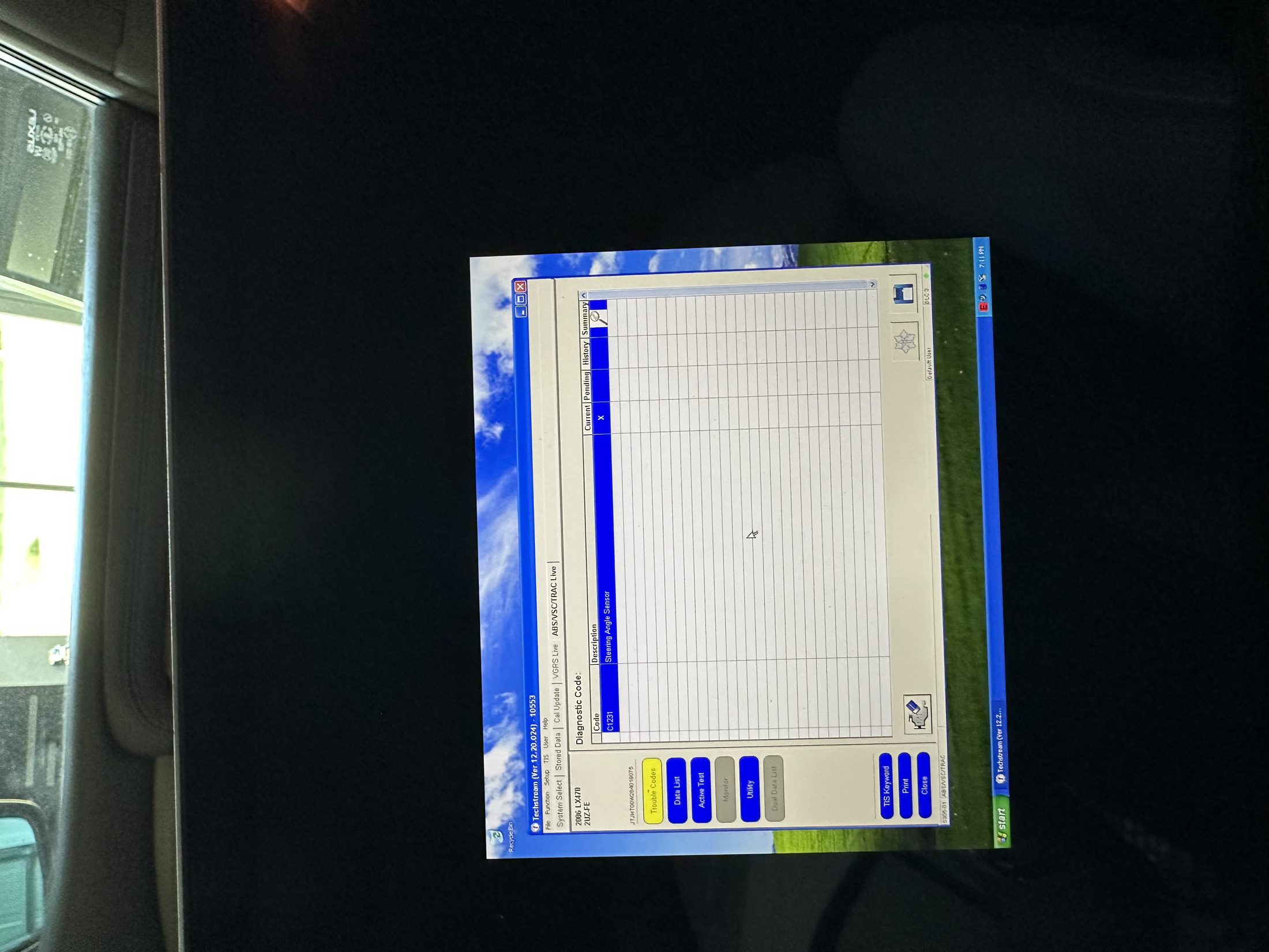

Last week, I triggered the light again and it has not since come back off. When I scanned the VGRS module with Techstream, there were two codes stored in the VGRS (C1552 Actuator, C1555 Predriver) and two in ABS/VSC/TRAC (C1231 Steering Angle Sensor, C1290 Zero Point of Steering Sensor). C1555 and C1290 would clear in Techstream, leaving the others remaining.

Now, I still have C1522 Actuator in the VGRS and C1231 in ABS/VSC/TRAC. Whereas before only the VGRS light was on, now both VSC/TRAC lights are on. Neither code will clear.
