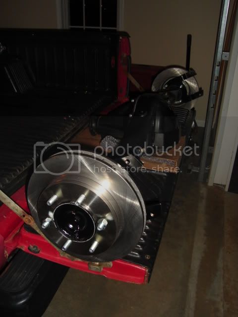

so i upgrade the brakes and widen the front. got a used sky mfg kit on fj60 rotors and big ifs calipers.

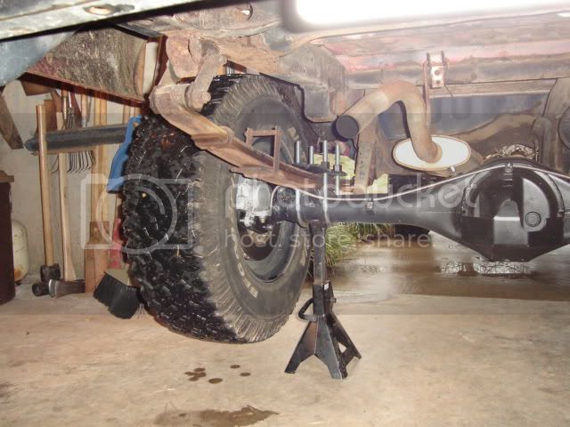

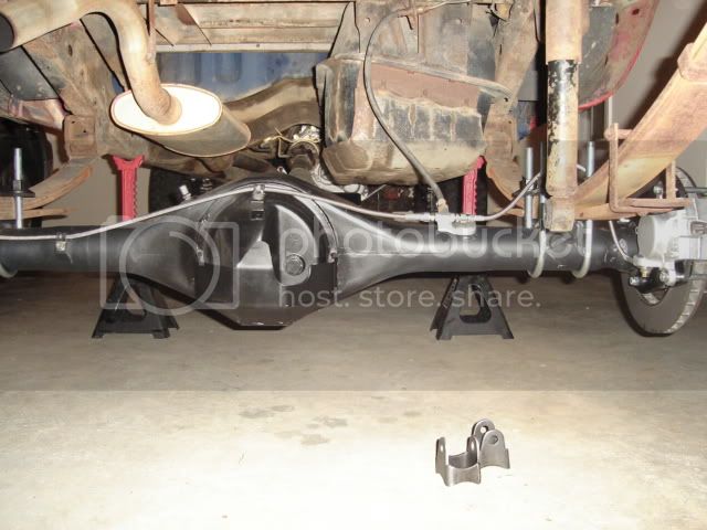

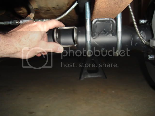

Also grab the u-bolts and bracket cause the tube is a little bigger than the old axle housing, so yur old hardware won't fit. Ask me how I know :rolleyes:

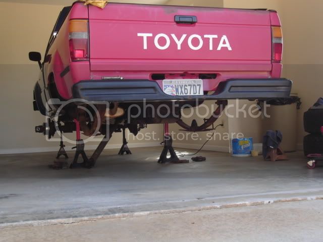

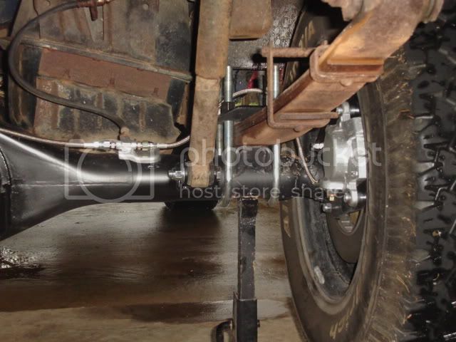

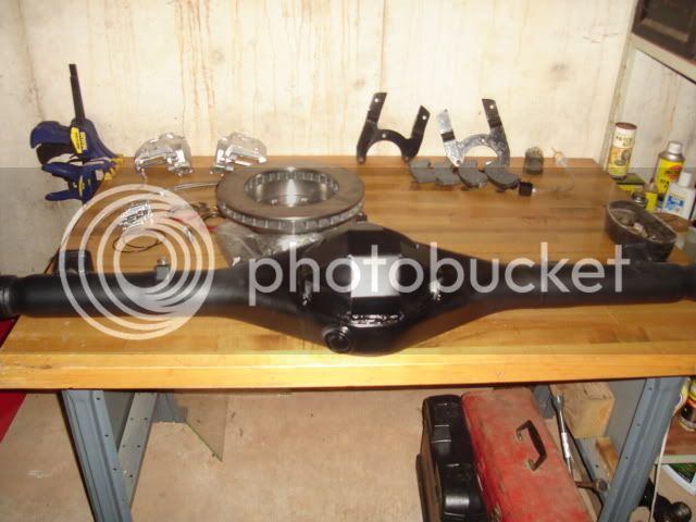

Here's what I did.... Swapped in an '86 T4R housing and some other stuff... :D
You can also swap in a tacoma rear axle for additional width and even upgrade to the TRD Elocker/ This is what I did and just modified the brake lines and ebrake to work on my 4 Runner.
