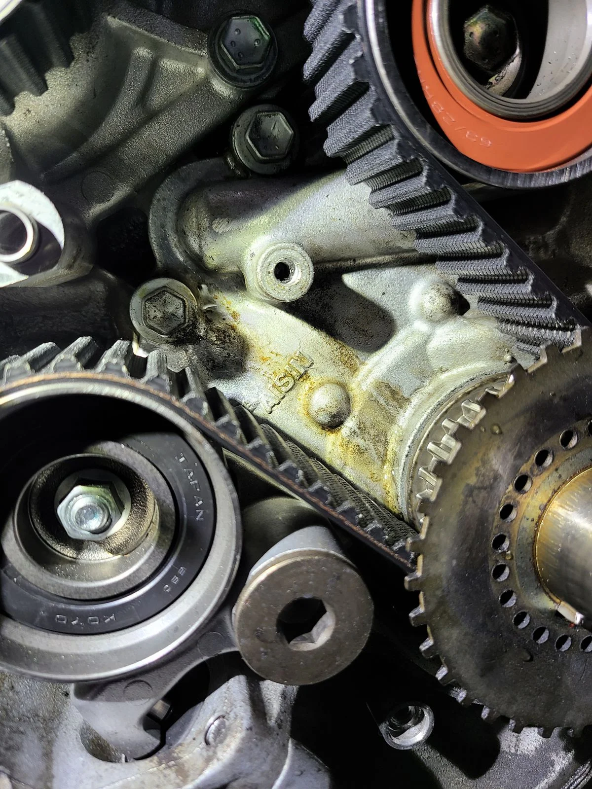

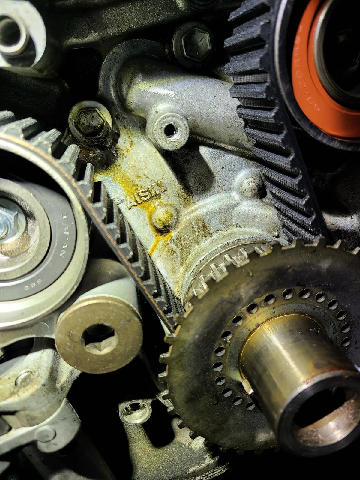

They're now claiming the oil is leaking from between the oil pump and the block causing the oil to be carried around the timing belt routing.
If this is true, how frequently does this happen on the 2uzfe?
Can changing the timing belt and camshaft seals possibly cause this?
How involved is this to fix?

Never heard of a factory, untampered 2UZ oil pump leaking or needing replaced. Sounds like horse**** to me. Did they provide photos? That would be tough to prove.
Never heard of a factory, untampered 2UZ oil pump leaking or needing replaced. Sounds like horses*** to me. Did they provide photos? That would be tough to prove.

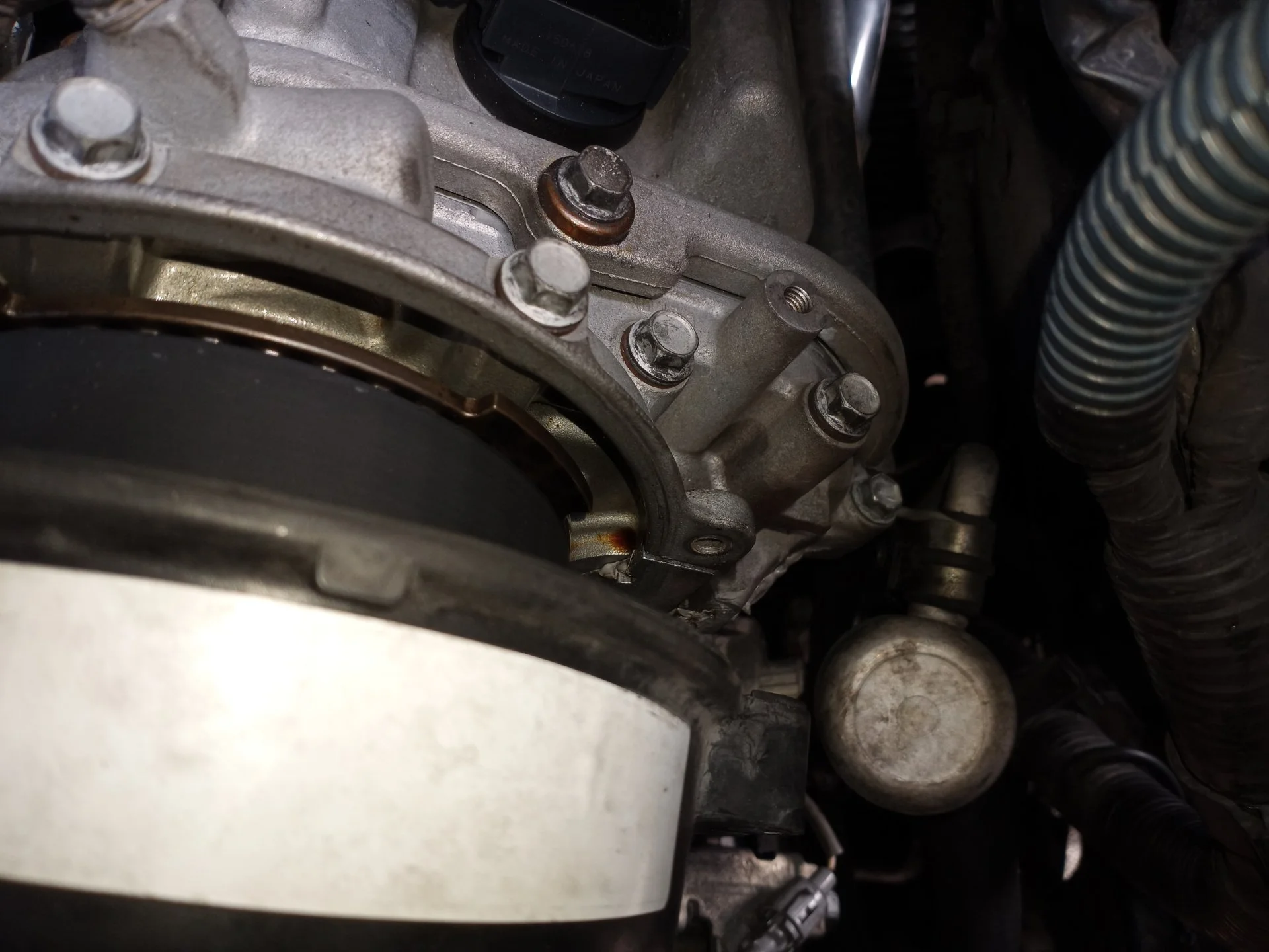

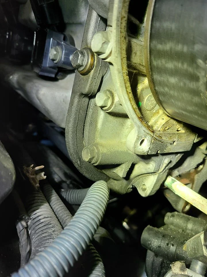

They said they put dye in previously to try to determine where the leak was coming from.
The current leak is a hell of a lot more than what was leaking when I first had the camshaft seals replaced.....because of a leak.
I would inspect myself or get a second opinion at this point. That shop has proven to be a bunch of bozos. How much are they wanting for it? Are they charging for ‘troubleshooting’ if you simply say no thanks?
No additional charges since the initial camshaft seal replacement.
I have never seen a oil pump leak on a 2UZ. It’s not a small repair. Pretty sure the oil pan has to come off to do it right. Looks to me like you have multiple leaks. Most likely caused by poor workmanship and/or misdiagnosis. Personally I’d take it somewhere else. Have them clean it and see what is really leaking.
A cam seal or the front can bearing cap leaking will make a mess. Will drip all the way down front of motor. That might be all it is.
The oil pump replacement pays over 21 hours labor. The repair manual says to remove motor! The oil pans have to come off, no way around it!
Just a heads up! Definitely get a second opinion.

F that. Depending on how bad its currently leaking Ill add some oil stop leak additive and if that doesnt work, just live with it and call it a day.
Any way them doing any of the timing belt, water pump, camshaft seal replacement could have caused this?
I don’t think so. But like I said before I’d clean it up and make sure it’s actually leaking from oil pump and not running down from the cam seal or front cam bearing cap. They had to remove the cam bearing caps to do the cam seals. Probably didn’t reseal them right or damaged the seal during the repair.
They said they applied a dye to try and figure out where it was coming from. Still possible even with the dye to misdiagnose its source?
I asking around for estimates from another shop to diagnose an oil leak source and they quoted around 330ish to remove all the covers, harmonic balancer n such to look at that area to see. 3 hrs of work. Does this seem accurate?
Any recommendations on oil stop leak? Blue devil was on my list.
3 hours for the diagnosis seems right. It’s a lot to remove to get down to the timing belt then put back together, then diag on top of that.
I’d approach the second shop without too much backstory. Just ask them to find the leak and see what they say.
