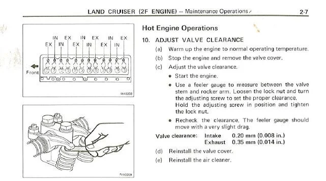

To try to regain my honor:
My mis-statement started a furor. I apologize for my mistake. The FSM title reads "Adjusting Valves" & "Valve Clearance Adjustment" & that phrase stuck in my mind. I meant to say, the FSM recommends the valves are CHECKED while the engine is hot and idling.
Since it is next to impossible to adjust a rocker arm adjusting screw when it is hammering up and down while the engine is running, it never dawned on me that anyone would even try.. Wow, the maintenance manual sure leaves out a few necessary words... like "Stop the engine to adjust."
Ok, enough of that...sorry about that.
86 Maint Manual
[Edit] - and just for the record (not that anyone cares), for the last 26 years I have always checked my valve clearances when the engine is hot and idling, then shut of the engine to adjust them, then start back up to check again. It takes a couple rounds. It is the method I prefer. Others may choose to do it differently. The end result is the same.
Tried adjusting my valves the way the manual prescribes Friday night and it was a CF. I know it's possible to do it with the engine idling, but I sure don't see how. I really screwed it up. Came home, did some more research, and decided to do it cold the way some on here have suggested. Worked like a charm. The engine runs smoothly, seems to have a hair more power, and I didn't notice the exhaust smelling quite as potent tonight. Now, if it will just help my gas mileage...

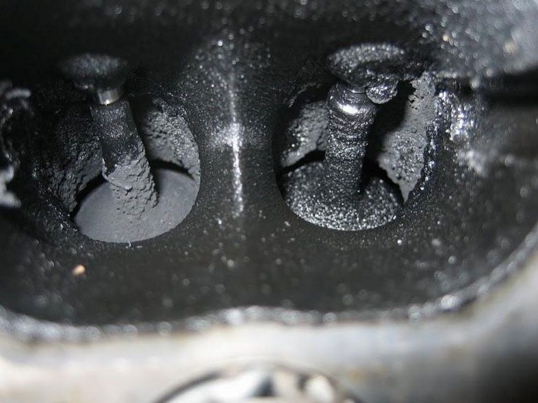

but I was wondering if it is common to visually inspect the valves through the cylinder spark plug hole to see if they are burnt or not...using some sort of videoscope.
Borescopes will not let you see if a valve is not seating correctly and leaking. In fact, even when the head is off and tilted on it's side so you can peer at it close up...with a magnifying glass, there is no way to visually tell whether a valve is leaking or not. Leaking valves usually look just like properly seating valves. As augirthedude mentioned, a compression test is the best way to check for leaky valves when the head is installed. Carbon build up on the valve is mostly detrimental on the stem side of the valve which could be visible from the port on the head via a journey down the carb and manifold using an expensive articulating borescope (not the one from HF). See borrowed web pic below (not a LC engine)
Valves can be kept clean by using good quality gasoline, running the engine up to full operating temp often, or spraying a little water mist or carb cleaner/sea foam into the intake of the hot running engine every blue moon.

Yeah, I was referring more to using the visual inspection (via borescope) for checking for discoloration of the face of the valve (rather than trying to inspect the seats) as an indicator of conditions of a burnt valve.
