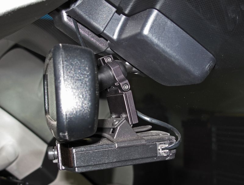

How do you like that V1 mount?
So there is not switched power in the mirror?
The mount is bullet proof - very sturdy.
I didn't want to go poking around in the overhead wiring.
:cheers:
I have a much older Valentine One. Is that a new mount or an aftermarket?
. Holy crap $90 for the mount?
