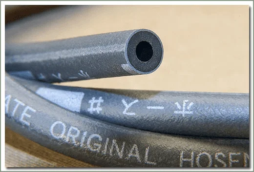

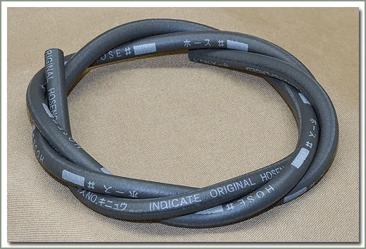

That stuff is so nice. You’ll be very happy with it. It’s better than OEM rubber.

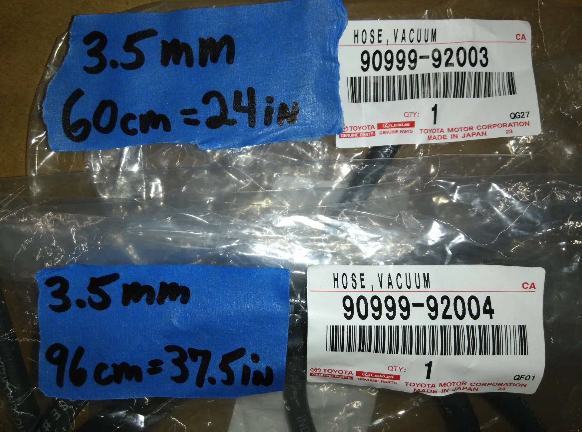

90999-92004 - qty 4
90999-92003 - qty 12
that’s the cheapest way to purchase oem vac hose for complete replacement of all 3.5mm hose. Unfortunately the 5.5mm is no longer, I’ve yet to find a suitable oem option.
Go through Norwalk Toyota or similar Toyota online parts. I avoid Toyota parts deal.
90999-92004 - qty 4

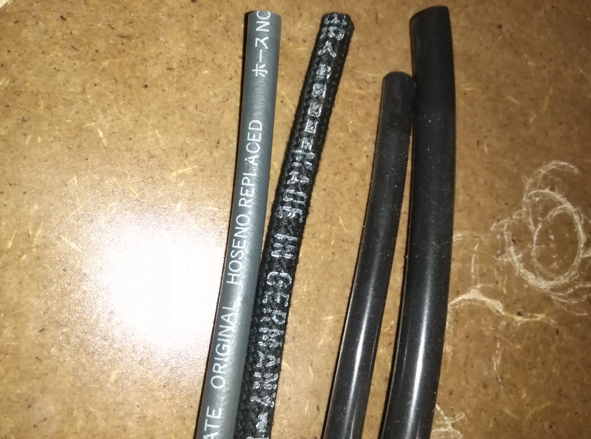

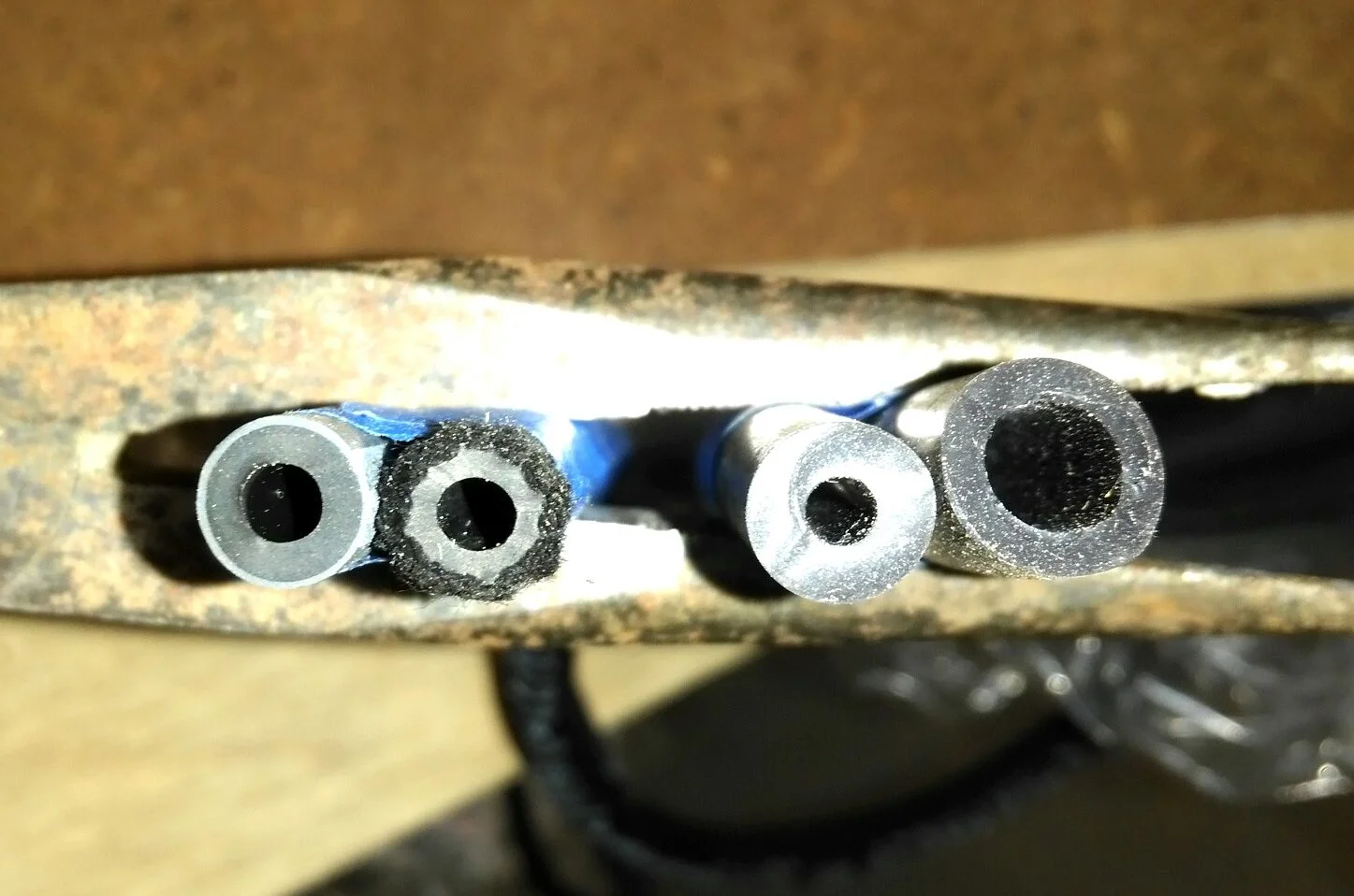

Left to right...OEM Toyota 3.5mm - Belmetric 3.5mm braided - McMaster Carr 3.0 mm and 6.0mm silicone.
Toyota comes in either 60 cm or 90 cm lengths.
Belmetric sells by the meter.
McMaster sells by the foot.
Just an FYI, Toyota comes in multiple lengths, the numbers listed before are the most cost effective.
I did not know there were more than two lengths available. Thanks. I do know some online Toyota dealerships will tell you that the hose is not available or have very little stock. It took me three tries before I found a dealer who said "sure, how much do you need?"
you cut off the prices for McMaster Carr, which I think are the least expensive of the bunch coming in at ~$1.50 per foot (ca. $4.50/meter). While it is priced by the foot McMaster these days only sells in fixed lengths: 10ft, 25ft, 50ft, etc. 20 years ago I used the softer durometer 50 tubing and it is still working great.
Thanks for posting those pix, @Don Pedro I really like the cloth-braided hose, and it lasts forever.
The braided looks and feels solid. Made in Germany. Then there's the "can't go wrong with OEM". It may come down to best fitment. And I'm not adverse to mix and match. I will be replacing all the hose on the 2F.
