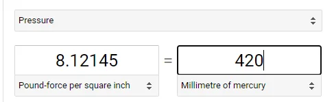

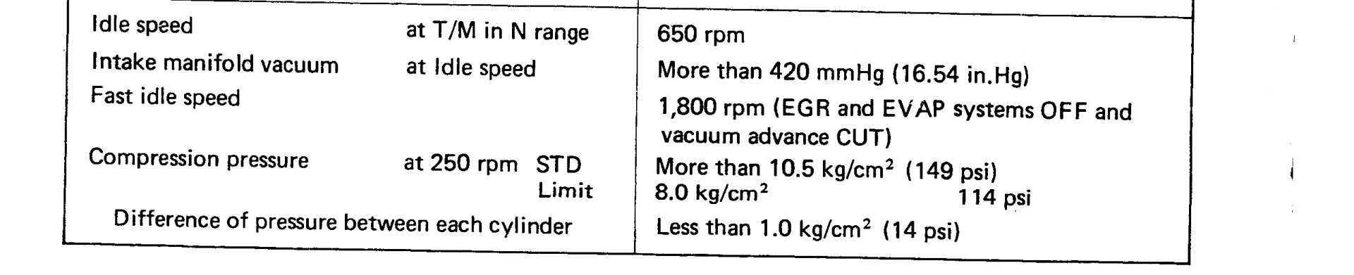

Gates lists theirs at 25 PSI max. I cannot find specifics on the max PSI developed in the vacuum system of a working 2F motor right now. Seems like 11PSI is what sticks in my head but not sure at all about that so don't hold me to it. Emissions FSM shows like 8PSI intake vacuum at idle I think according to google converter tool:

The maximum vacuum the engine can produce on a gnarly engine braking event is maybe 36inHg for a brief moment. That is about 17psi equivalent when converted. The McMaster silicon tubing is much thicker than the Toyota tubing and has a smaller ID. I don't know what vacuum is required to collapse it, but I know the engine can't do it.

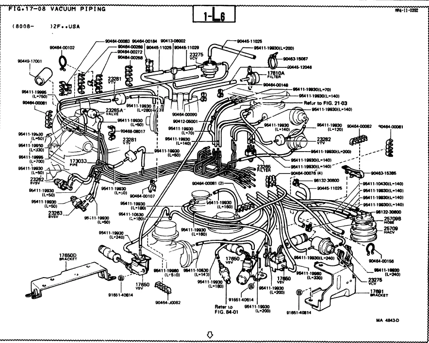

regarding the toyota parts numbering, back in the day, Toyota offered three different lengths and you purchased the size(s) you needed and cut it to the specific length: 300mm, 600mm and 950mm. you would buy the shortest length that would fit and cut it to the correct length. These old numbers are now superseded and maybe they don't cross reference back to the 1980's vehicles.
But I did search for the 950 mm (95411-19995) and it did supersede to the part number the OP listed. As far as I know, Toyota doesn't sell "by the foot", but you purchase the pieces--as many as you need. It's probably cheaper to get stuff off the roll.
