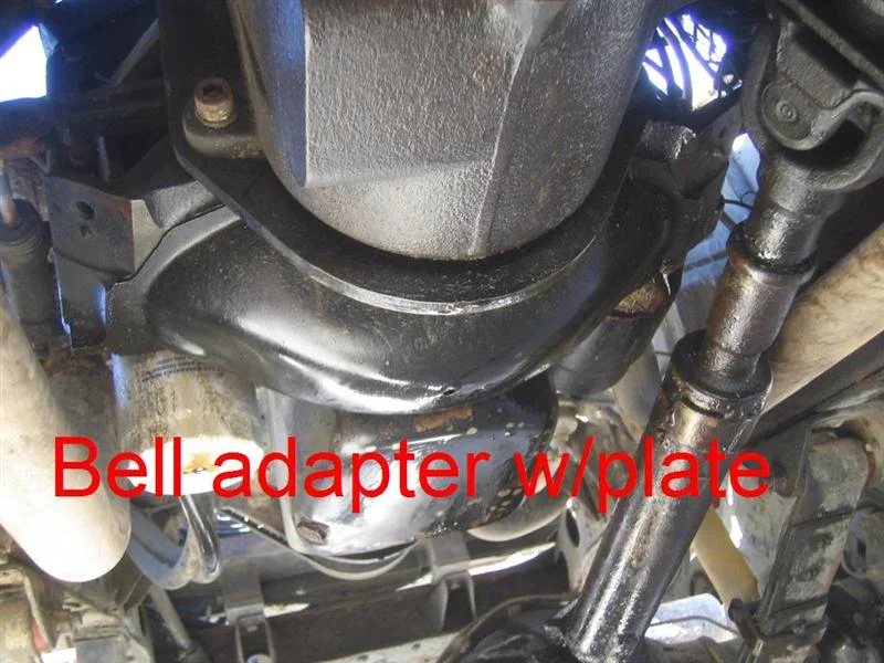

Can anyone tell me what application that flywheel cover is for. I need one for my FJ40 with a 350 and I haven't had any luck yet. I have the same adapter plate as shown with the chevy bell housing.
attachment.php
funny,you got me searching , i've been looking for info on the bellhousing adapter , i also have a old
4sp plate adapter lying around the shop , like the one in the pick , i have the bottom cover , didn't think it was anything special , and accidentally stepped on it last year , , i may have chucked it , OOPS ! , that one on ebay is not quite the same as the cover i had , but may work ??? years seem to match the years for the bellhousing should work ??
Yep, it is a early chevy/gmc bellhousing similiar bells used both in trucks and cars of the same era.
the orange one is a harder bell to get ahold of, as it appears to have the threaded boss on the driverside for a clutch pivot.
I have to look but i tossed out at least 5 of these a few months back, i have more not sure on the cover condtions though.
