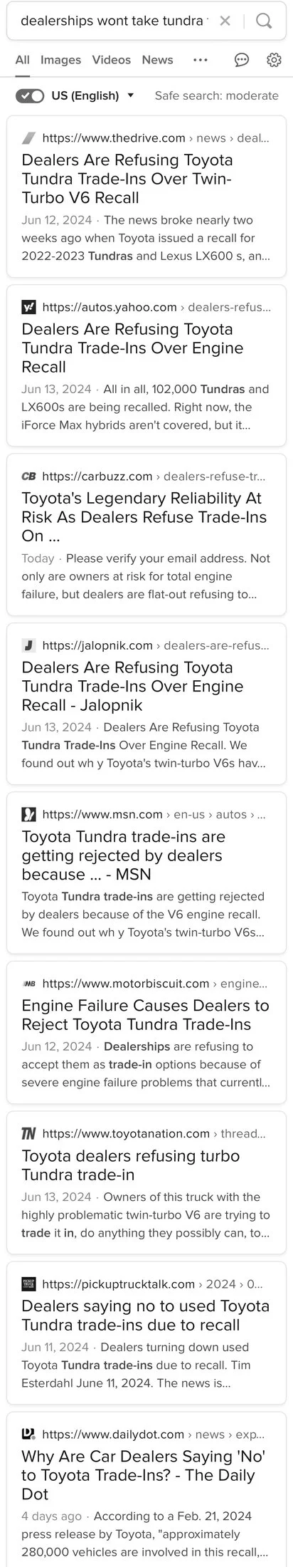

So I wonder how many of these articles are referencing the exact same story.....
Exactly. Probably two dealerships didn’t want to get involved with ‘22-‘23 Tundras and refused to do a trade in. And one or two people took social media — then BLAMMO! Headlines around the world all referencing two Reddit posts (or each other) Ha!
(most likely).
If there’s one thing we know, it’s that the internet is primarily an echo chamber.

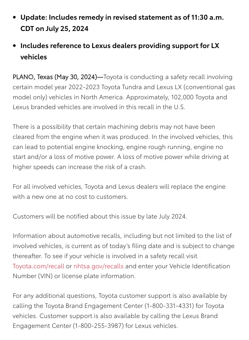

Interesting update today to the recall press release:
"For all involved vehicles, Toyota and Lexus dealers will replace the engine with a new one at no cost to customers."
Where did you see the updated remedy listed? If I'm reading that right, every one of these 102,000 Tundra/LX rigs is getting a new motor? Probably the right move if so but $$$$$$ to implement!

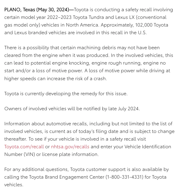

It's buried on their website and they seem to have only updated the PDF that was originally linked and not provided a new article or press release.
OLD:
NEW:
