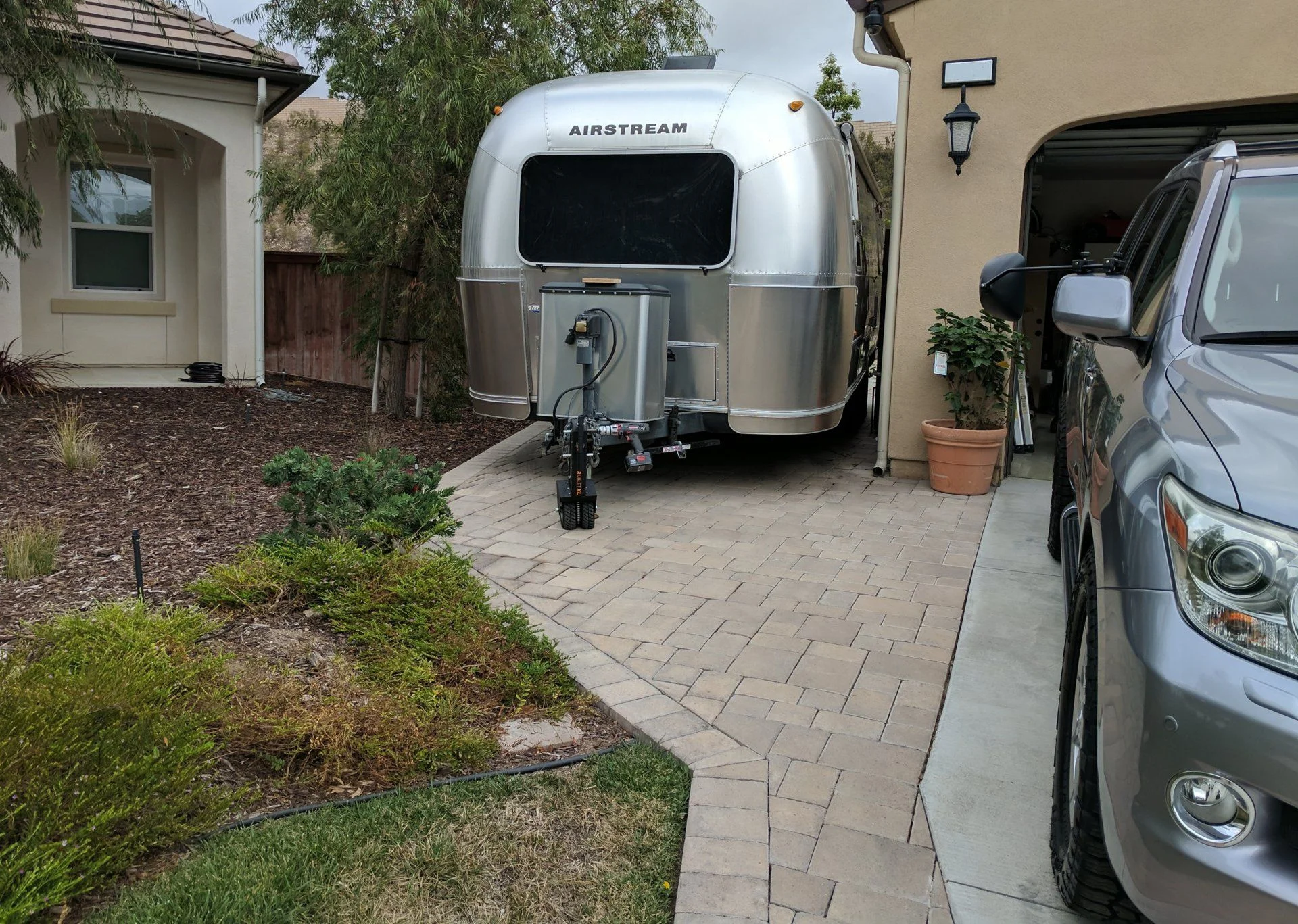

I'm on a cul-de-sac so the front yard is narrow, but widens as it goes back. So I don't have a straight shot in. You can't see the driveway gate in this pic but it's at the tail of the trailer as it's being backed in here. The Trailer Valey XL can make very sharp turns with the trailer, but it the trailer will load up a bit cause of the tandem axles. Still very doable. It'll handle some off turf stuff too without issue. Just not great for any real inclines, so I backup the trailer up the driveway and into the more level paver pad, before switching to the dolly.

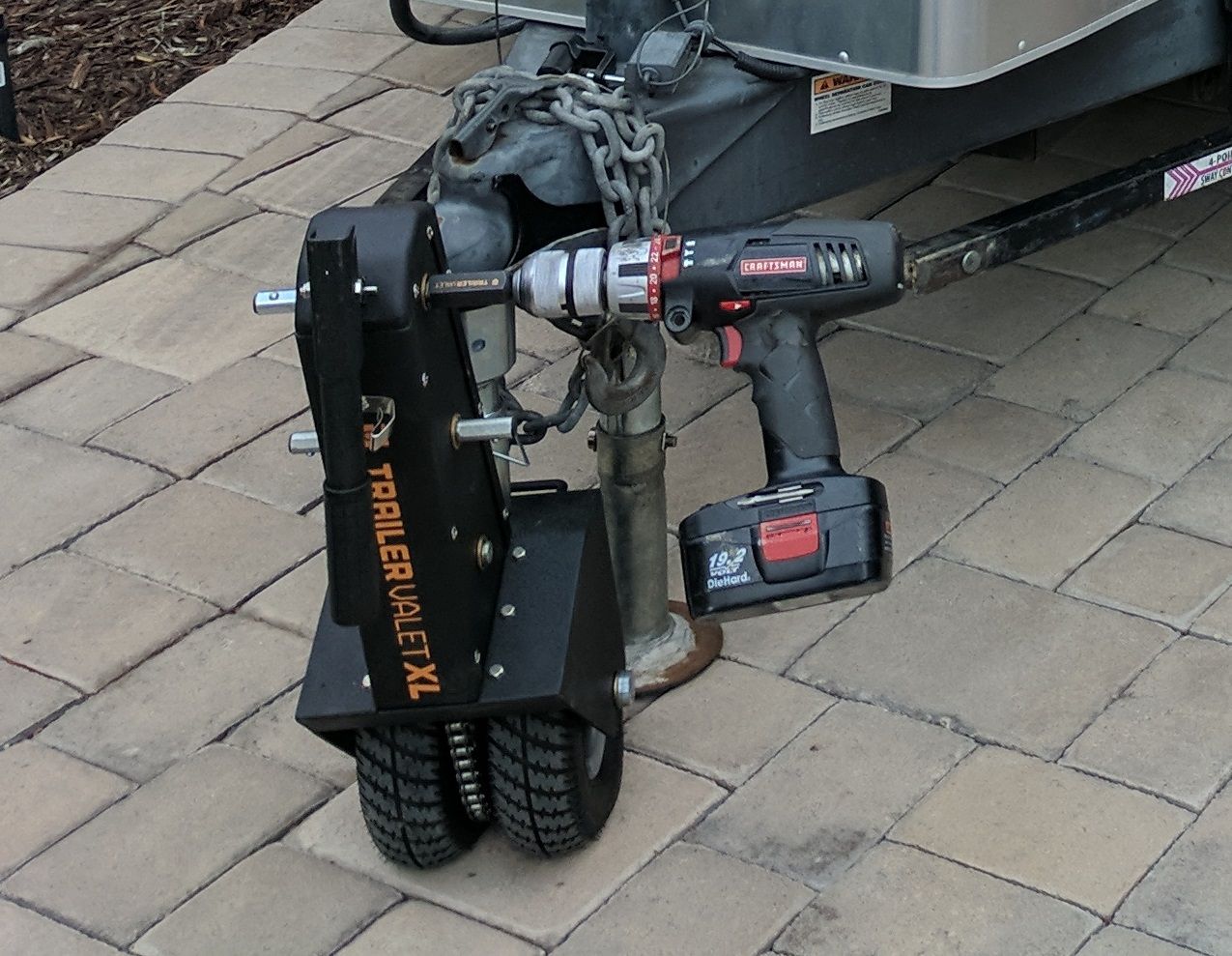

The Trailer Valey XL is very compact! It is barely taller than the typical hitch height of a trailer. I could easily carry it in my trailer, but I only use it at home, which means I store it in the garage. There's no installation to be done. It adapts to the trailer via the ball coupler and a proprietary collar that snugs everything up. Once I get my trailer in place, I take it off and stow it away.
This pic might help. Drill for scale.

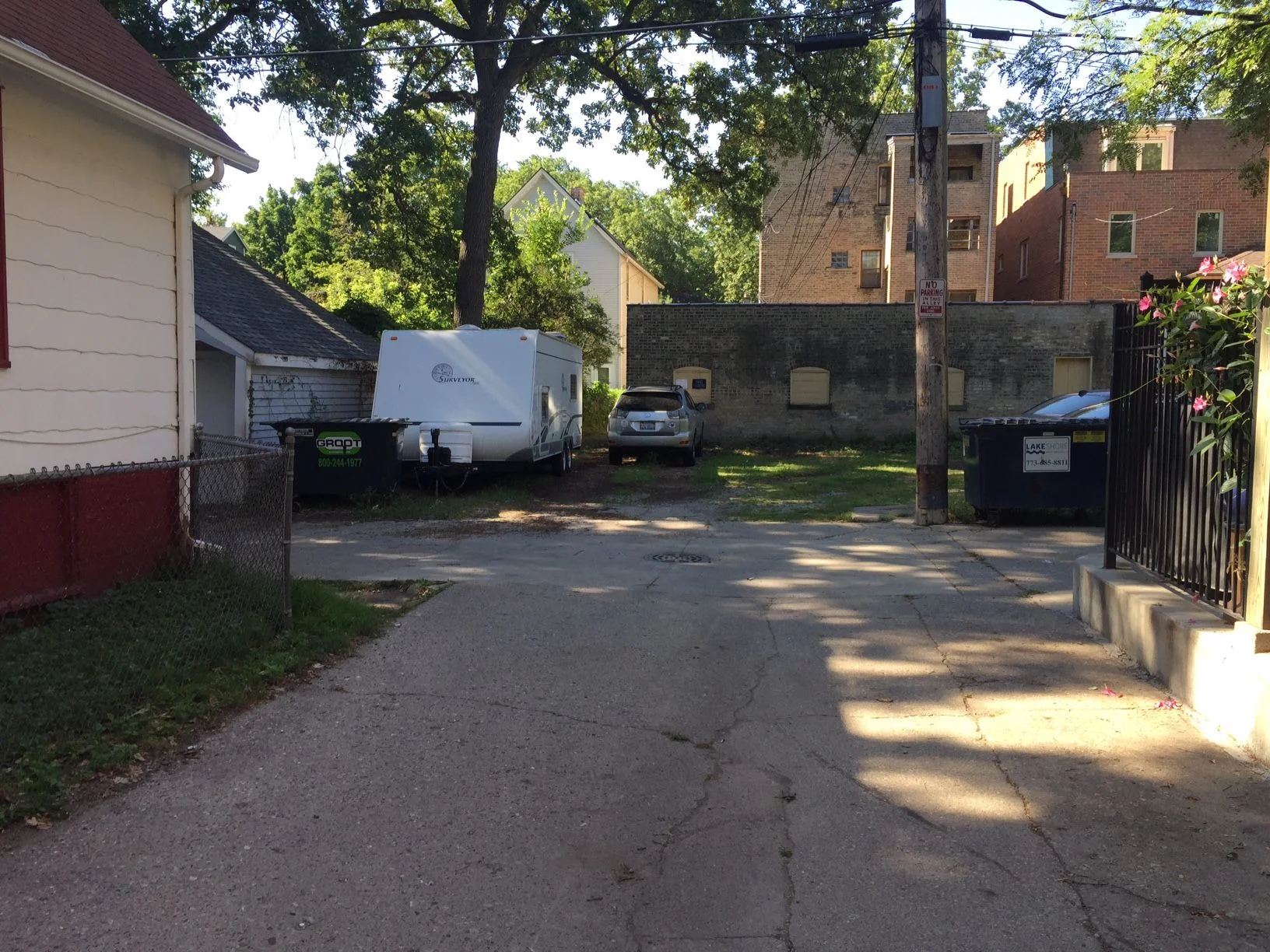

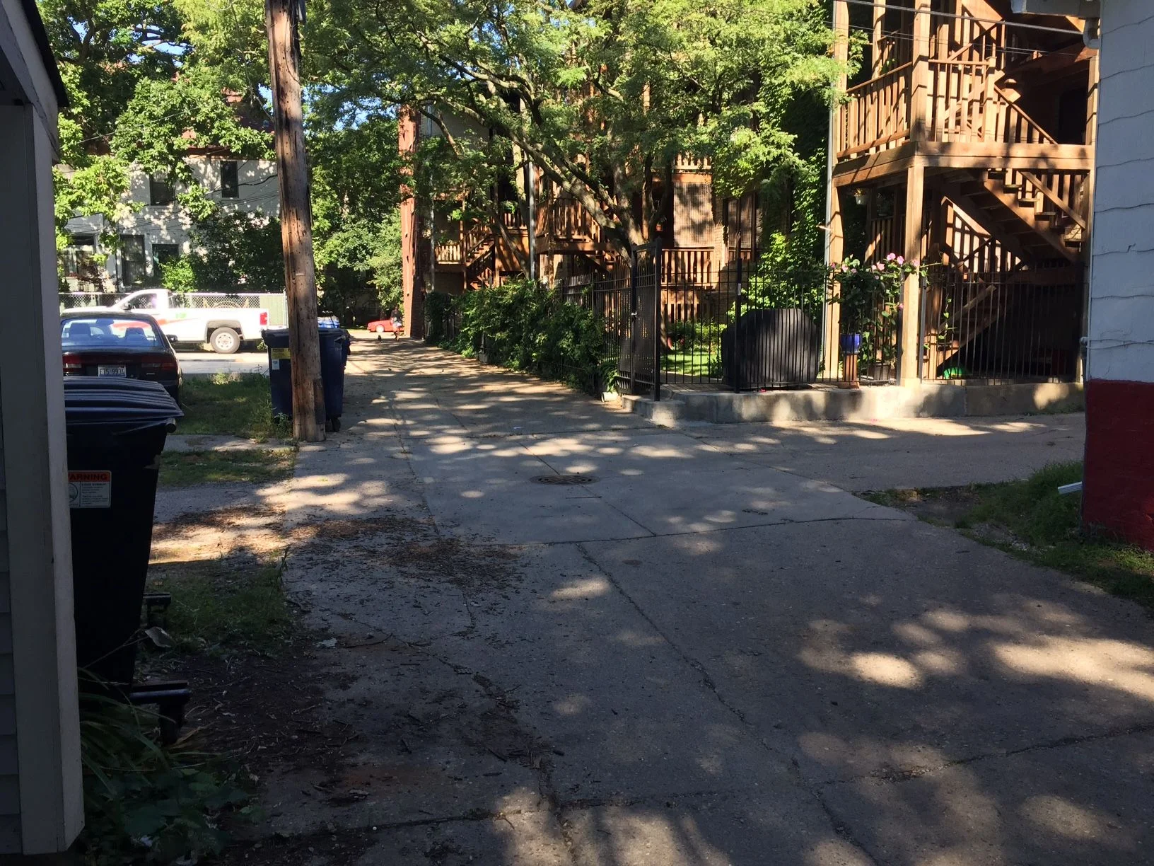

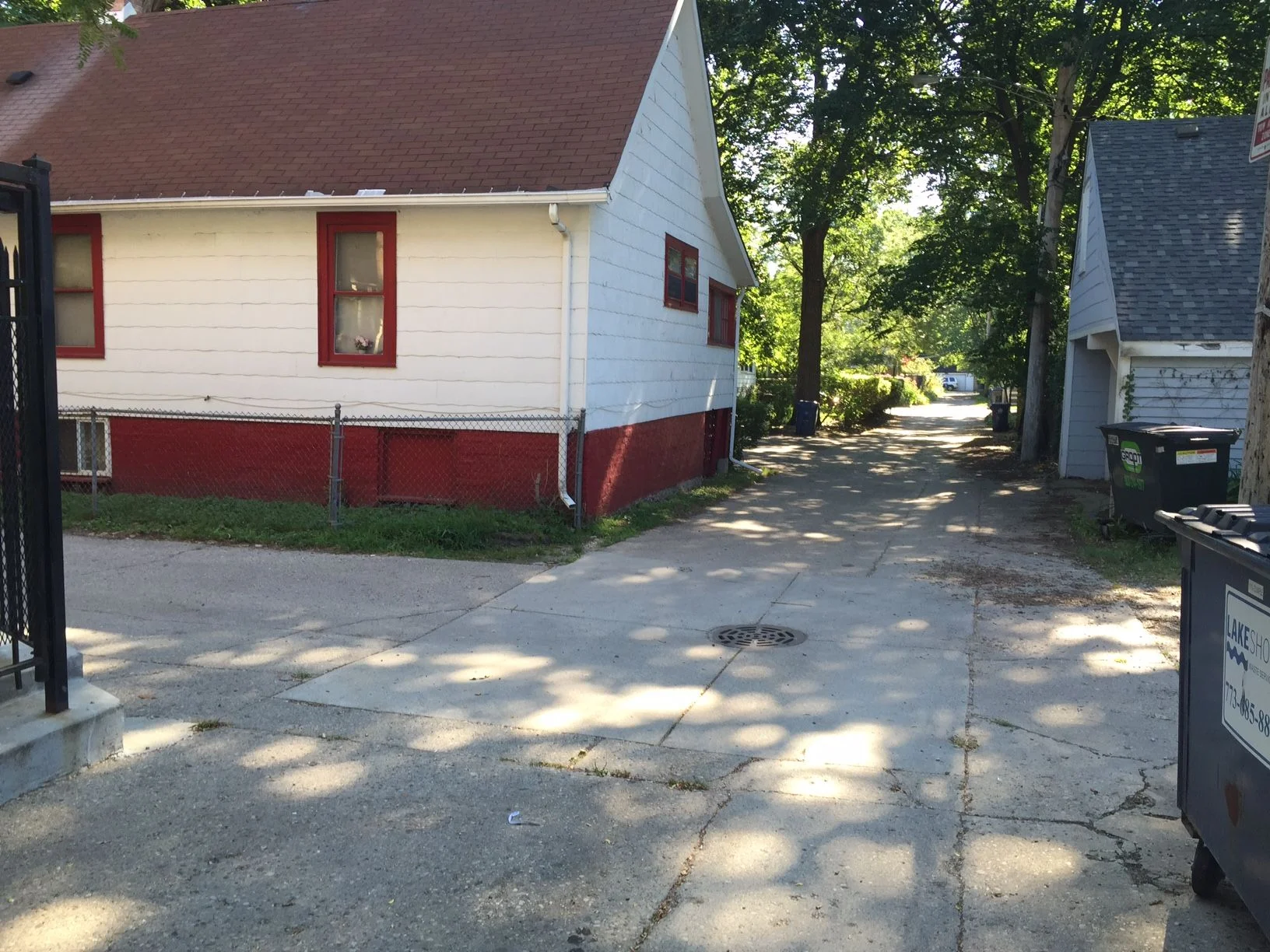

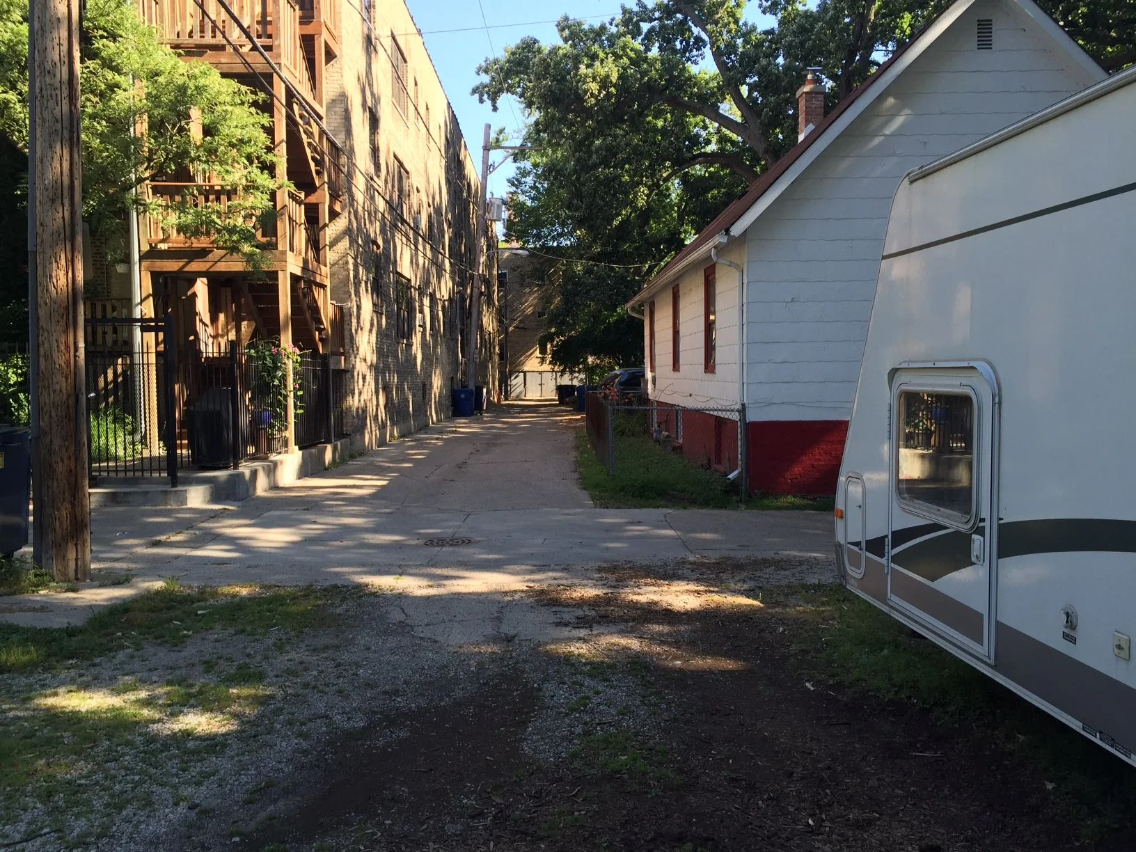

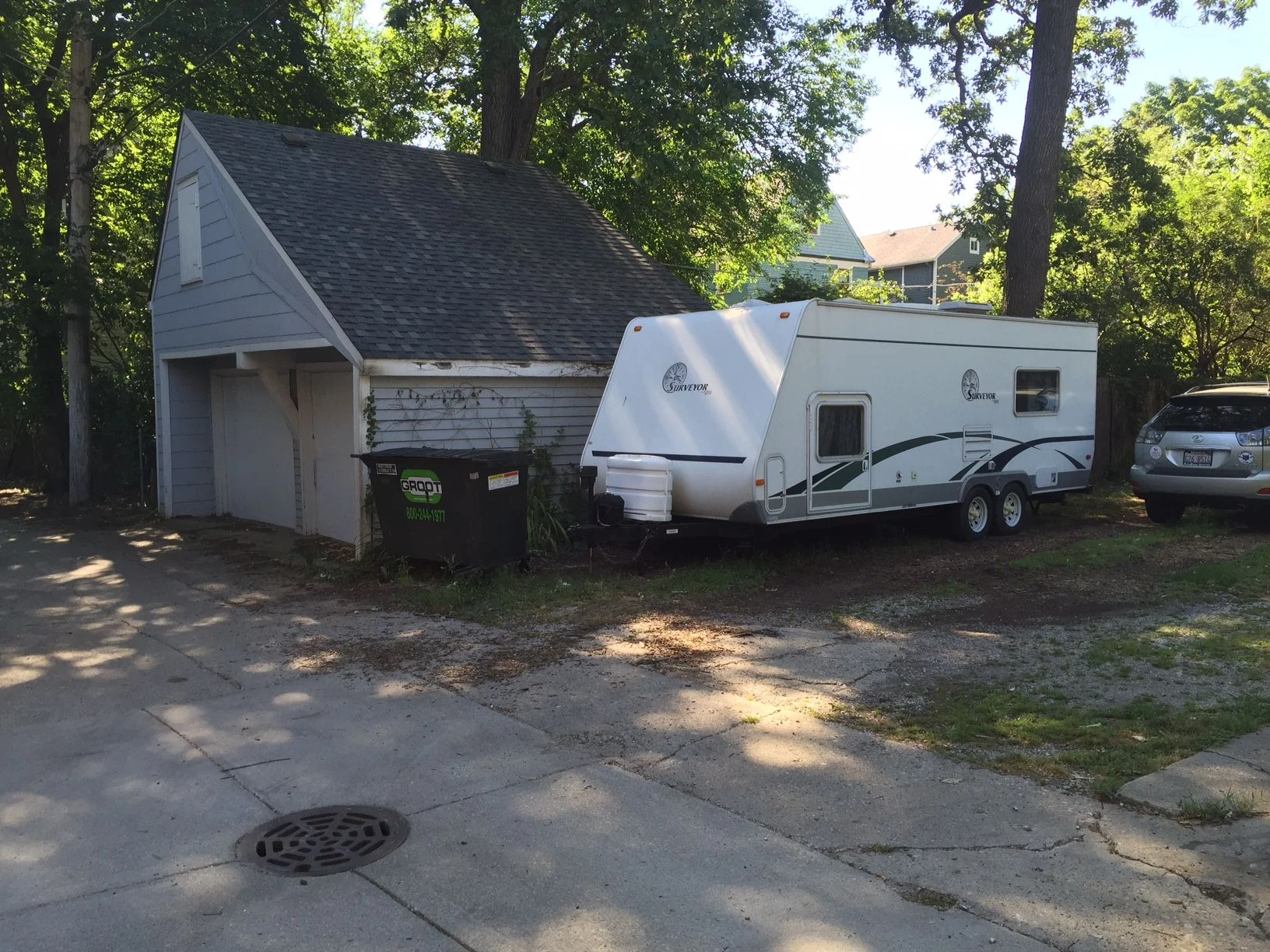

Yeah here's a few photos I took of the spot a couple years ago.
Garage I'm parked next to. I have to roll the dumpster out of the way when parking, then put it back when I'm done.
View going east-to-west as I approach the intersection. You can see the dirt on the right that the trailer rolls over.
Facing north. Straight ahead is where I pull (#2 in the first post) before backing into the final spot.
Looking south. This is my reverse view
