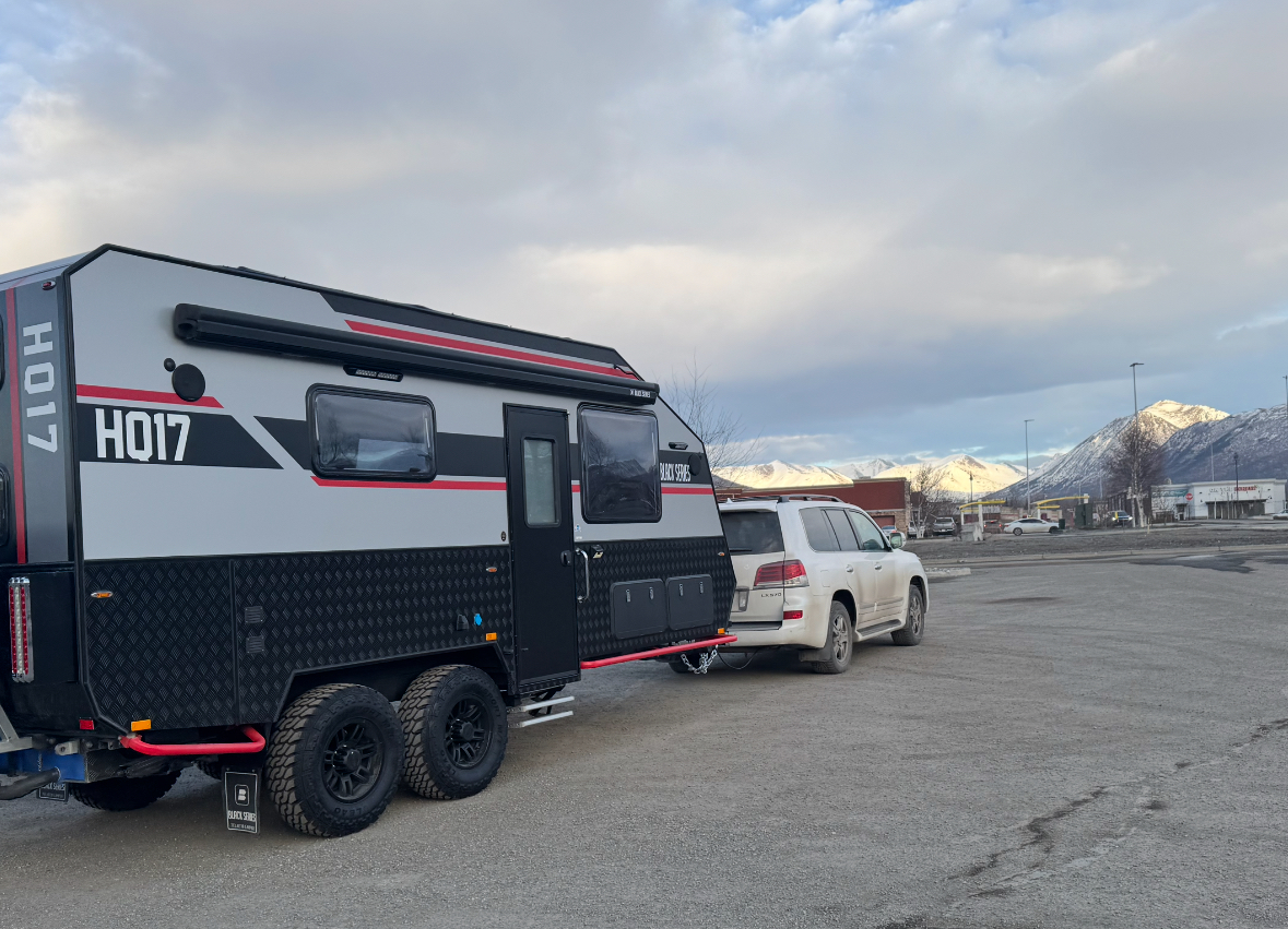

@TeCKis300 revisiting this issue after a while. It's still happening, though it resolved faster when I used a hitch with less drop. Now it's time to talk about spacers, especially because I might be upgrading to a bigger camper.
I have two OME 10mm spacers on order from Cruiser Outfitters. I was planning on putting one spacer on the RL coil spring to give AHC a little help and level the rig, however a local friend and Mud Mechanic has a ~32mm spacer in his shop.
Level-wise, I think I'd be good with one 10mm spacer on the RL spring, however what do you think about stacking both OME spacers to add 20mm of height to the RR spring and the ~32mm spacer on the RL spring? This would give the desired ~10mm boost to the RL spring, and an added 20mm of spring support on both sides, hopefully nipping this towing issue in the bud.
My goal here is not a lift, just some support to help AHC get back to normal under load. Thoughts?

Funny you mention this. I’m strongly considering airbags for my LX. I have a buddy that left AK and needed to liquidate, last week I ended up with a 2nd camper, one that had an articulating hitch and no way to really do a WD.
To the OP my Ahc lifted this one just fine and the TW is 700-800 lbs.
