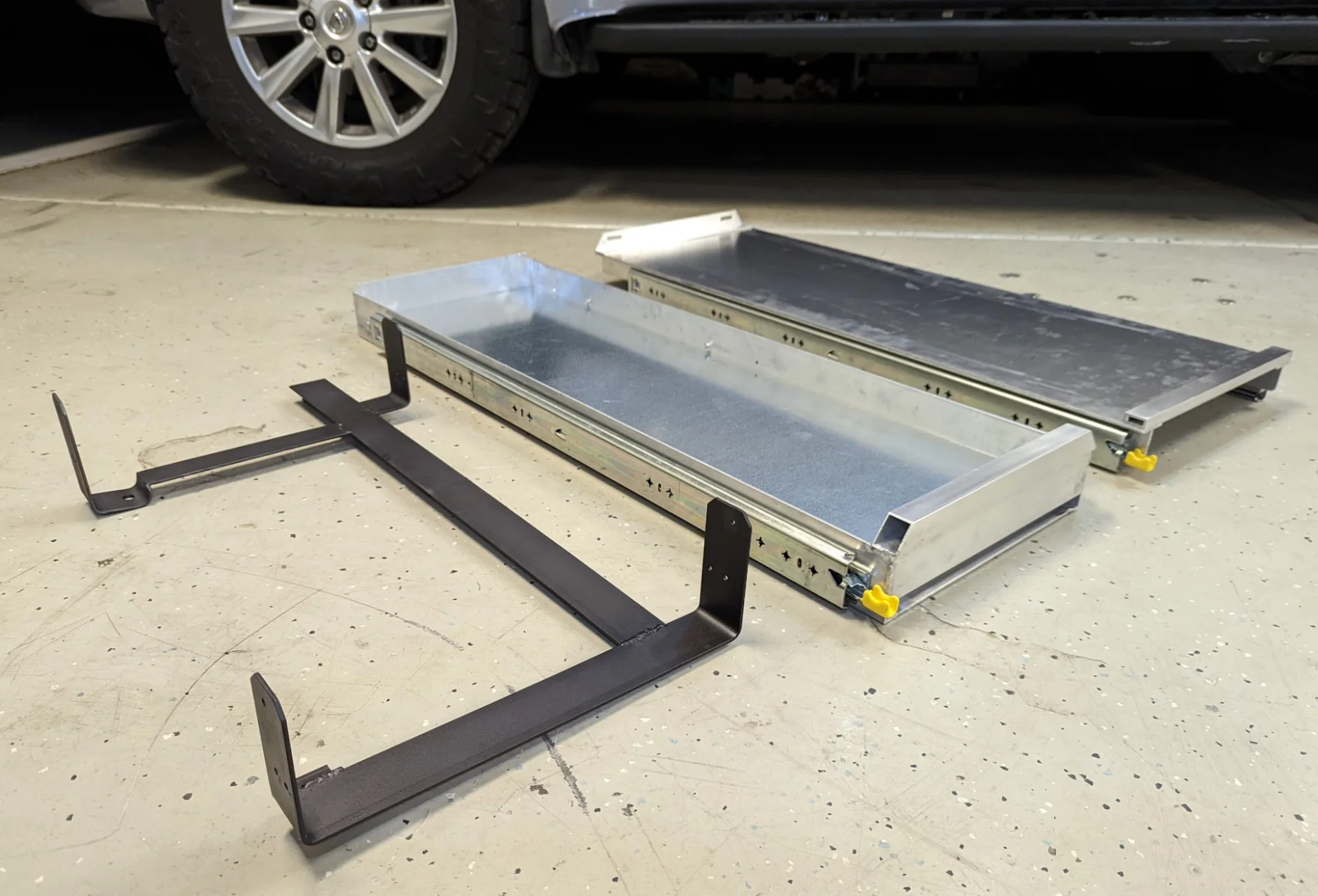

I've resisted going down the cargo drawer path. Recently removed half the 3rd row to gain additional space. Trying to downsize, simplify, and organize better. Maximize functionality with a slide out drawer, slide out fridge, and slide out table. In as minimal space and weight as possible.

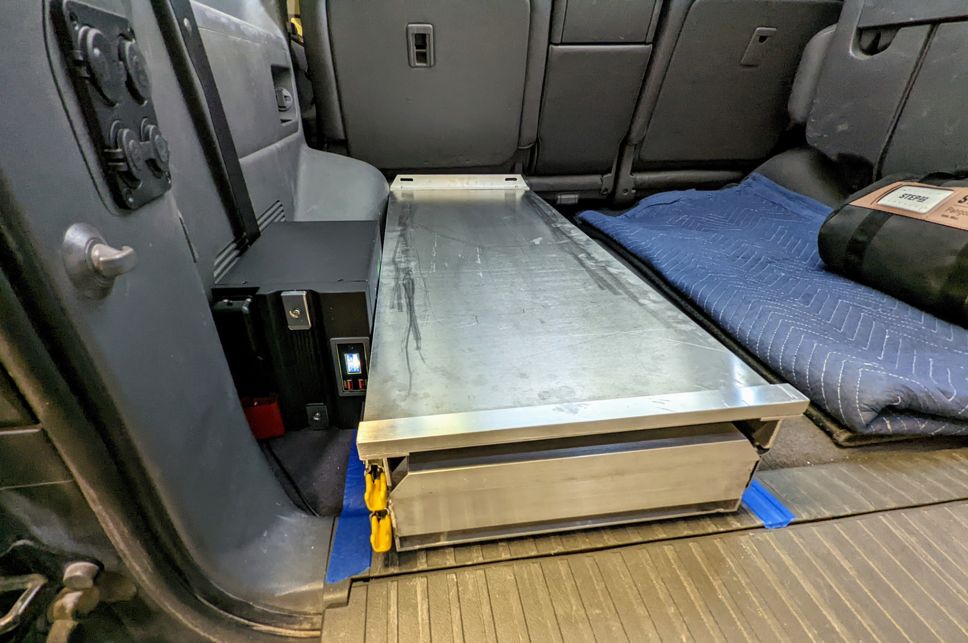

Sneak peak of finished project:
Goals of the drawer
  1. Better gear management around the camping fridge. Stacking things on top of fridge isn't ideal, so harvest space below. Also would like it reachable when underway and when camping.

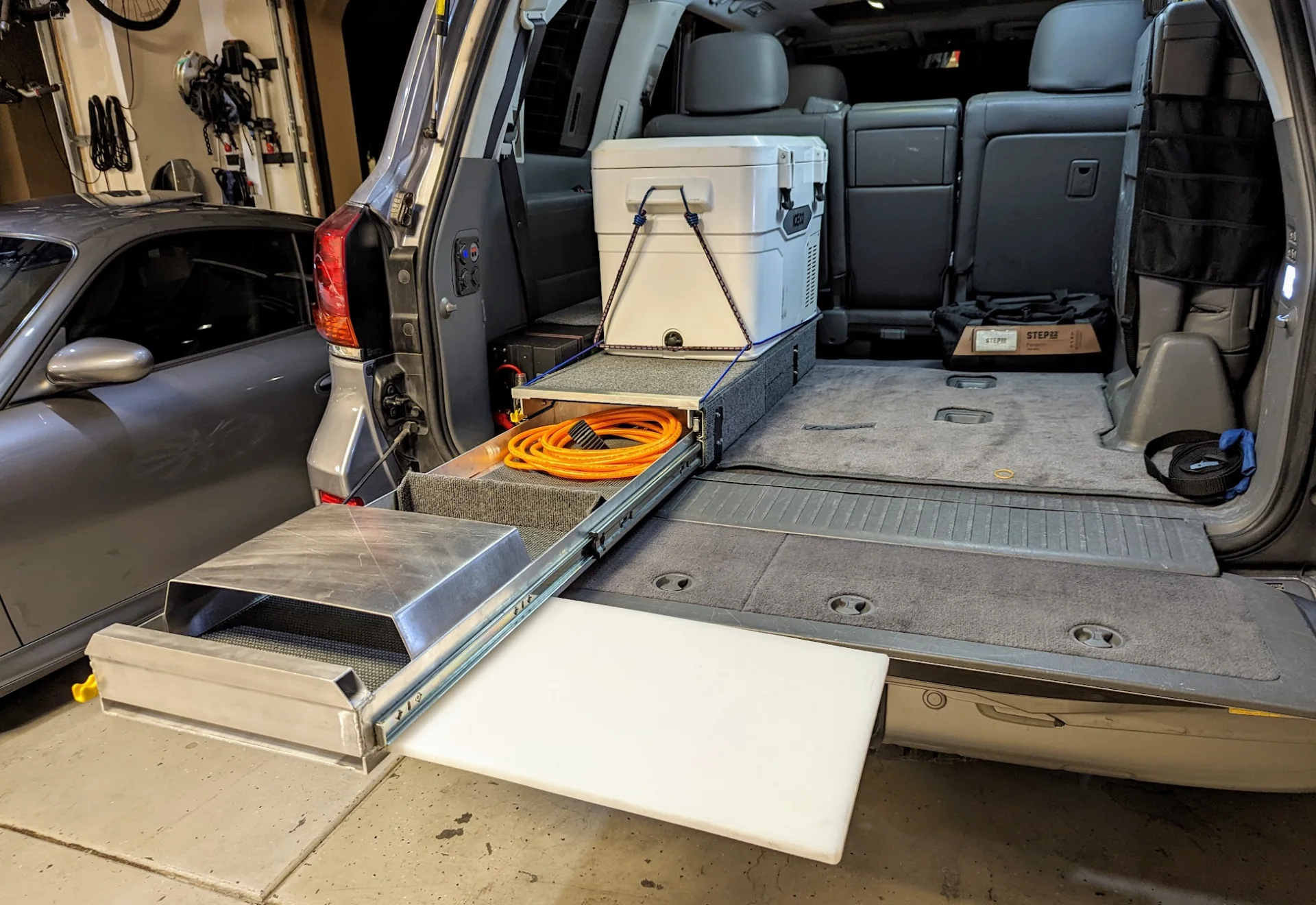

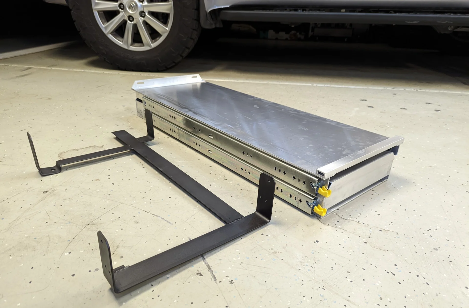

  2. Slide out drawer, slide out fridge tray, slide out table
  3. Light weight and maximize space utilization
  4. Easy removal

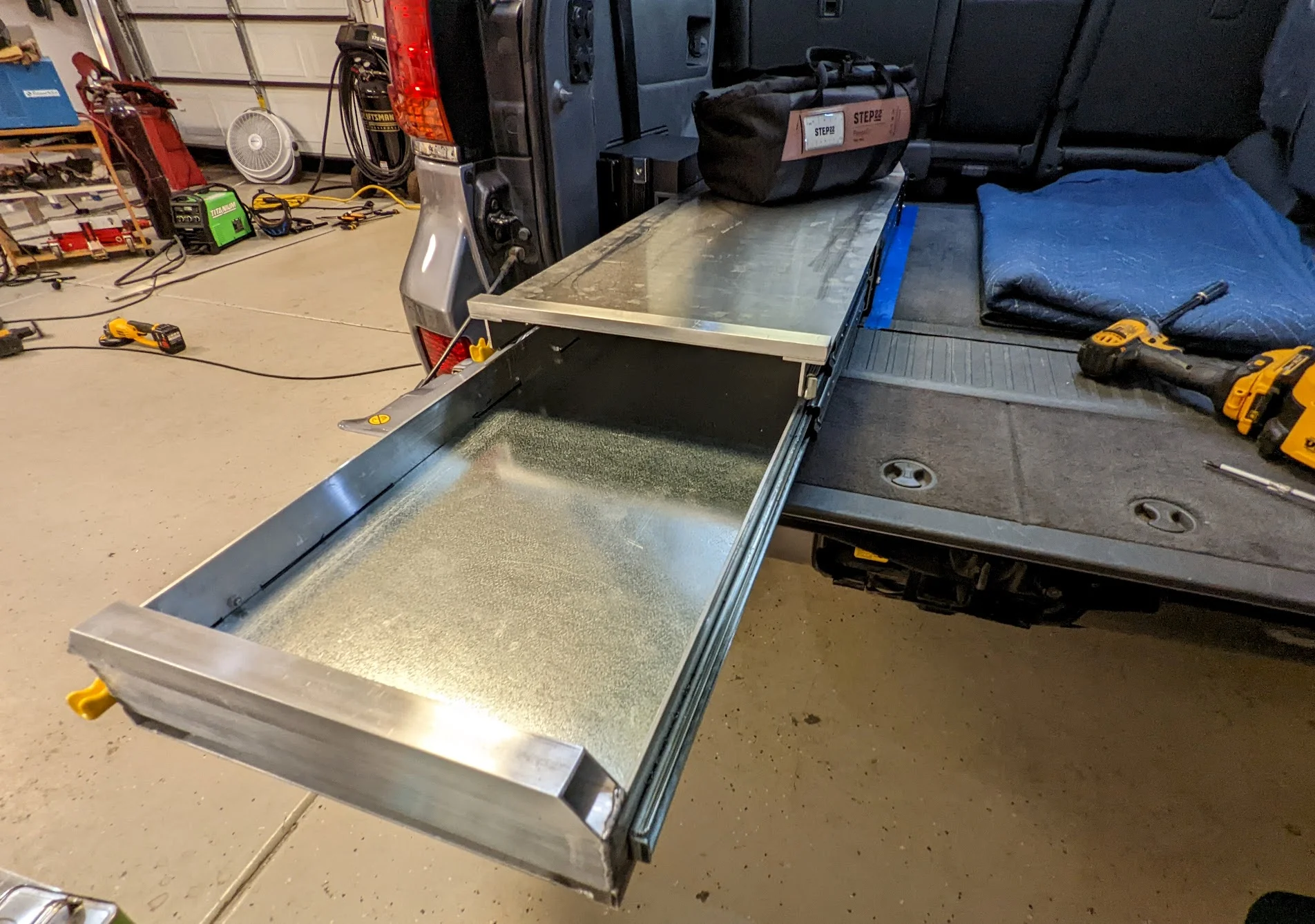

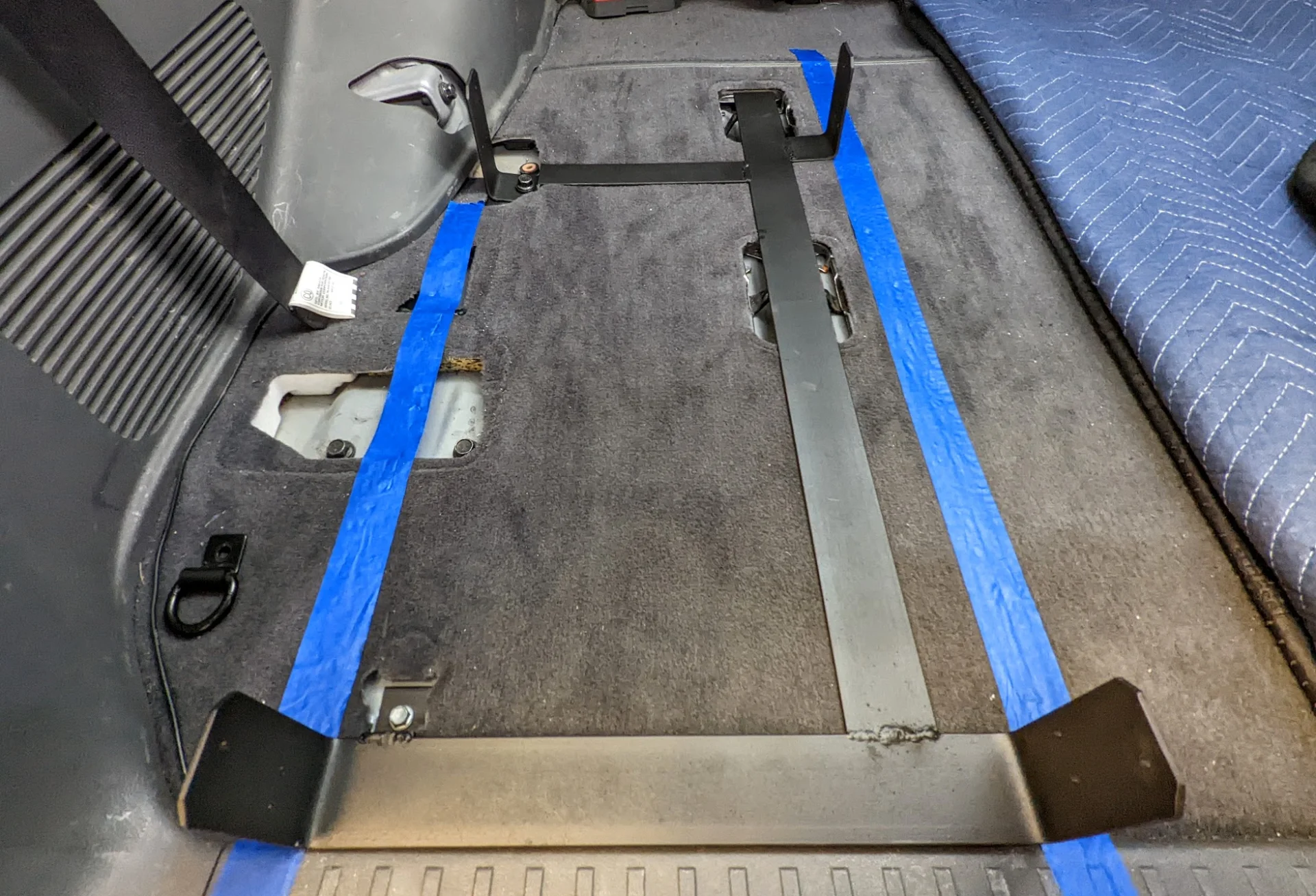

Construction is welded aluminum extrusions. Frame bracket is steel, contoured to the floor to minimize lost space to structure. Not completely done and still need a couple more finishing details with carpet, tie downs, and table slide, but it's functionally there.

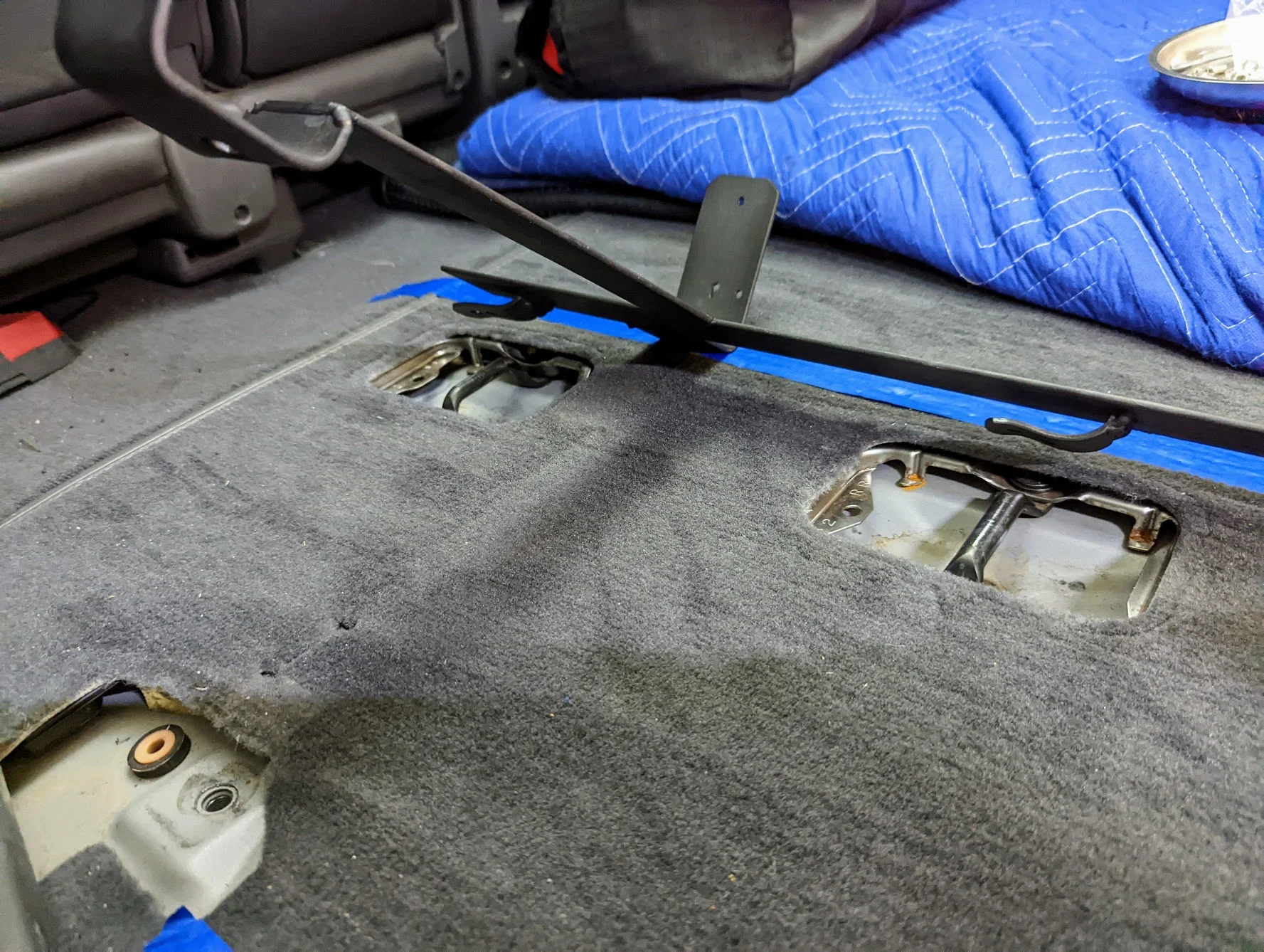

Bracket slides on the seat brackets and uses two existing bolts. Whole drawer and bracket can come out in a few minutes.

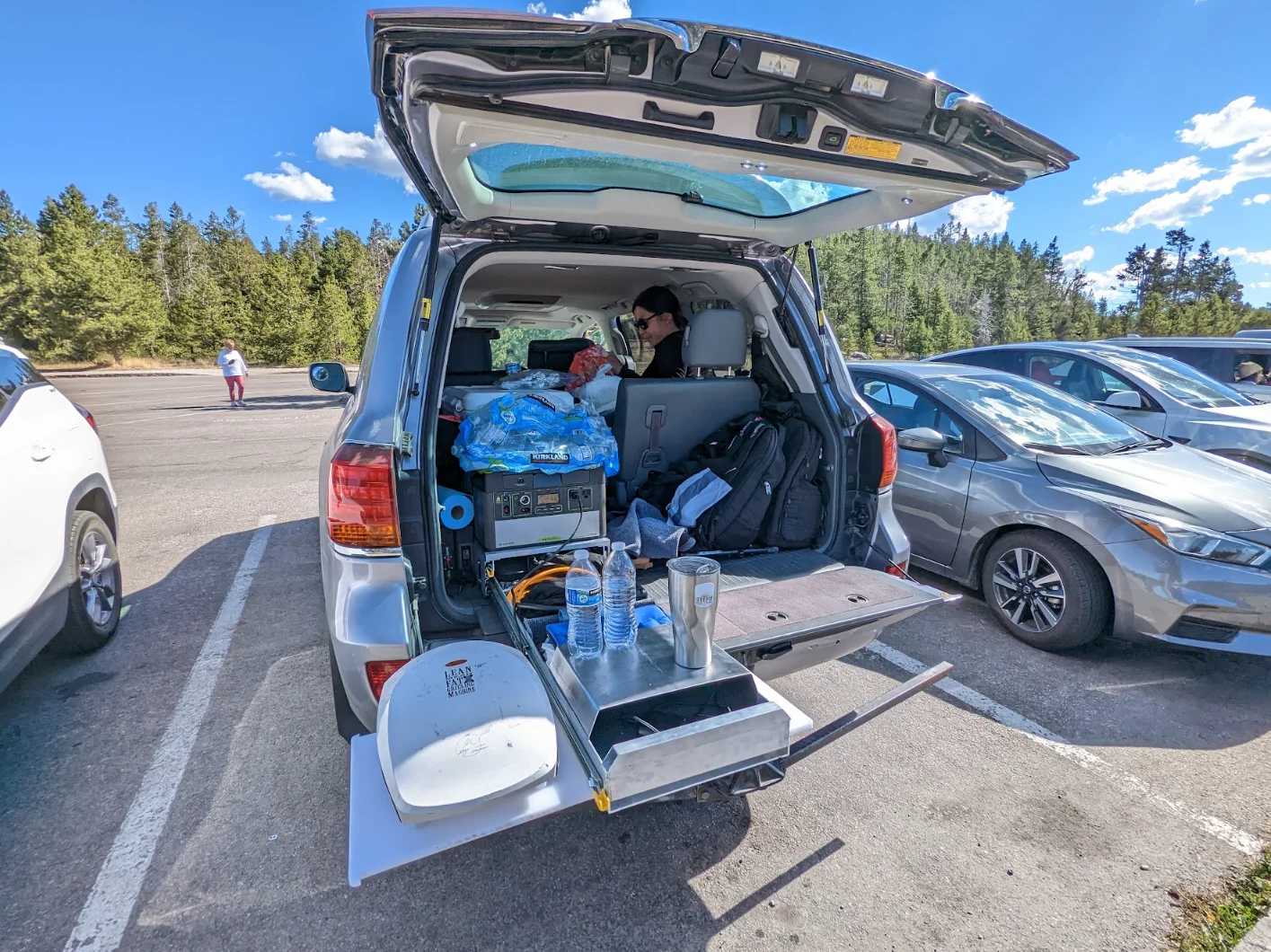

Fridge can be reached from second and third row passengers while underway.

Slide out table can be oriented in several ways

Don't have much of a parts list as I used mostly leftover material and aluminum extrusions I have around the garage. Lots of 2.5" angle, 2" T-section, and some bar stock.
Here's the slides I used
Amazon product ASIN B08YY839QC

Worth considering depending on how your setup sorts out. Including the height (lift) of the overall vehicle. Ergonomics and usability was important to keep the fridge height in easy reach, both while underway from the interior and at camp. AHC helps a ton to drop that height down 2" at camp. I originally wanted the slide to be the same height as the battery deck, but compromised to keep it reachable. To you question, a fridge drop down maybe part of the solution but that adds size, weight, and complexity to the trades.

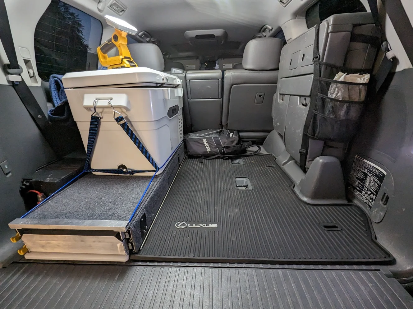

It's been working out well and I like the flexibility. Pulling the fridge out still makes for a cavernous space to haul stuff. Depending on trip, I'll also reverse the fridge to be closer to the tailgate.

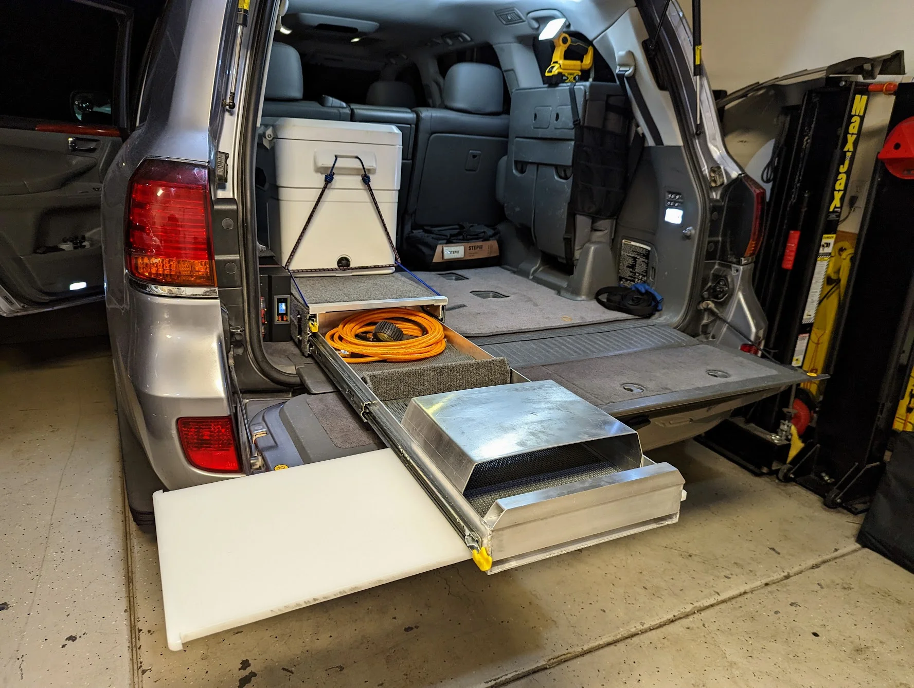

A couple more pics.
