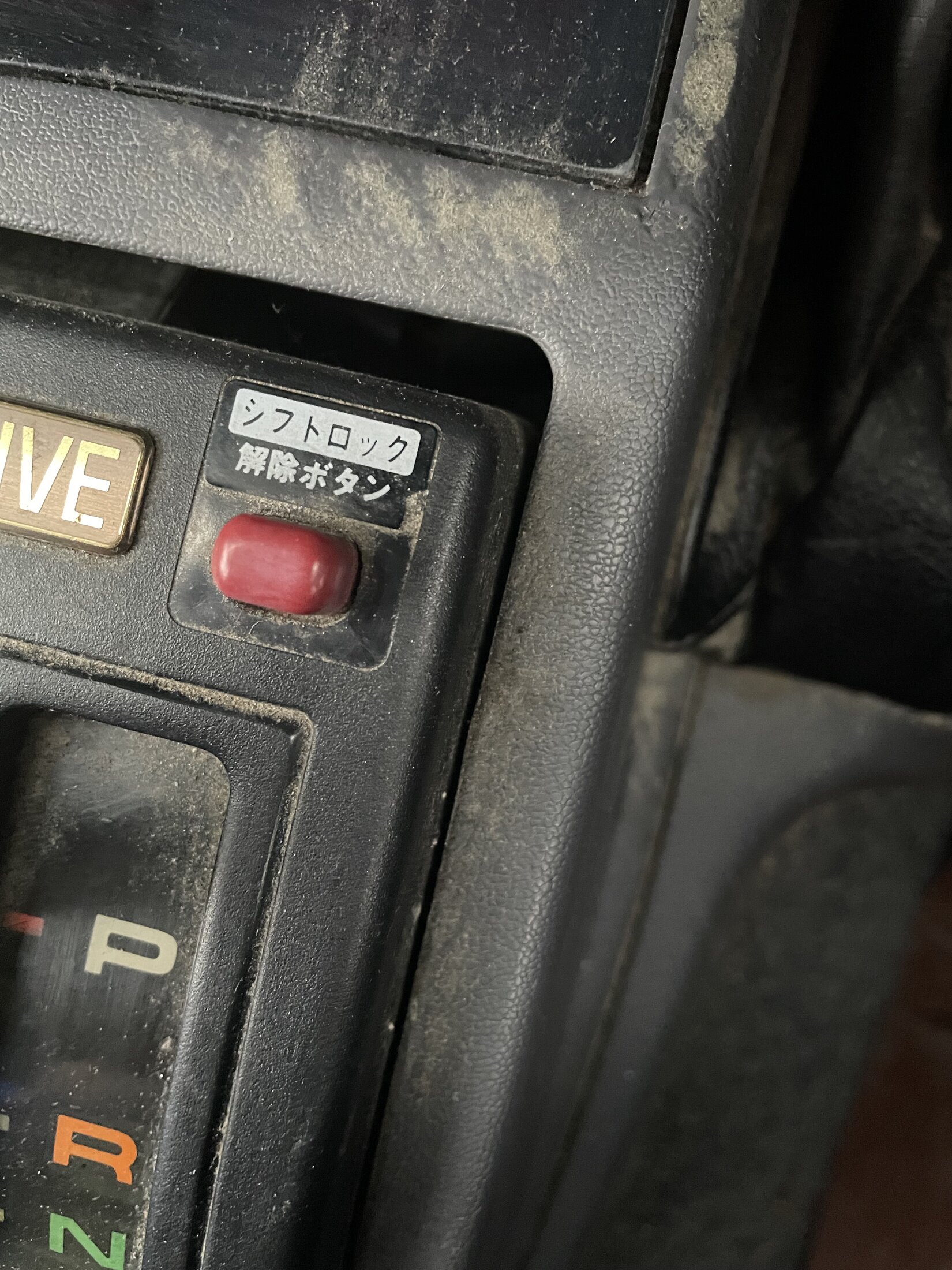

Press the red button on the shift console.
