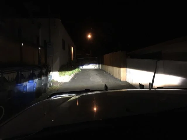

I fit some h1 bixenon projectors with hid kit for under 100 in parts. Great light output and cutoff. Kits available on eBay.
Now that is some light! Perfect! More info please? What kit did you use? Was it difficult?

Ordered some Morimoto Mini H1 6.0 HID/Bi-Xenon Projectors with Mini Gatling Gun Shrouds. Hopefully they work as well as what billygoats posted, if so I'm going to be a happy camper. More info once I get them and install.

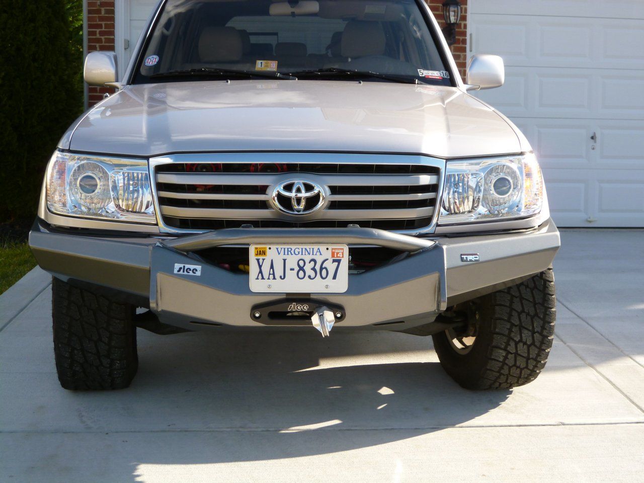

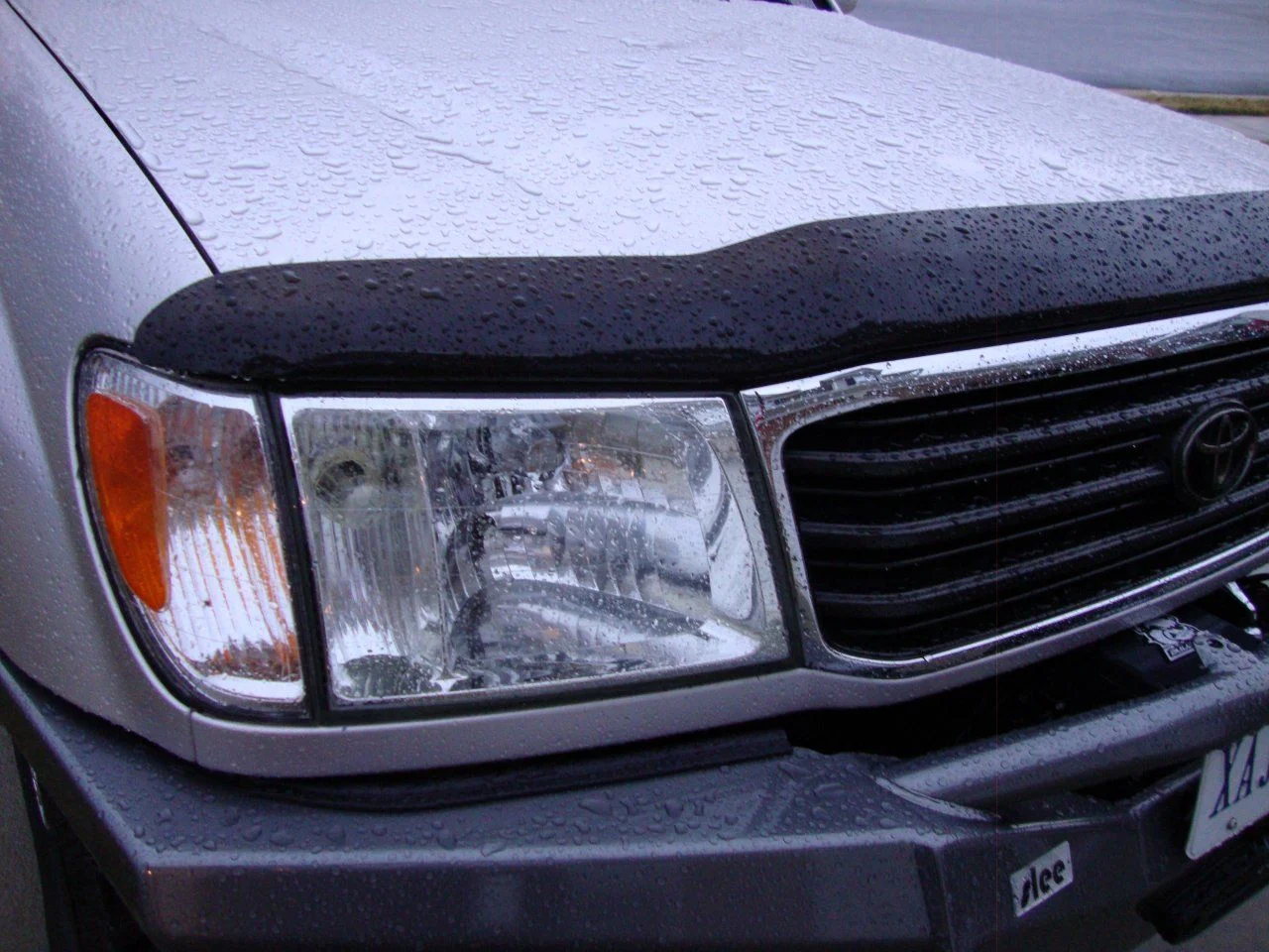

I did the depo 06+ lense and new grill/valance panel fender trim project, and then fitted morimoto 35w HID projector. Fantastic light output and good cutoffs. A fellow mudder had previously done a great job on the writeup so if you can muster up some search mojo and look for the thread, you will find all of the detail necessary to inform a decision on going that route. Before and after on my '99.
