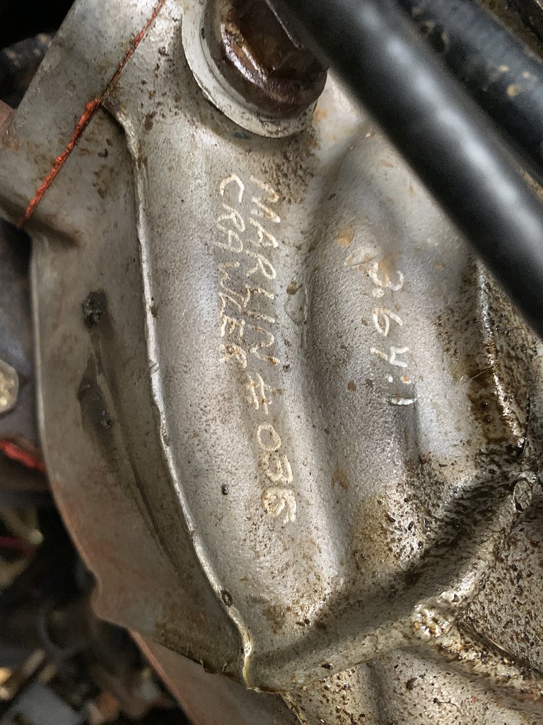

@65swb45 yes sir it appears so... Just pulled the receipts (guy kept tons of them) and took a pic of the case and the work order (below). When you say "pull it" - can it be fixed or is it now a boat anchor? Thanks!!!

I think what he means is pull it and figure out what's wrong with it before you experience a catastrophic failure and blow up the (now unavailable) gears since that's a pretty sweet setup. On my way to taking it apart I'd drain it, pop the rear staked nut, pull the drum off the brake, and see if anything is rubbing. If it's fully disengaged and something is still dragging then you know the issue is inside.
It is my understanding that ALL of those cases failed. Something about the heat treating of the gears. :(

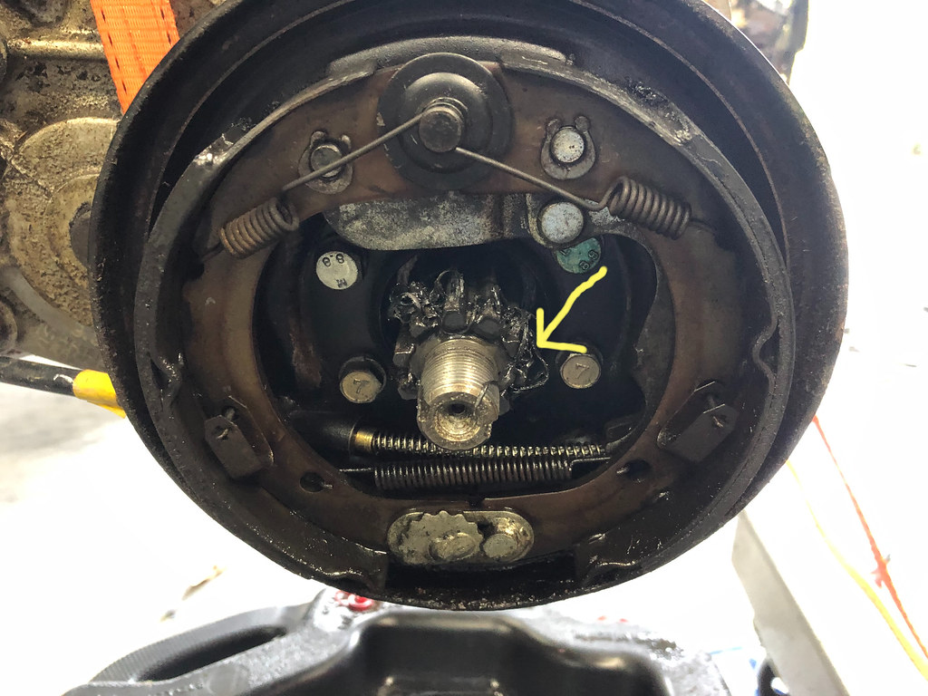

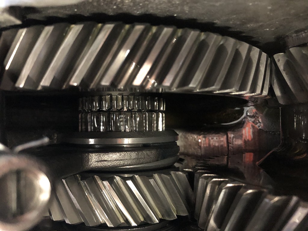

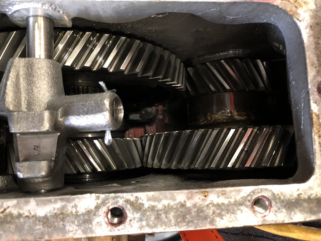

Well I finally dropped the trans and xfer case in anticipation of a replacement arriving at end of month. After draining 90w (which was crystal clear in both trans and xfer - no shavings on plugs or anything), pulled the nut on the ebrake drum and pulled the drum off - found some string like substance on the shaft but nothing else. Much to my surprise, remounted the brake drum and she turns like silk forwards and backwards! Anybody got any theories as to what's up? More importantly, was it maybe the e-brake (which was unhooked from the lever BTW) somehow binding up when rotating in the forward direction? Sure would like to keep the Marlin gears if they're not trashed. Pics and vids below:

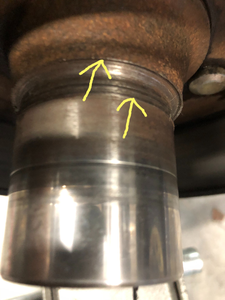

These edges were sharp to the touch:

Gears in motion forward and backward:

Not sure if it is the problem, but check out this thread. It looks like you might have some wear...that groove with the sharp edges shouldn’t exist, I don’t think.
