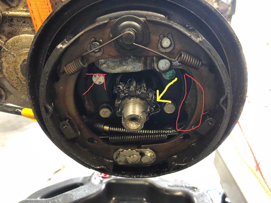

UPDATED - T case issue - still need help: clunk clunk at slow speed?
Not sure if it is the problem, but check out this thread. It looks like you might have some wear...that groove with the sharp edges shouldn’t exist, I don’t think.
Thanks Curtice - I checked that thread and my lever is no where near the hub spindle (see red circle). The arm marked with red arrow seems potentially closer but does not appear adjustable:
Untitled by jeff elliott, on Flickr
