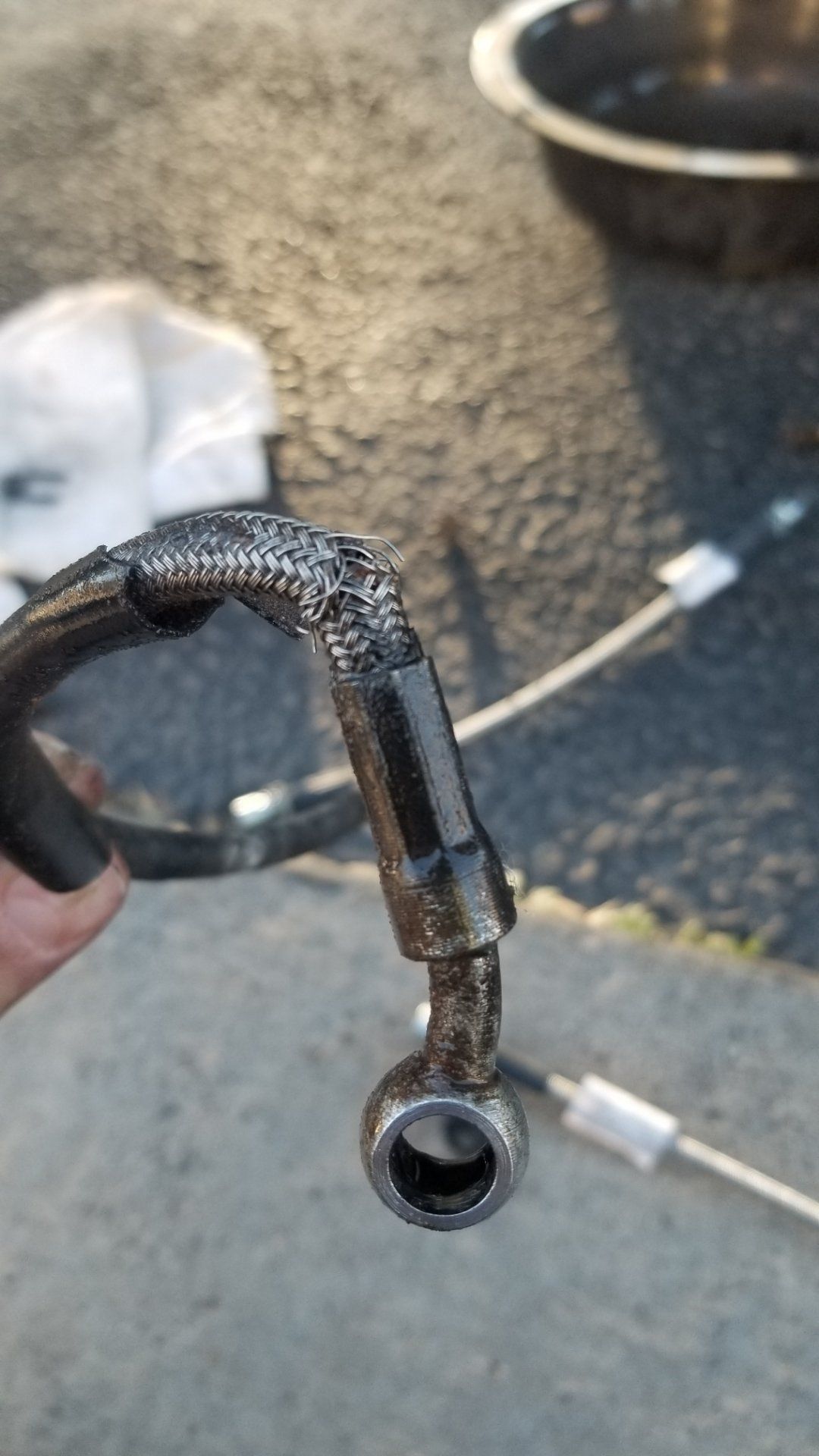

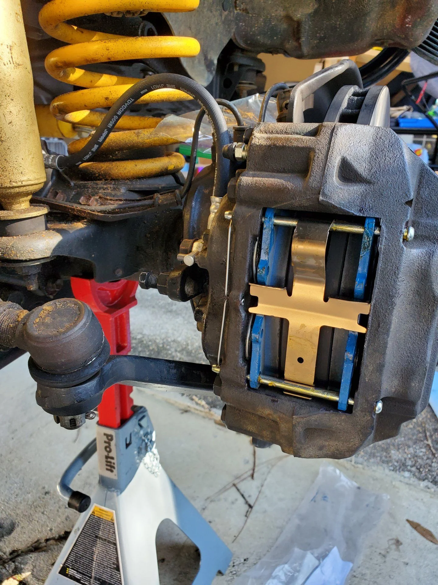

*Update: I got this blown brake line off and I think that it was routed wrong. I am ready to install the new ones but I was wondering if anyone could post a quick picture of the proper routing for the front passenger caliper to axle brake lines?

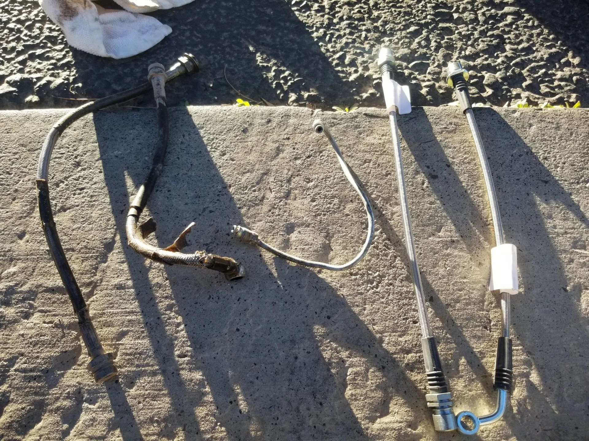

I am pretty sure the only reason this stainless brake line failed was due to improper routing.
This is the orientation that mine were in when I replaced them. I don't know about aftermarket but the OEM lines are kind of hard to screw up because they only really fit one way.
Thanks, I finally figured out that the existing hardline was not oem lol, it was about 4 times to long. I got the correct oem line and it was very easy to figure out the routing at that point.
