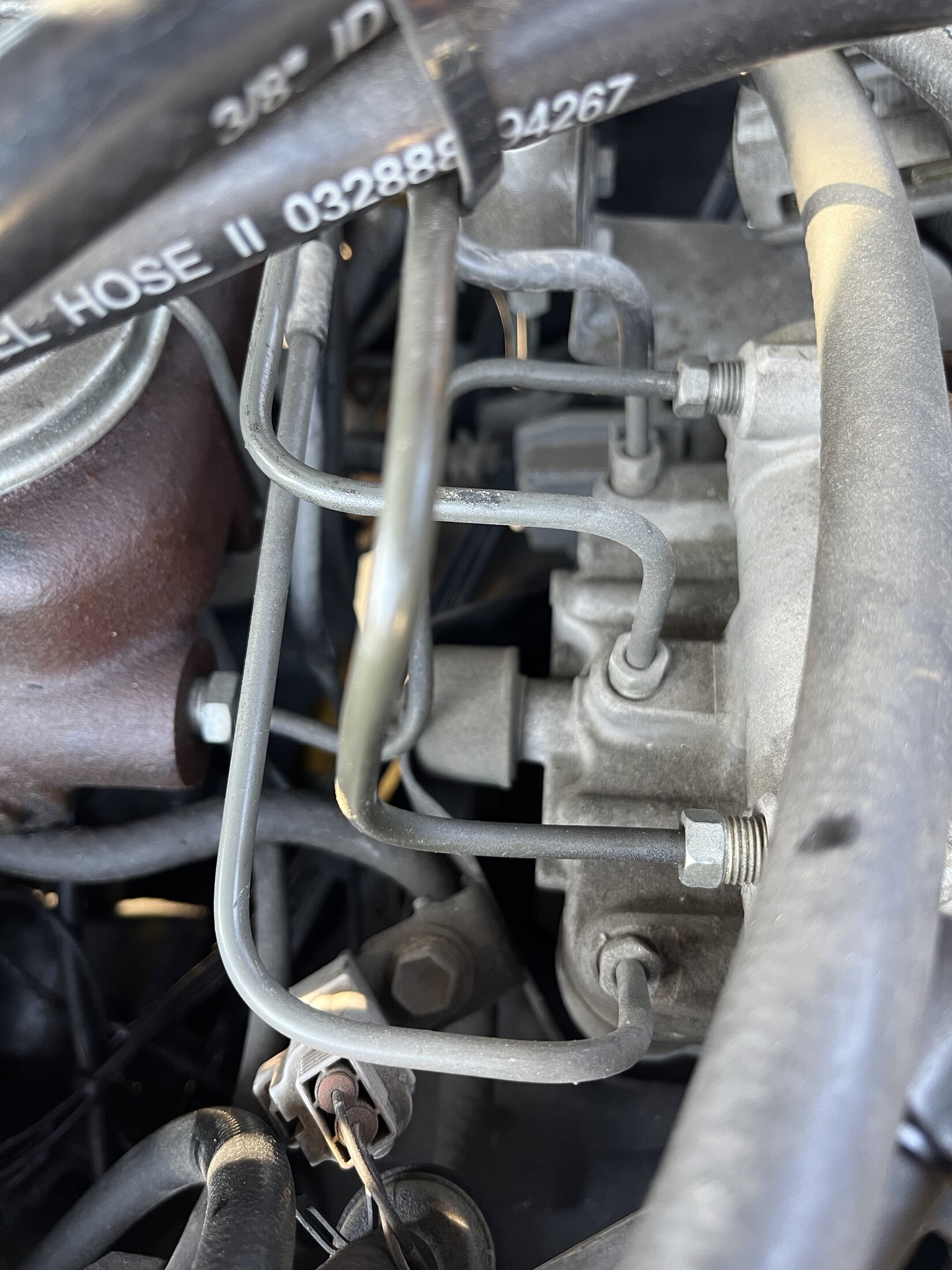

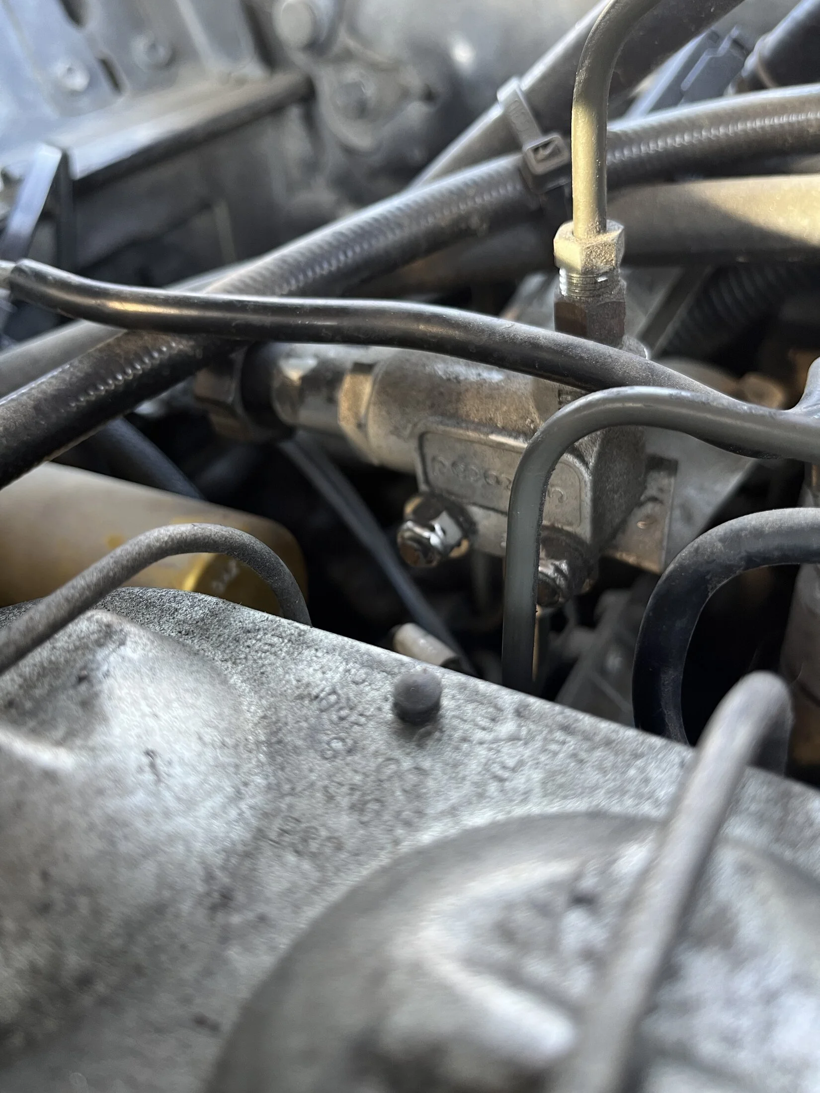

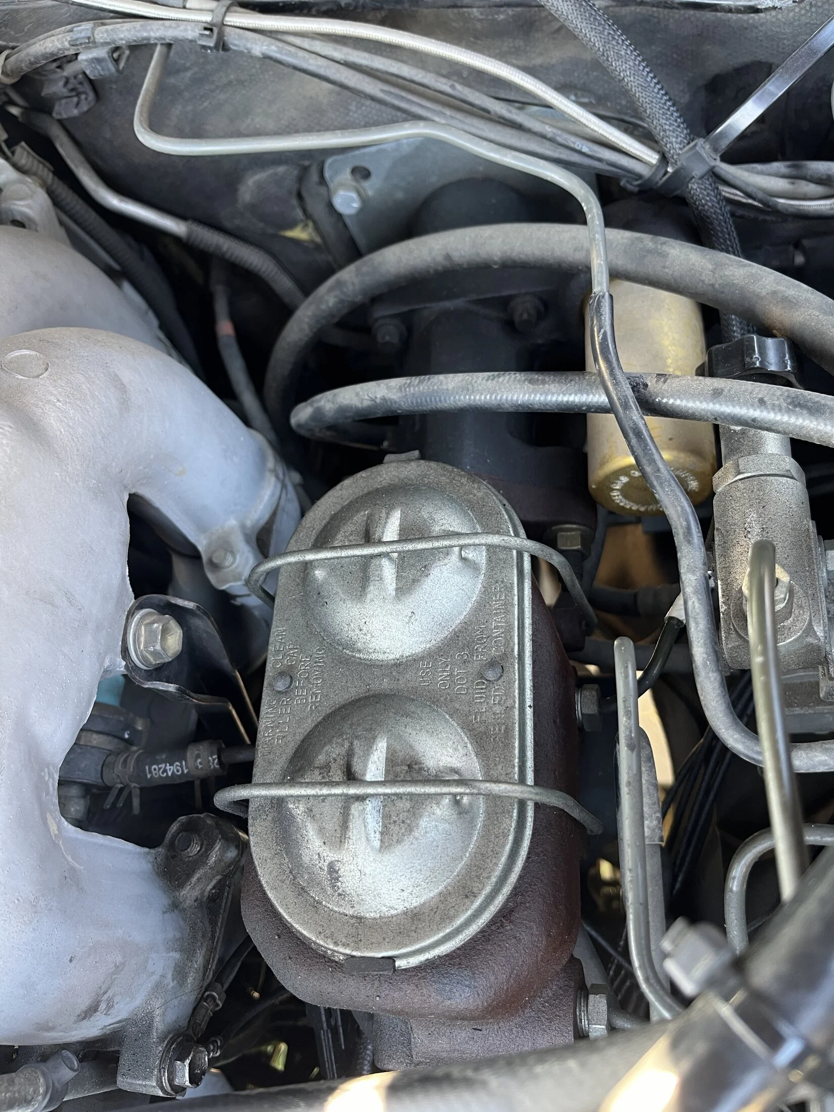

1. Rear GM brake line port (from MC) goes directly into Wilwood proportioning valve. Then plumbs into the top forward (closer to bumper) ABS unit.
What bottom port, of ABS unit, is the exit line/port for the rear brakes?
Once identified, can I just attach those two hard lines together with a female/female coupler?
2. Front brake line port (from MC) goes into the top rear (closer the fire wall).
Which of the bottom 2 ports are the exit for the front brakes?
I already assumed the lower rear (closer to firewall) goes to front passenger disk, by following it across the top of the firewall & down.
So can I just get a T-fitting to connect from MC line to the lower rear line & whichever other bottom line all together?
Then I believe I could toss the ABS module.
Am I looking at this system correctly, as it’s currently in my rig- partially modified already?
So I’d just need a single female/female fitting & a T-fitting all Toyota thread pitch?

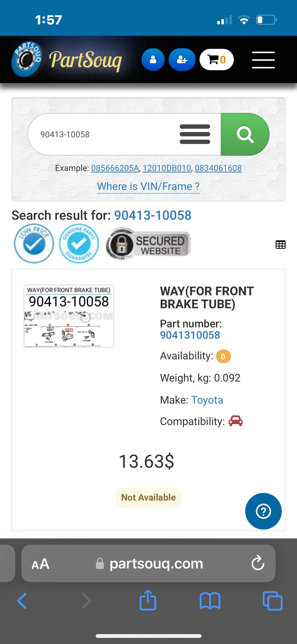

So I found this part on another thread about brakes. I’ll be ordering part 90413-10058 today.
That should mate up the ‘in line’ to the ABS actuator to these 2 ‘outlines’ from the ABS.
Still working on a OEM Toyota part to couple the in & out lines for the rear lines.

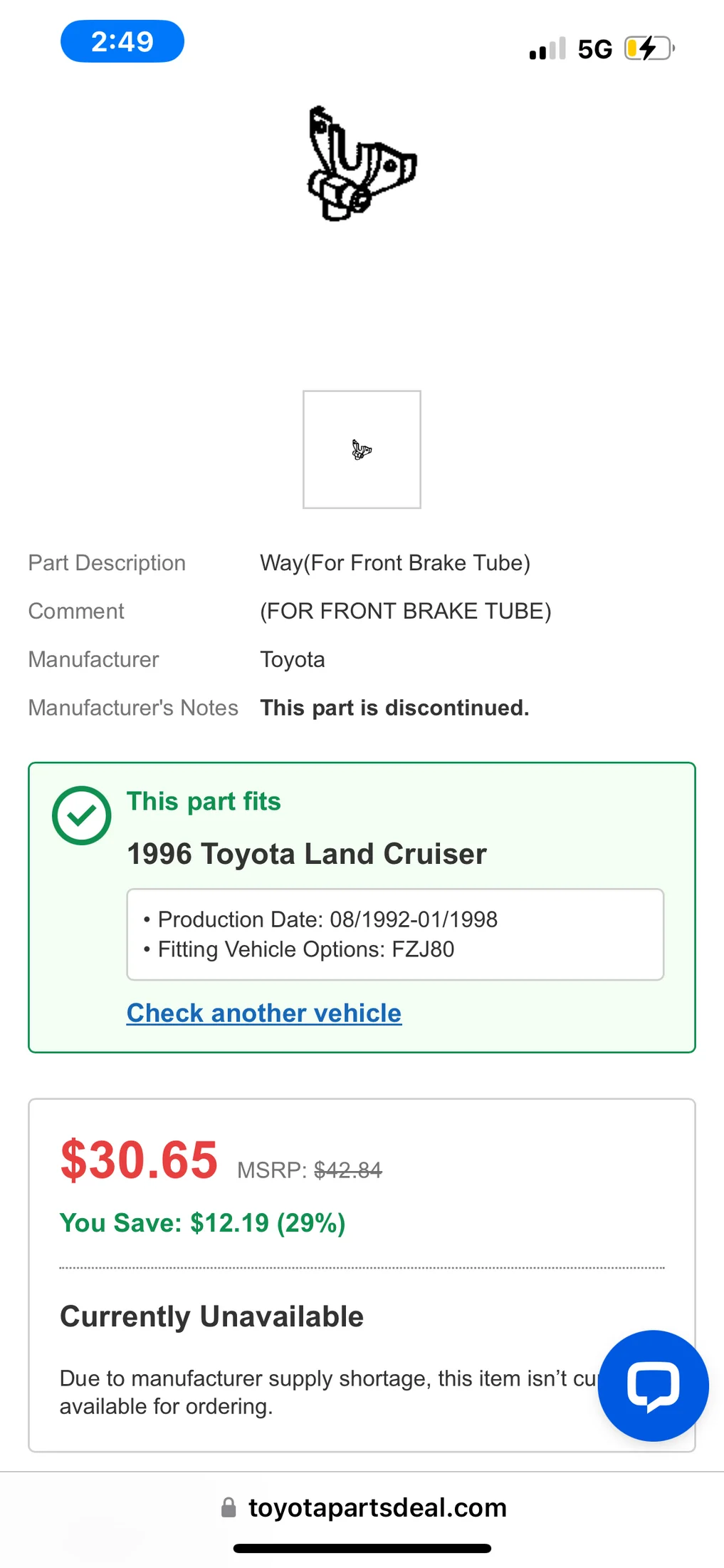

Pert number & photo listed above sounds NLA.
$13 at pastor.com, NLA.
$30 at partdeal, NLA.
Random OEM sites $40, but I’d imagine it’ll get canceled as NLA.

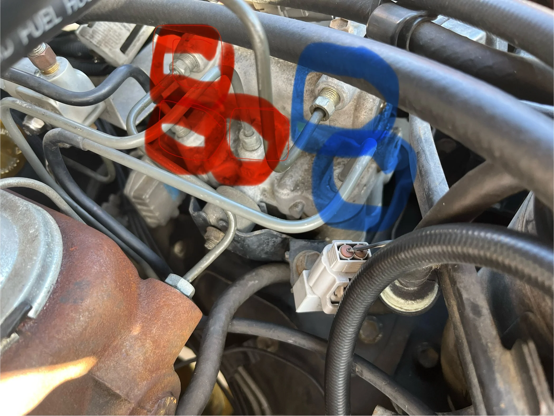

I was able identify the lines of the ABS unit.
Upper red circle is front ‘in’ line for ABS modulator.
Lower 2 red circles is the ‘outlines’ for ABS connectors.
Top blue is ‘in’, notion blue is out line.
That T-fitting would be perfect from the front lines.
There is a 90* elbow in the system somewhere too. I recall using it to disable & reconnect rear LSVP lines years back.
Just gotta find those 2 parts!
