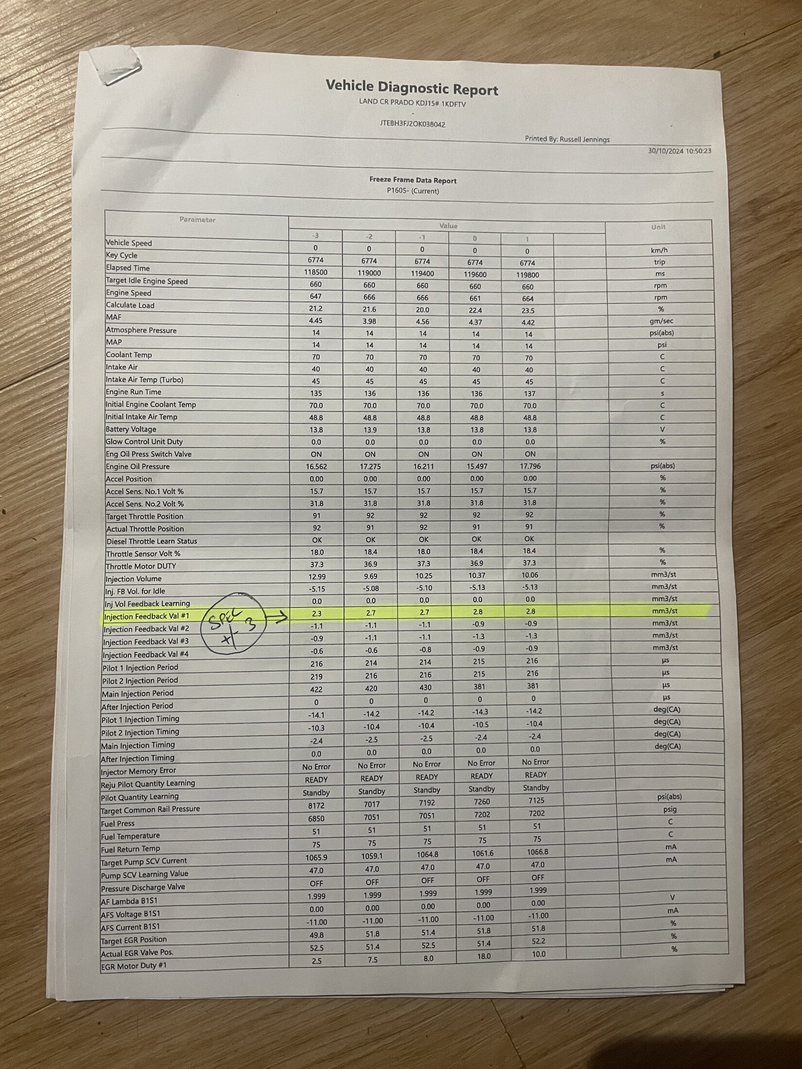

I have taken it to 2X Toyota dealers. The first said they can’t help if it does not happen when there (it did not). And the second investigated and could not find anything except for a near out of spec injector value. The issue here is they were all replaced at 85K miles which is very much premature.

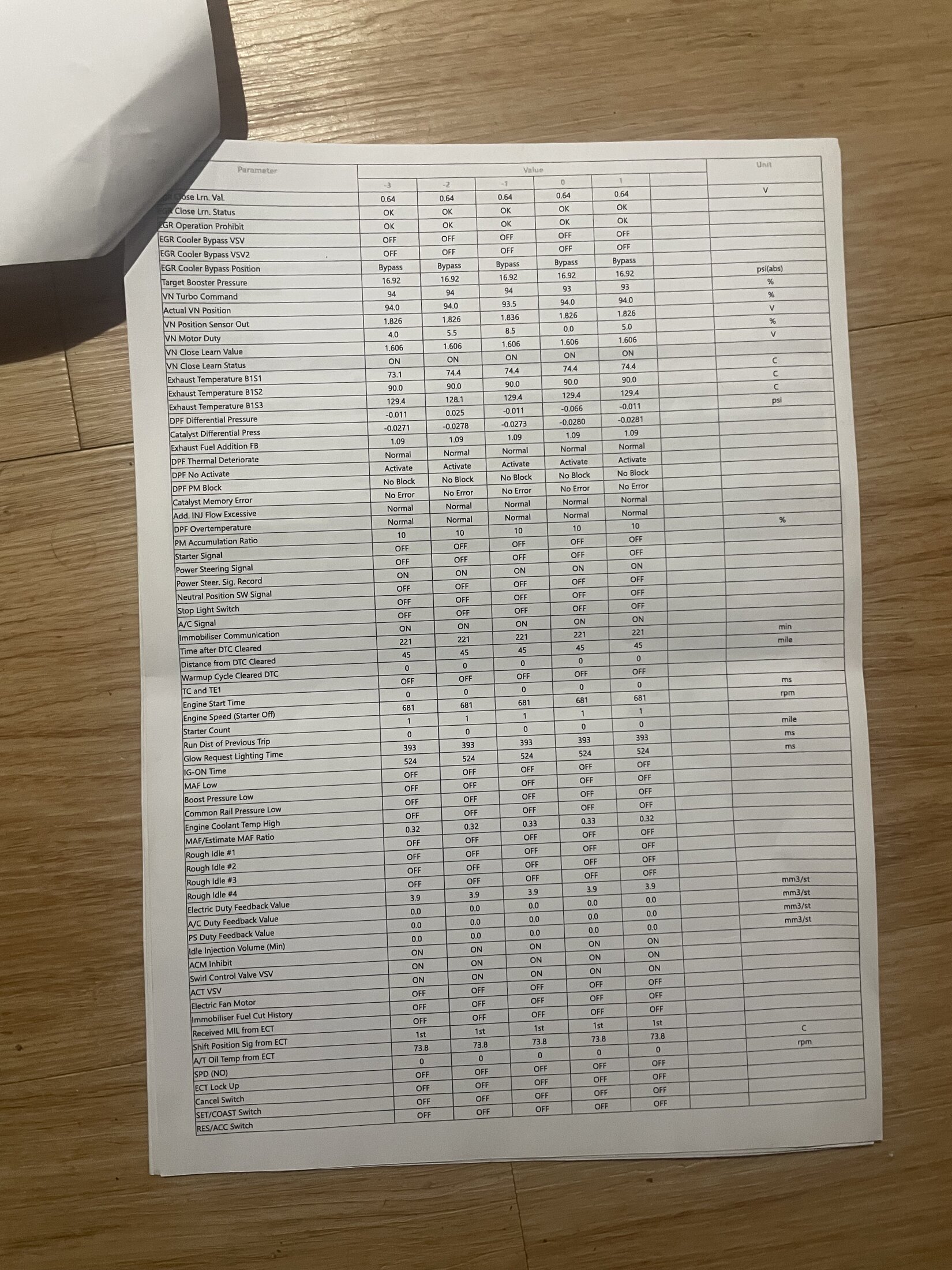

Attached is the tech stream screenshot. Does anyone have any suggestions?
Video: iCloud Photos - Apple iCloud - https://share.icloud.com/photos/00187R7k829PrJH8I5Mvy-gJg
Techstream readings attached. Already replaced a cracked vacuum hose and the cracked map sensor filter. All service items are done. When MAF was replaced or cleaned issue was significantly worse for the first drive.
