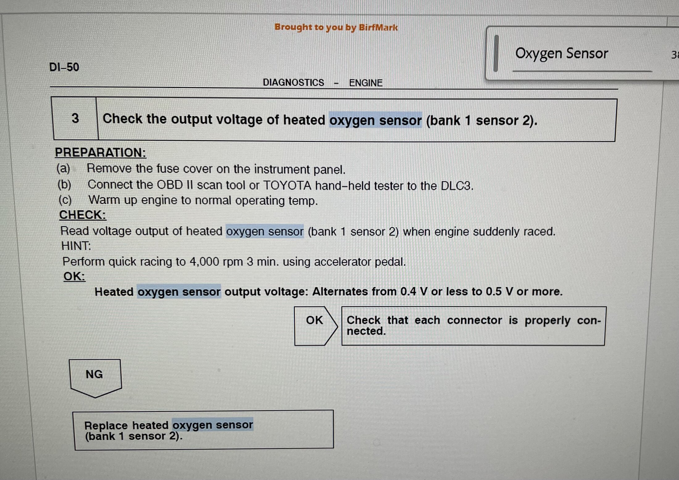

Hi experts,
I have 97 FJZ80 with170000 miles, and trying to figure out if my O2 sensors and the CAT are in a good shape. Looking on both O2 sensors while driving and both seems to operate between 0-0.9v but when in parking in idle rpm, the downstream is around 0.1v +-0.05v and when I increase the rpm to 4000 it is even lower than 0.1v. See pictures. I understand that it should be around 0.45v. I check the back pressure and it is good. The measurements done with hot CAT.
What does it mean? Any thoughts?
BTW,I replaced downstream sensor and got the same results. No error code.

Thank you for the answer. Actually I had done some homework with the FSA and done the attached test and got the low reading results.
I tried to understand what is wrong but there is no code and no help from the FSM.

Alternating from 0.4 or less to 0.5 or more...
I would say its acting as intended.
