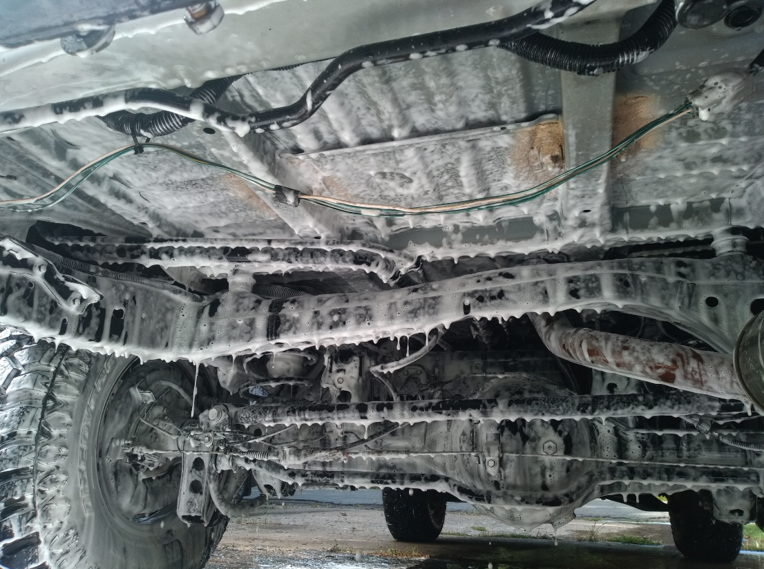

Murphy's Oil Soap with a pressure washer foam cannon. Whips up to a nice froth and leaves a nice shine.
Do you agitate or just let it soak then blast it?
At the time, I just let it soak and then used the pressure washer to rinse it. The soap pump on my pressure washer will no longer pick up liquid soap so I started using a foam cannon. I accidentally found Murphy's when my kid ran off with some special Chemical Guys soap for their foam cannon. So I like Murphy's better than the Chemical Guys soap because it clings. He later took the foam cannon so I bought a different one that I've yet to use. If there is a stubborn stain I would use a plastic bristle broom to scrub it.

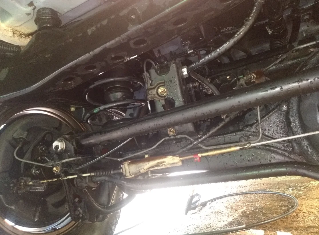

When I got into my 2001 Land Cruiser (The King), in 2003 w/59K on it. I found a coin op car wash with a flexible wand. I'd take a knee pad to get down on and under vehicle and into wheel wheels. It had what appeared to be mild surface rust. Over the years, I found most of it washed away. It looked better 13 years later at 175K than when I first bought it and no rust. Simple by washing thoroughly repeatedly often over time, it got better.
Today I have my own power washer. I found washing my first restores project, took $200 at a coin op. Automated drive through could even come close to cleaning as good as I could myself. Which also is part of my inspection process, as I'm looking over ever inch as I wash. One sees nothing, going to a driving through automated car wash, except shinny body afterwards.

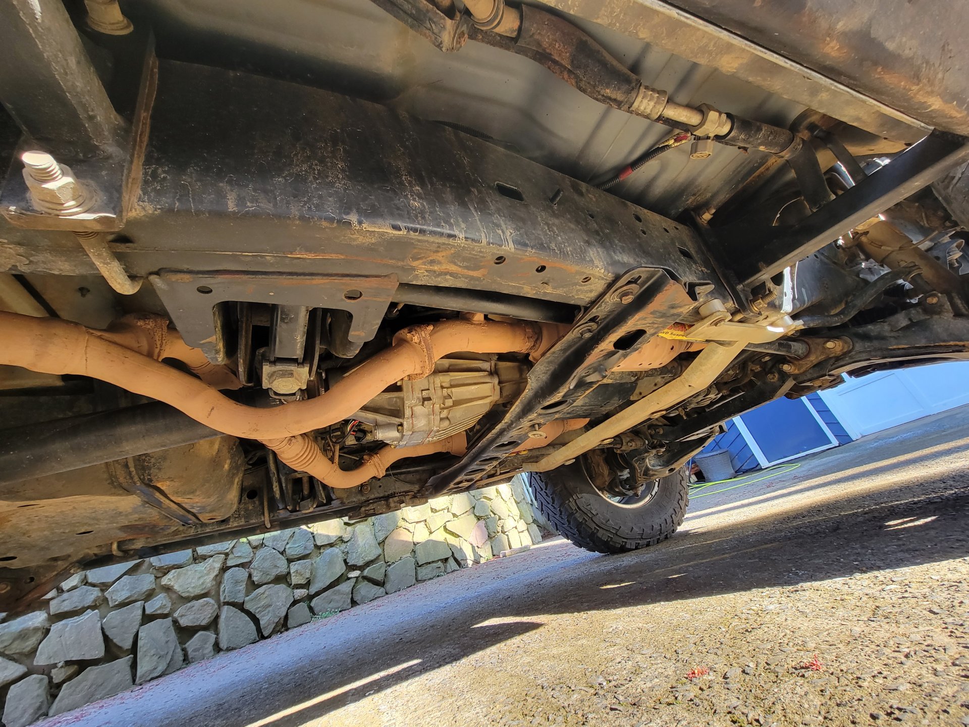

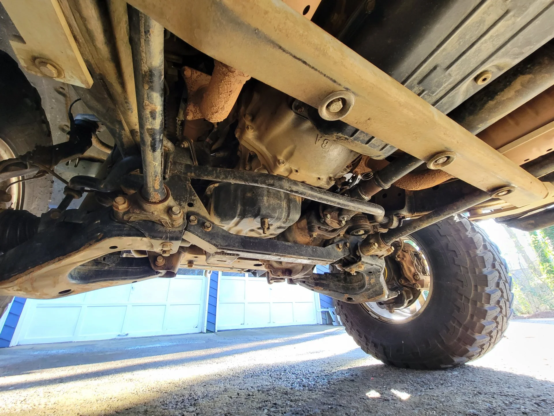

@sammybones I showed you mine, show me yours.
