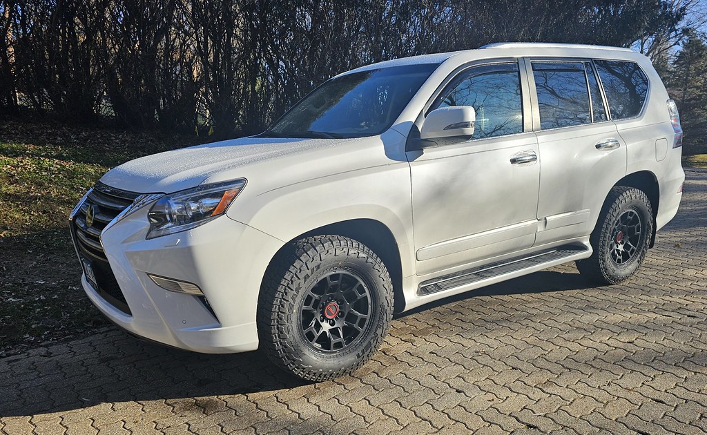

During the Black Friday sale when a couple of Toyota dealers had +25% off on sales I ordered 5 TRD Pro wheels, 4 caps and 4 black lug nut sets for my 19 Lux. Which according to the chart they fit and they do. With Wildpeak 265/70r17 tires
TRD Pro black wheels PTR56-89210-F2
TRD Pro Center cap, post SEMA red ring PT280-89210-F2
Lug nuts black PT076-60200-02
Stock suspension. Sliders will land in a couple of weeks and next Thursday doing a moderate bumper trim and AC Condenser skid. Also 20+ Blackline solid black grill swap, along with Attica headlights.

Wildpeak A/T3W 265/70r17 on black TRD Pro wheels post 21 4Runner (PTR56-89210-F2) have just a little bit of rub on inside bolt head at full lock. Not much of a mod to replace with a flathead bolt to prevent it. I used the ziptie mod until my sliders come in and will cut the offender off completely.
