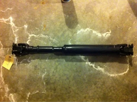

I paid about $50 for the joints, you're right. I just got back from talking to the night shift guys. They looked at me like I'd just pooped on the floor when I asked them to balance it 90 degrees out of phase. Thanks to this site, I was able to articulate why it was 90 out from the factory. They took it and told me to call the weekend driveline guy first thing in the morning, and to be prepared to argue. I told them to write "do not argue" on the ticket. Here's a pic of the shaft...

Stylo07: Regarding your question about sand/bead blasting the front driveshaft; I did this to my front shaft using glass beads (with the U-joints out of course), washed it well, then painted it using rattle can epoxy paint. The one photo you posted above appears to show a rough surface, was that taken after the shop blasted and painted it??
Yes, it was taken after I got it back from the shop. However, when I gave it back to them tonight I asked them about it. They just put it through a parts cleaner and gave it a quick coat of black. The rough surface you noticed is remnants of the factory undercoating.

doesnt this pick show the driveshaft "in phase"??
Yes, that's after I picked it up from the shop. I returned it the next morning and asked them to balance out of phase 90 degrees, as it originally came. However, now I have vibes, so I'm going to try it in phase, after all... I'll post back with my results when I get the time to pull the shaft back out.
