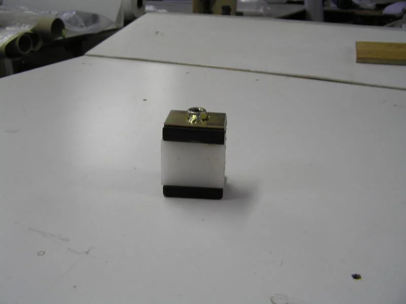

I'm doing a 1.5 inch body lift on a 77 fj40 and need a u-joint for for the steering column. Any suggestions? Thanks, guys.
The lift parts I'm using are UHMW under the body and 1.5" X 2.0" tubing under the bib and back end along with with Energy Suspension mounts and polypropylene webbing
