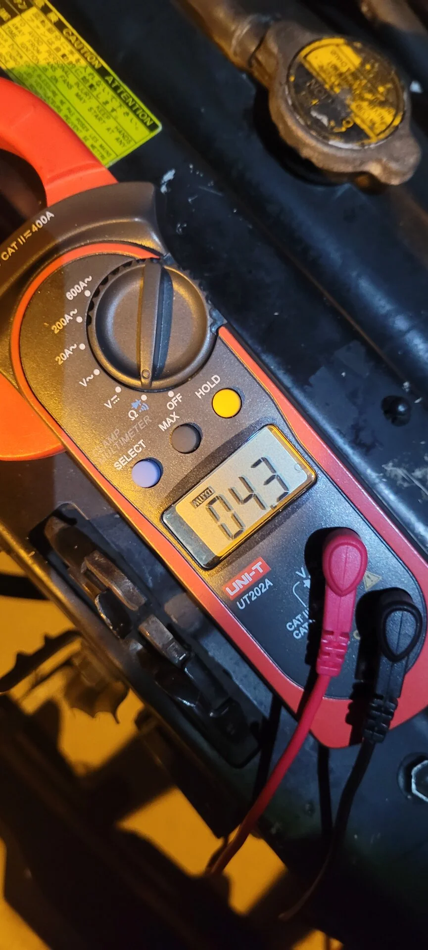

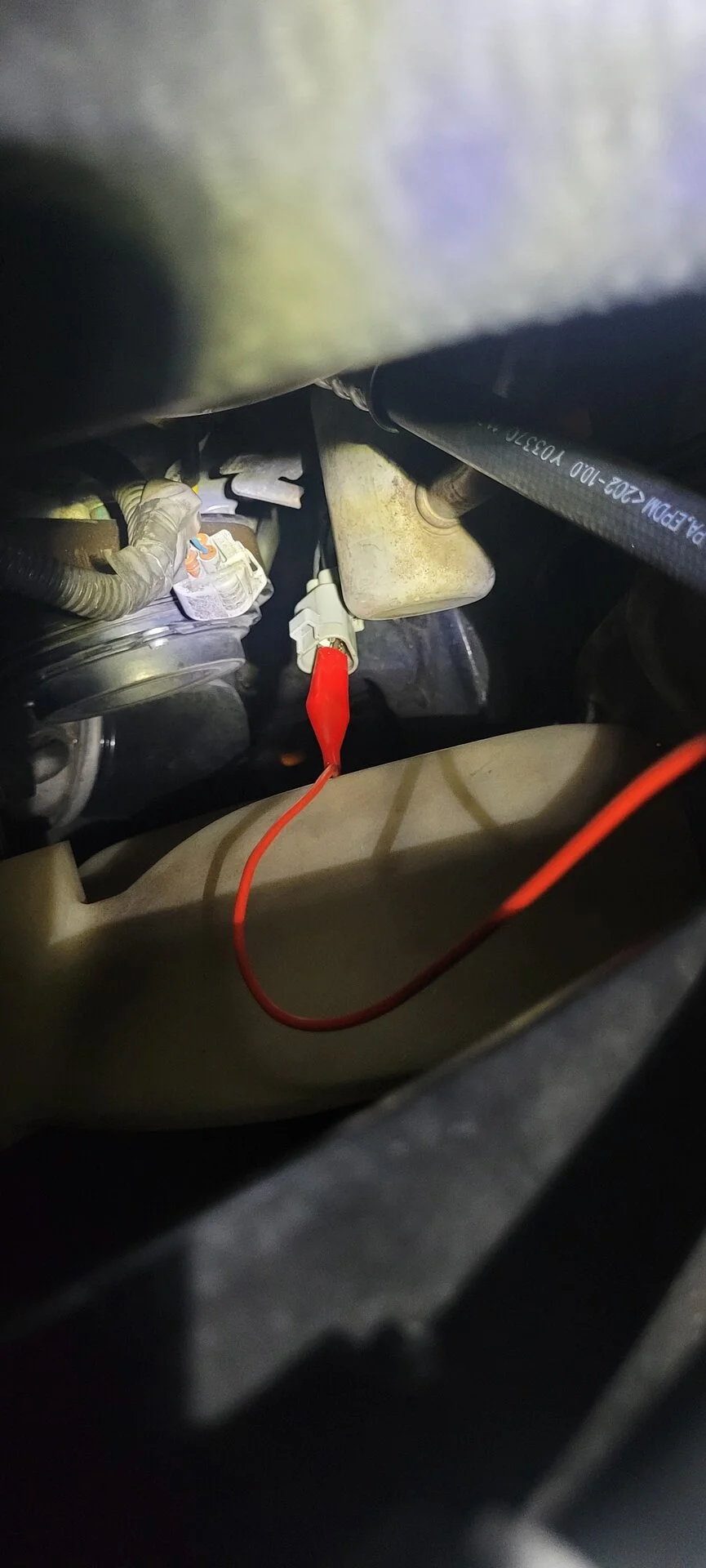

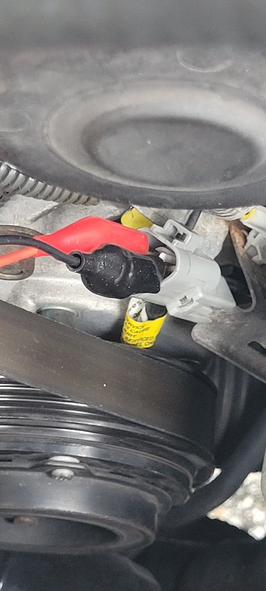

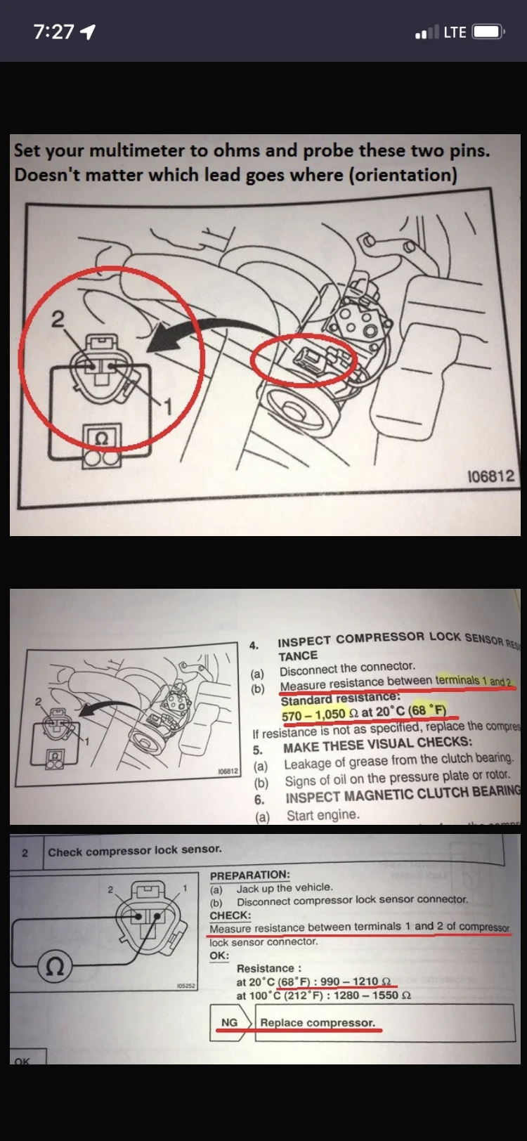

I would suggest using a multimeter to check the resistance at plug connector on compressor. Connecting to probes will give you an ohms reading. I fought this issue for too long. The advice and picture below from @flintknapper solved my issue….. which was a new compressor.

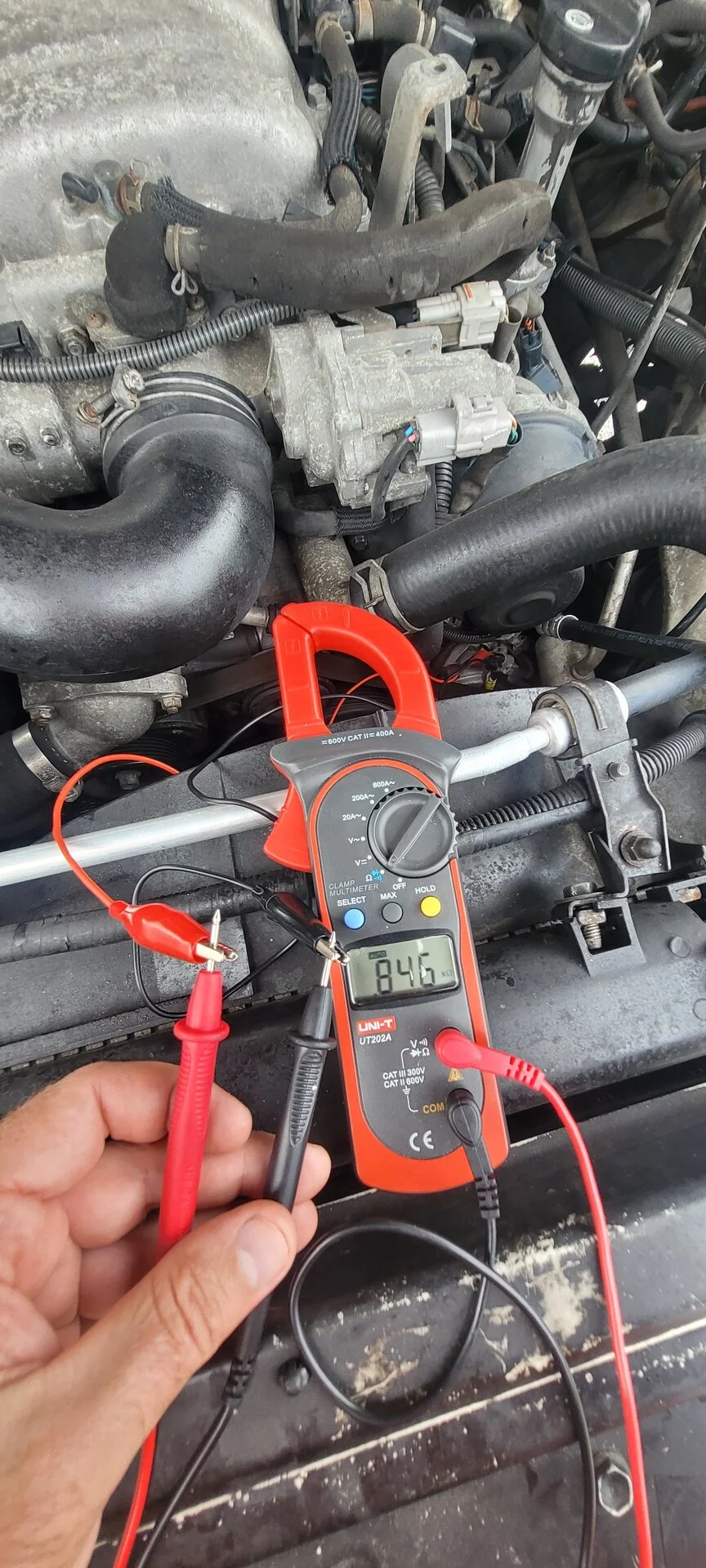

I get reading of .846 k ohm 84 degrees farenheight. Look good?
I also checked the clutch ohm reads 4.3
I just tested my good compressor at 830ish as well.

3. Measured resistance across the compressor connector pins (per BullElk above) and got 864-Ohm.

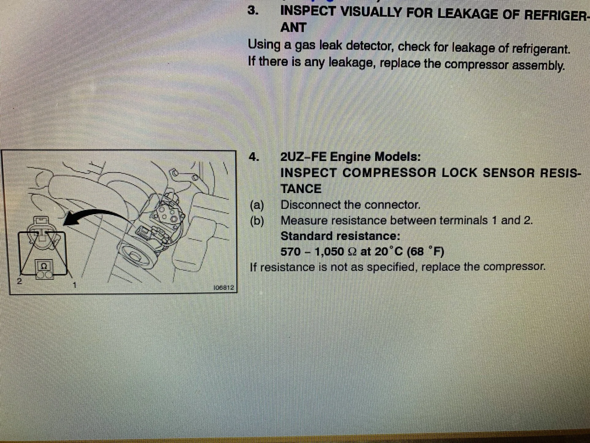

Why are there two different images with different resistance ranges? Which one is correct for a 2002 LX? Thanks.
I do not know that answer. At the time I received the pictures and info I had been exhaustively battling the issue for a while. I then tested resistance getting 600s ohms I believe it was, replaced compressor and it has been flawless for a few years now.
Just took this from “LC100 Workshop Manual”
Apparently for all 2UZ-FE engjnes

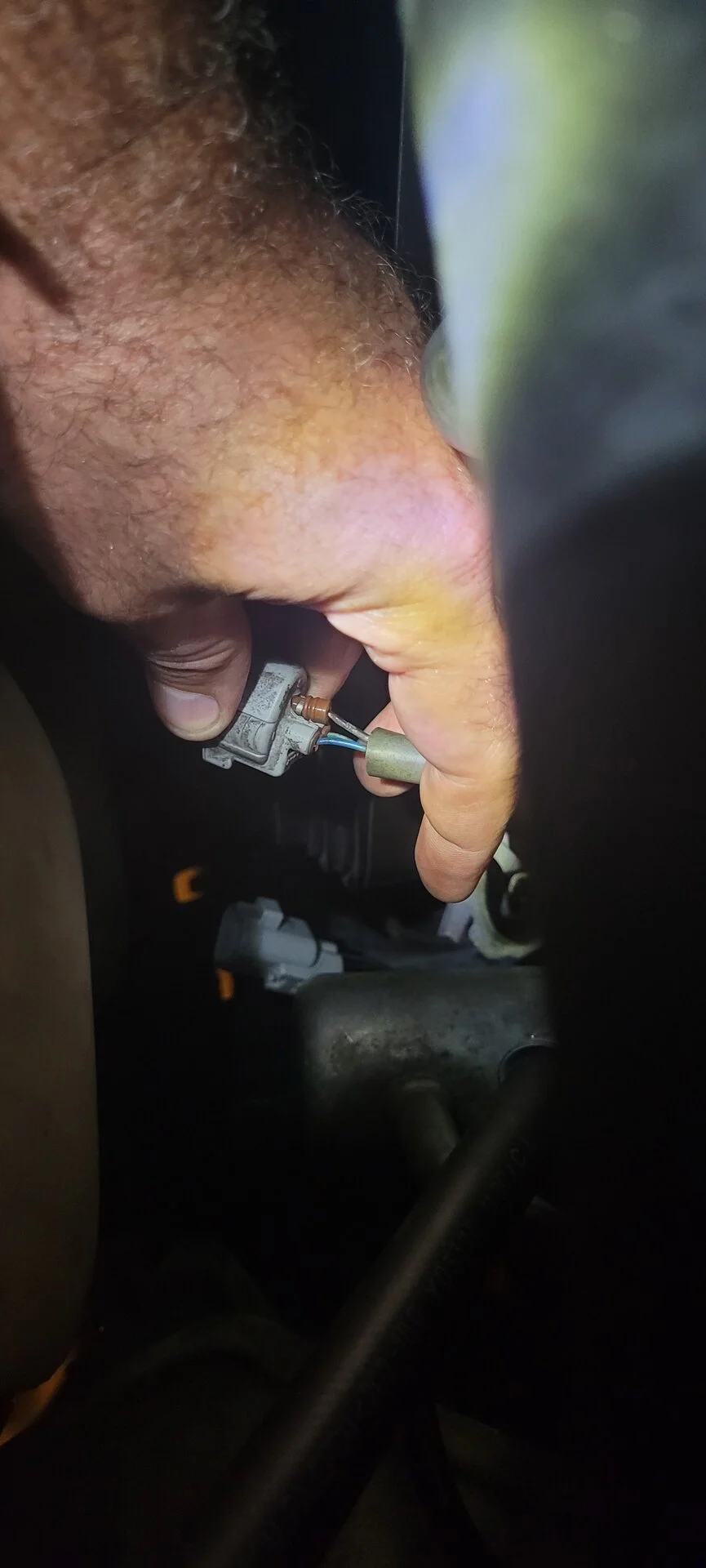

I unplugged the main 3-pin connector on the compressor, and lightly squeezed/bent the female conductors on the car side, to make sure they will maintain contact with the male pins on the compressor side. One theory I have is that if this connector is loose, or if there is inadequate contact between the conductors, it could cut out sporadically.
