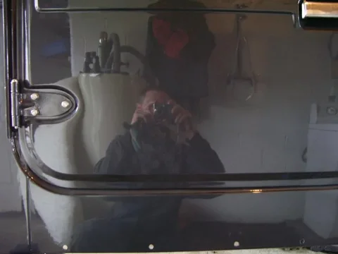

And here is a pic.

You can't throw out that pic without giving more details. Who sprayed that and what did he use?
LOL - Here is a link to my build thread and it should have everything you need there.
https://forum.ih8mud.com/40-55-series-tech/227633-1976-fj40-buildup-chief-itty-pants-6.html

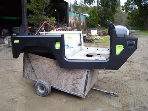

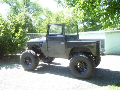

Its kind of long winded so here are a few more pics. My painter buddy (Mark Harders) is an animal!! His profession is body work but he is evolving quickly! With the help of him (basically holding my hand) I performed 99% of the body work and prep and he sprayed. If the material brand is not in my build I can gladly get you the name I just need to go look at my stash which is still at his house. (all of his help was 100% free!! I just helped him to return the favor on some of his toys)

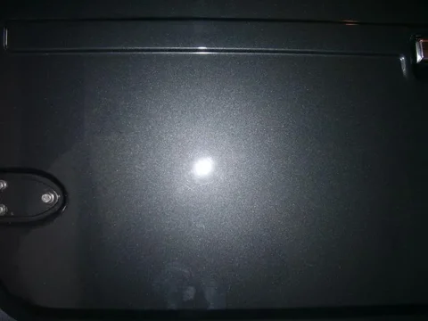

burnttoastburgos - I missed your post while typing this. I have one more picture I will load that I think better shows the color. I picked my basic color as you have and then drove parking lots till I found a vehicle that had exactly what I wanted and then searched down the factory paint code. :meh: Might be worth a try
One more it may or may not help see the tru color. It always looks different on the computer...... You can not see the red pearl sometimes. If I had to describe my color though I would say DARK I wanted a stealth look. NO BLING

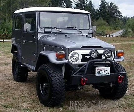

Here are a few others that people were nice enough to help me find when I was in your shoes. One was called charcoal and the other gun metal grey
As for challenge of picking a color :bang: I agree it was half as hard to name my son!!! The next in line might be buying tires!! :D
