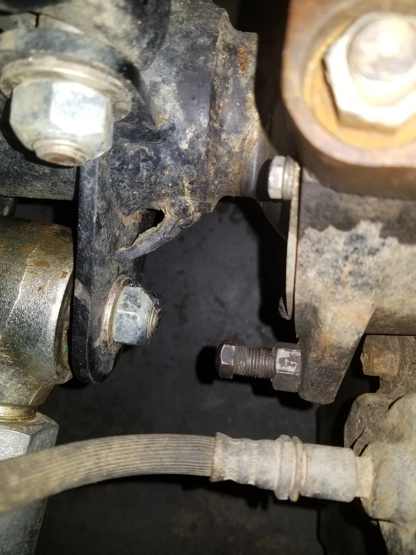

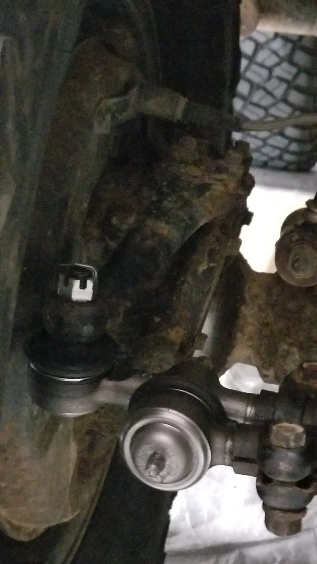

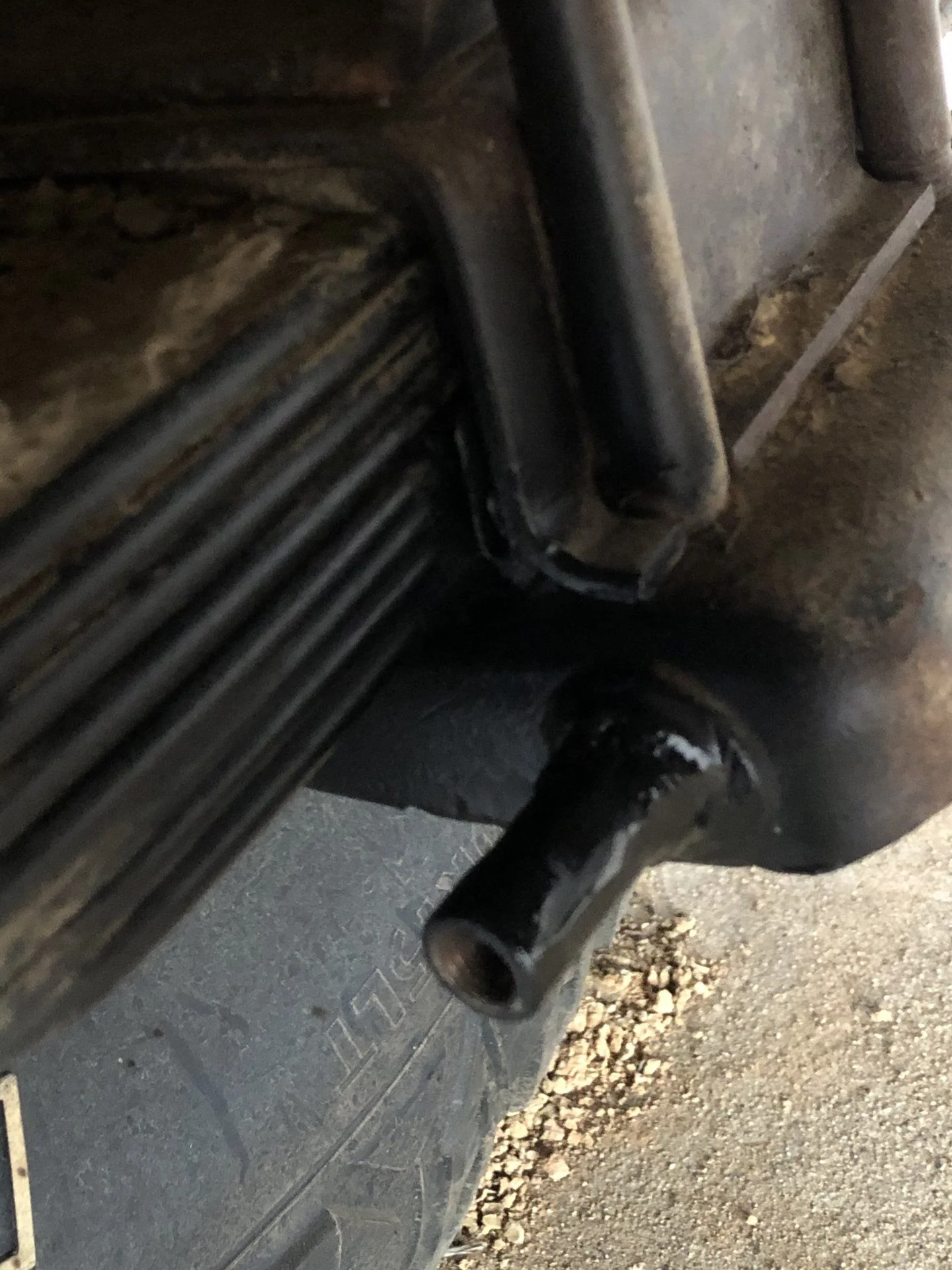

During the last run I discovered that at full turn the tire was hitting the lower link causing the hydro steering to scream....
Passenger side:
Here is the adjustment nut.. not many threads on it..

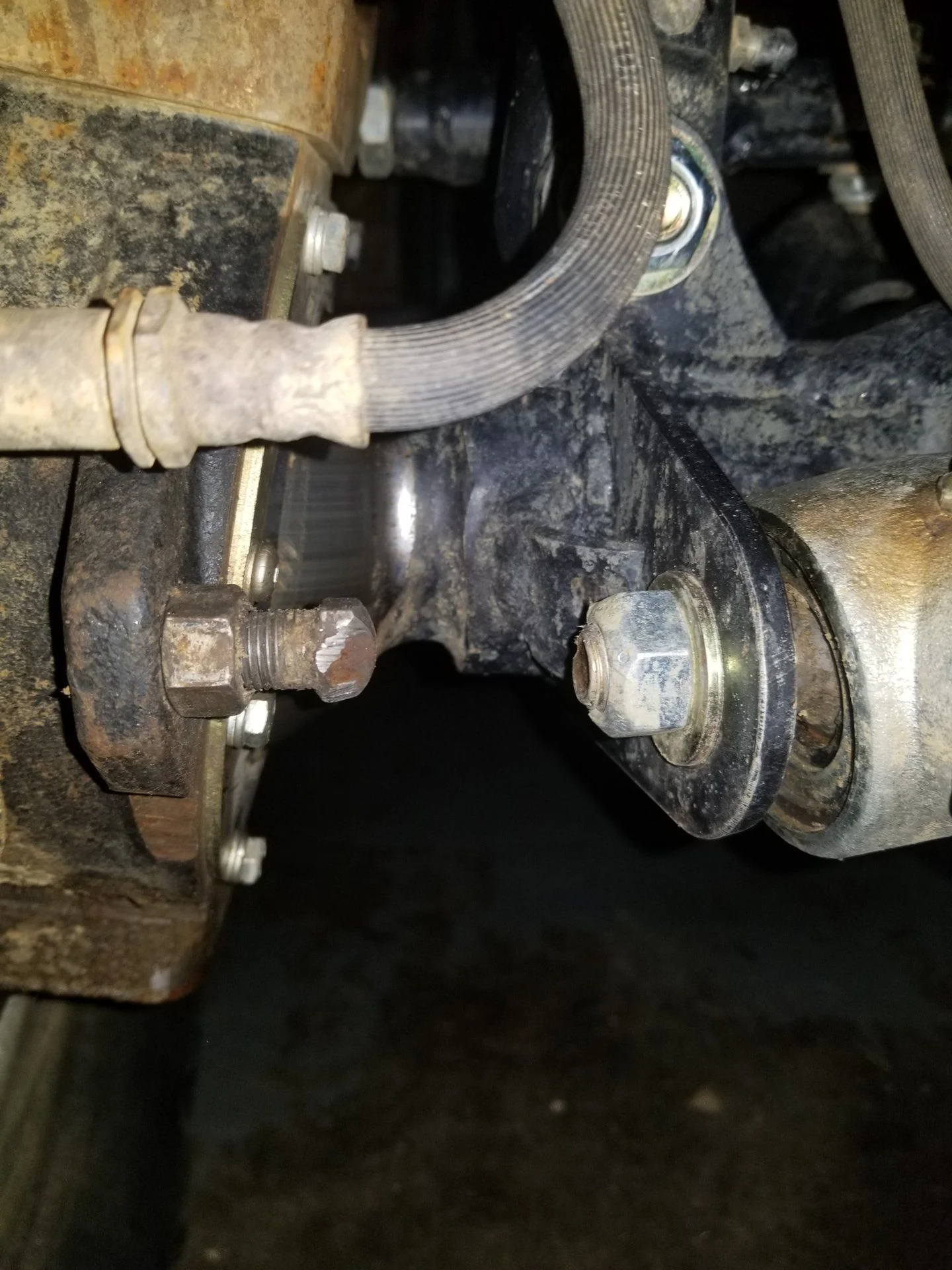

Driver side:
Nut.. little better but had to shave the bolt to clear link mount...
I havent looked but I'll need to see if I can find longer adjustment bolts... I'm good on level ground but i think I'll still rub on flex...
Also sucks that I lost good amount steering angle...Another reason to swap out to the wider 80 axles....:confused:

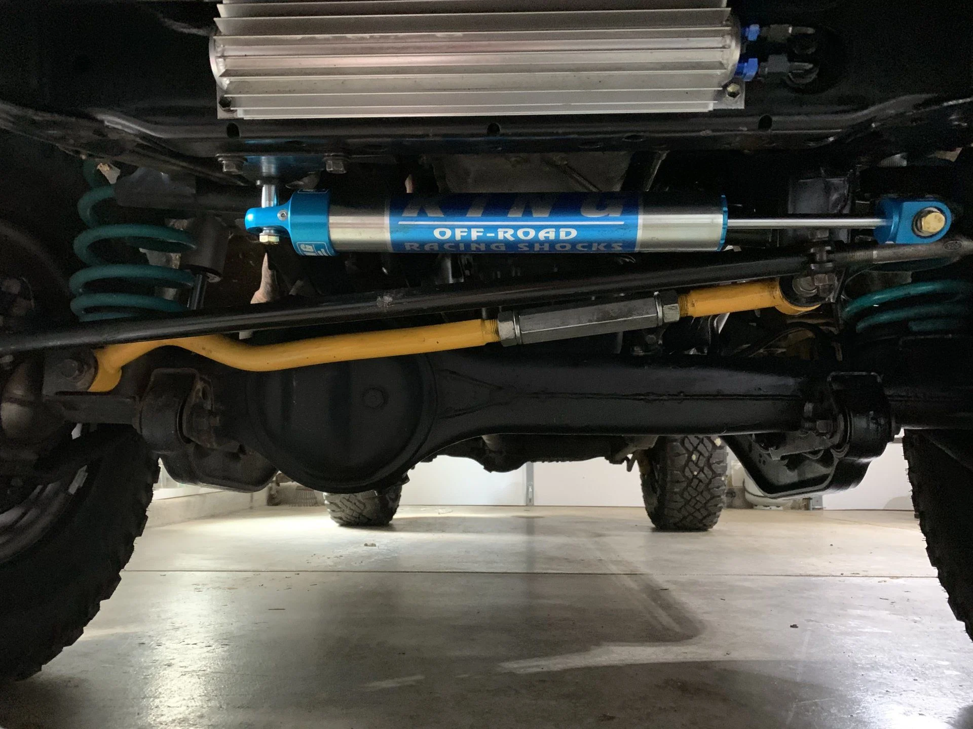

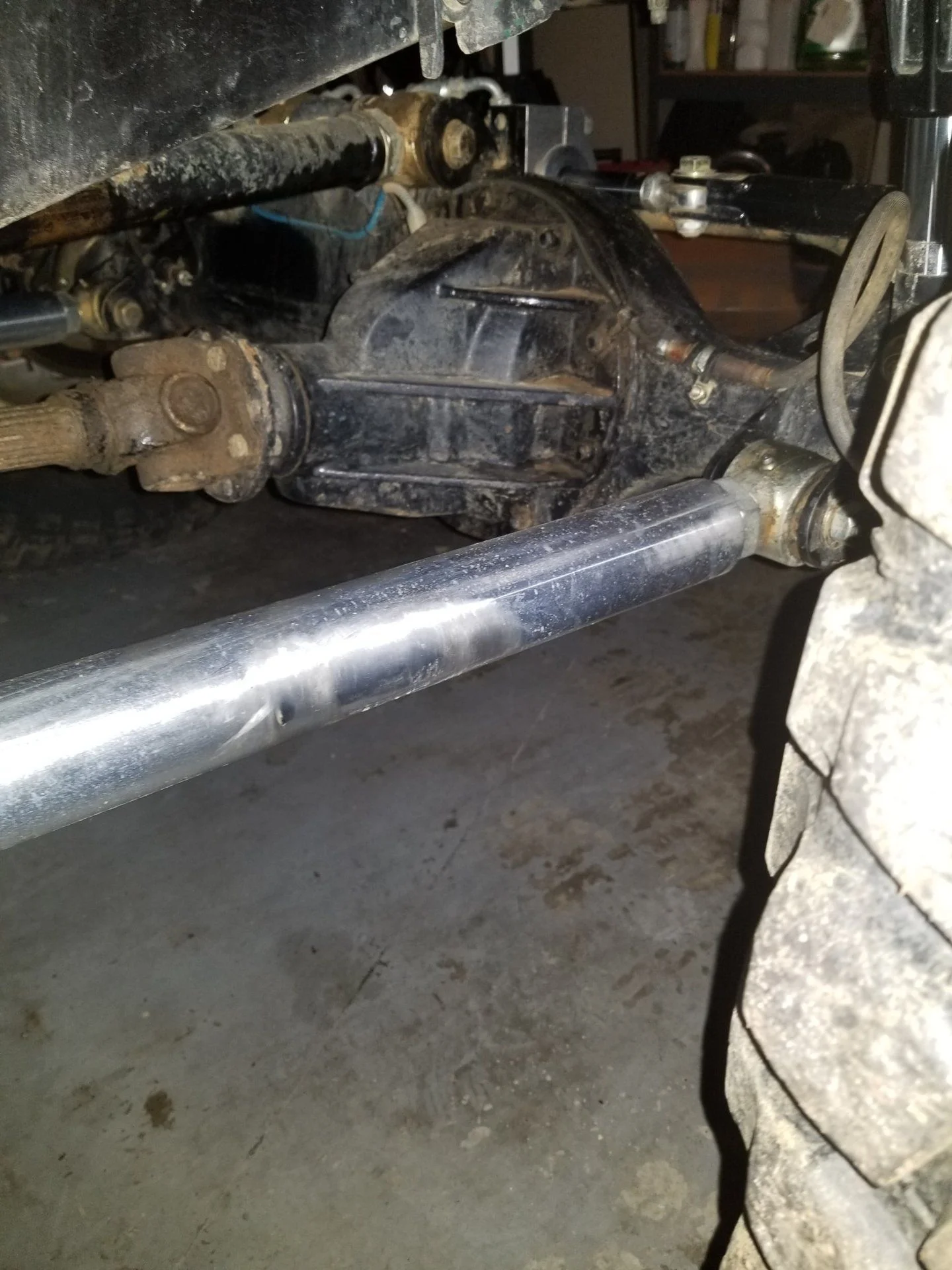

Zach and I rebuilt the steering on the 40. Super nice with very little play now.
Center arm kit, tie rods, relay rods, drag link and a new rag joint. All of the old was pretty trashed but the rag joint was in crumbs as it came out.

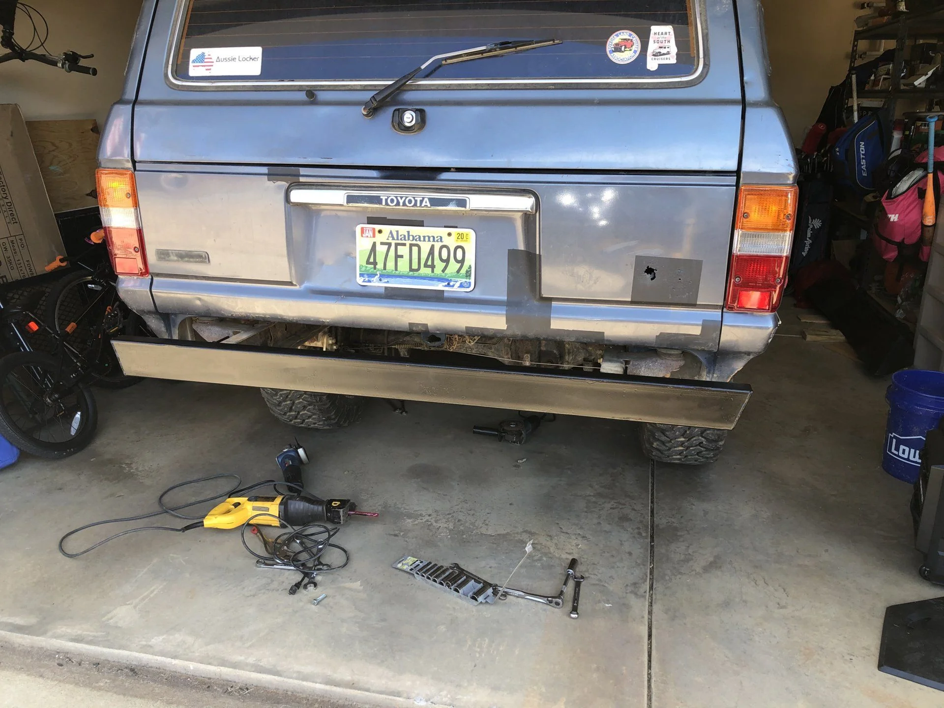

Slapped enough of the 60 together to use it this spring. I had removed the rusted out rear cross member so had to fab up a rear bumper. Lucky my old sliders were the perfect length. Welded on a couple plates, painted it, and we’re good....
Also, I had broken a mount for a rear shock so the welder saves they day again. All she needs is new glass to be ready for spring wheeling. Will get to my spring over sooner or later I guess

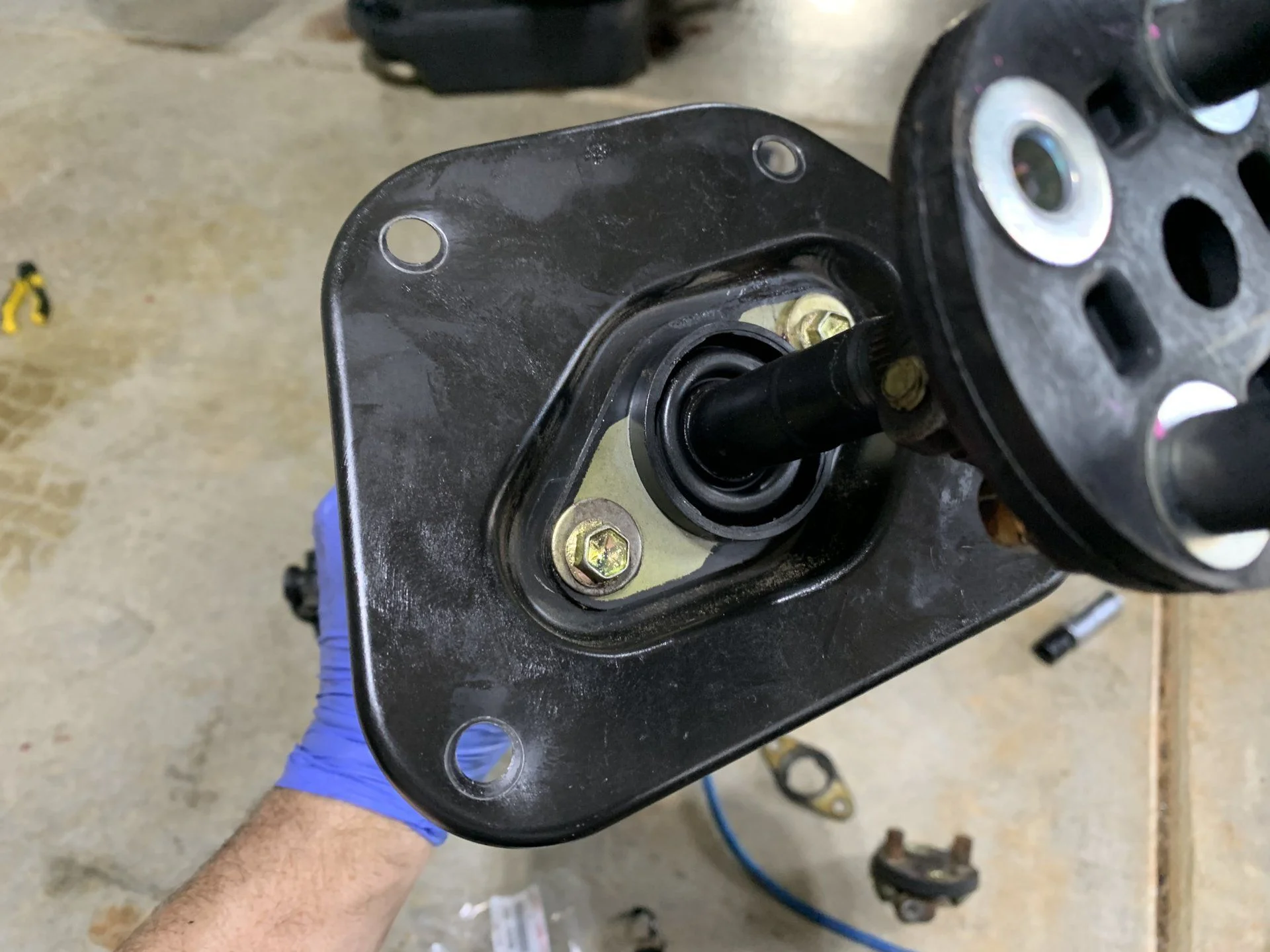

NOS Camry steering wheel. 45102-06061
45209-60070
45292-35050 Steering shaft seal
45230-60010 Steering Shaft Coupling

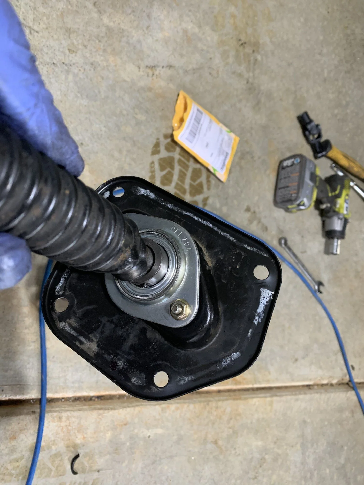

Also picked up a universal firewall bearing for a steering shaft.
Power steering pump and
Steering box.
The reman steering box I installed before Christmas has a slow leak. I had a replacement sent. This should overhaul the steering.

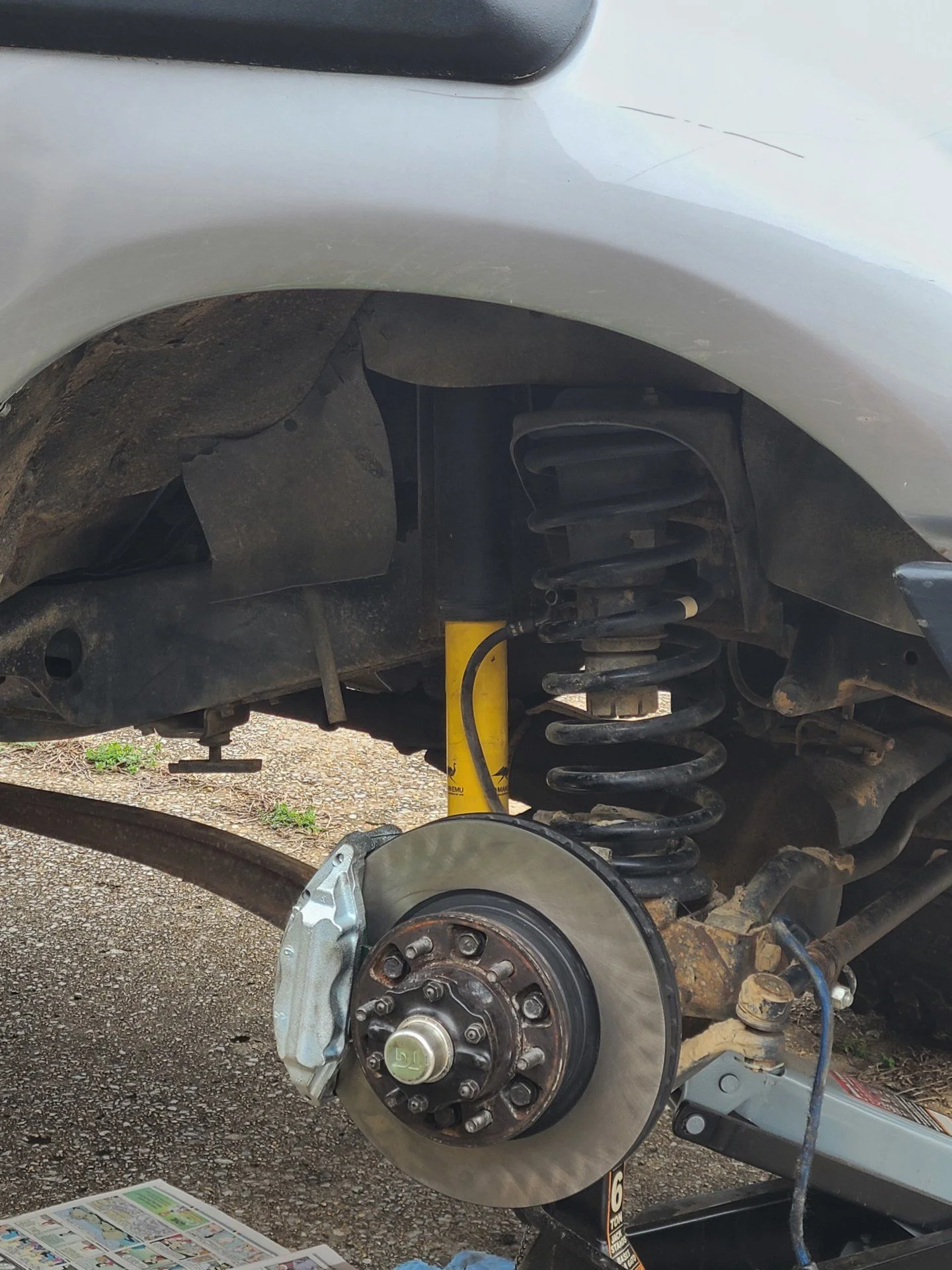

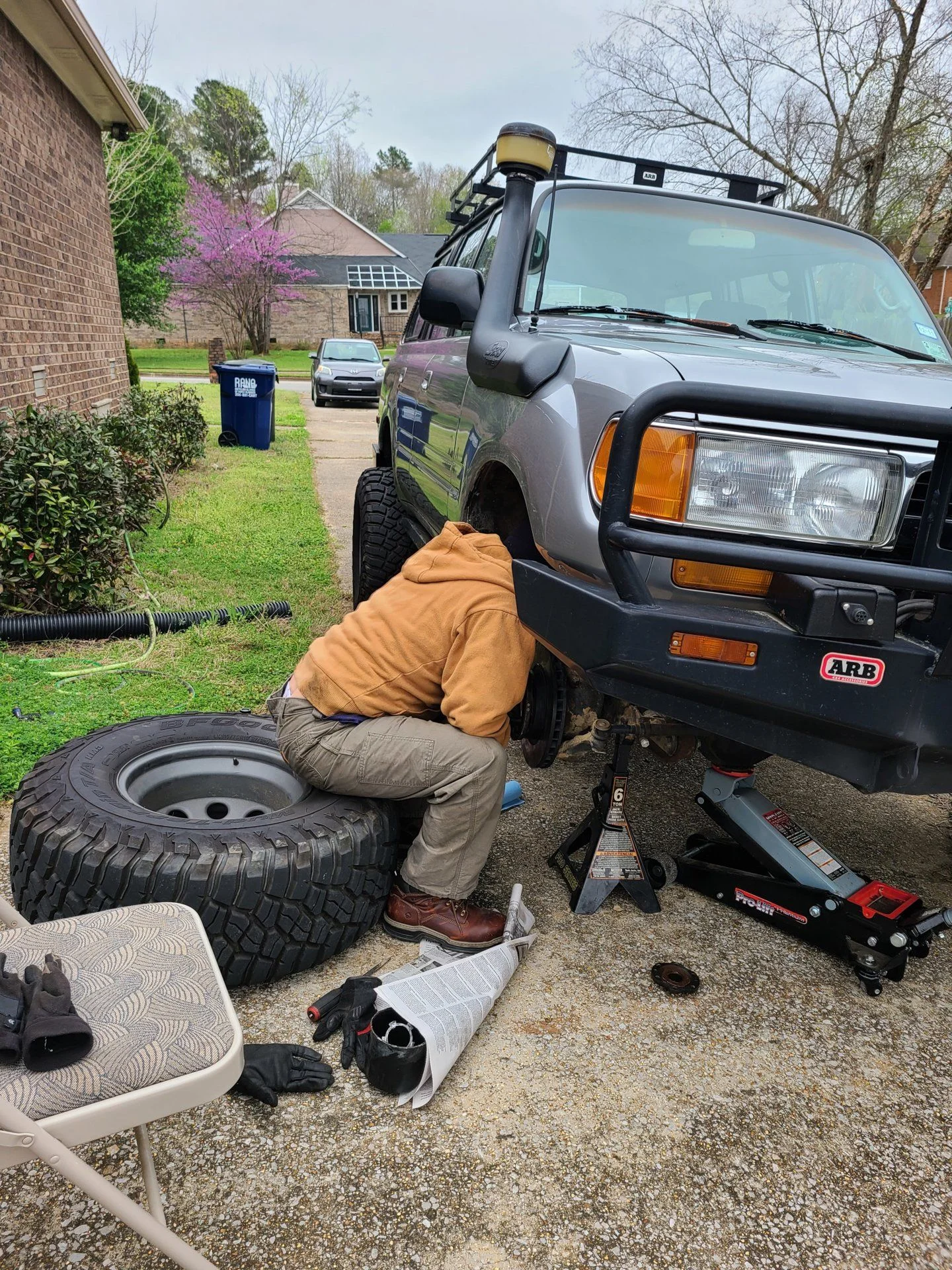

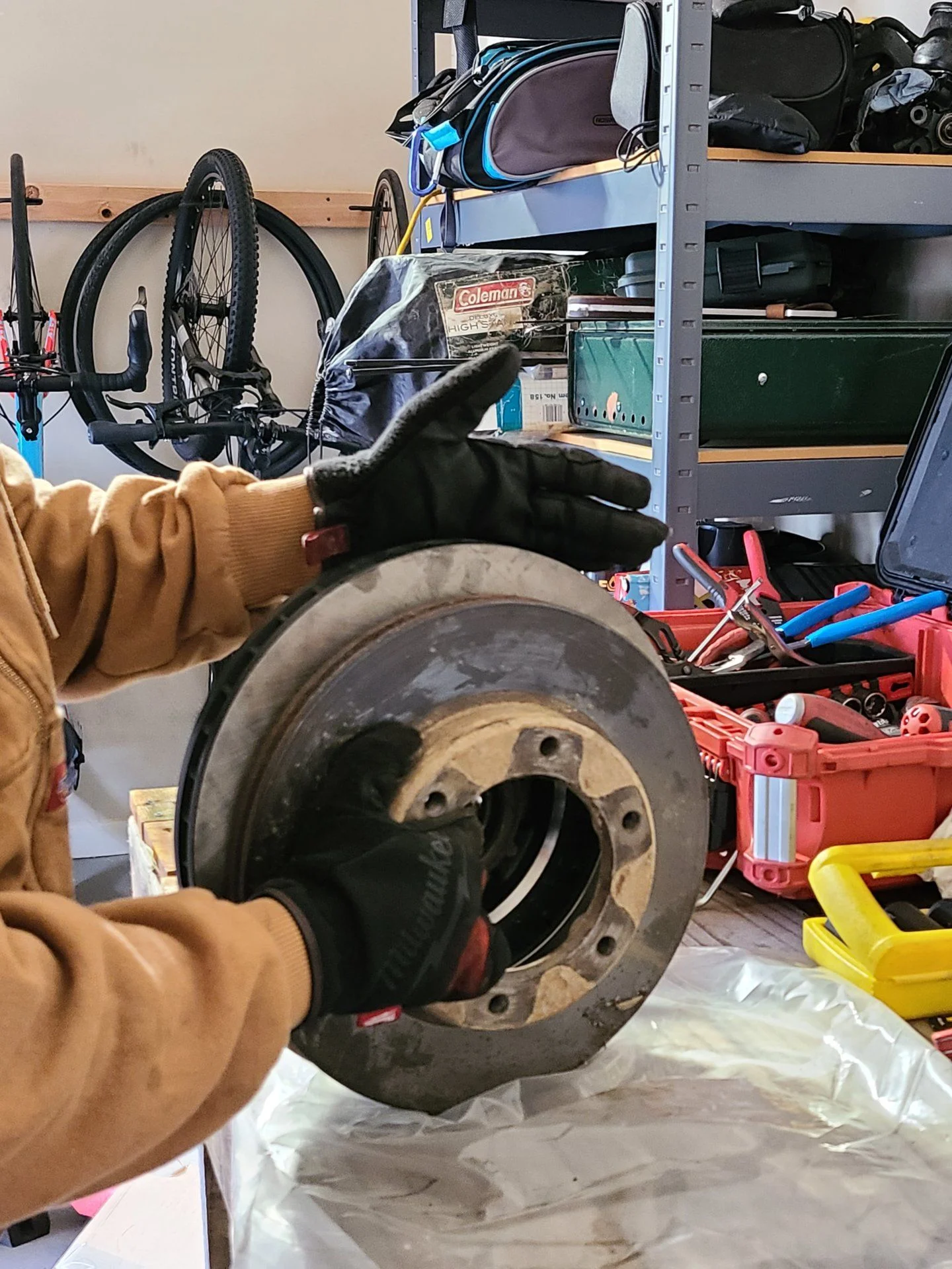

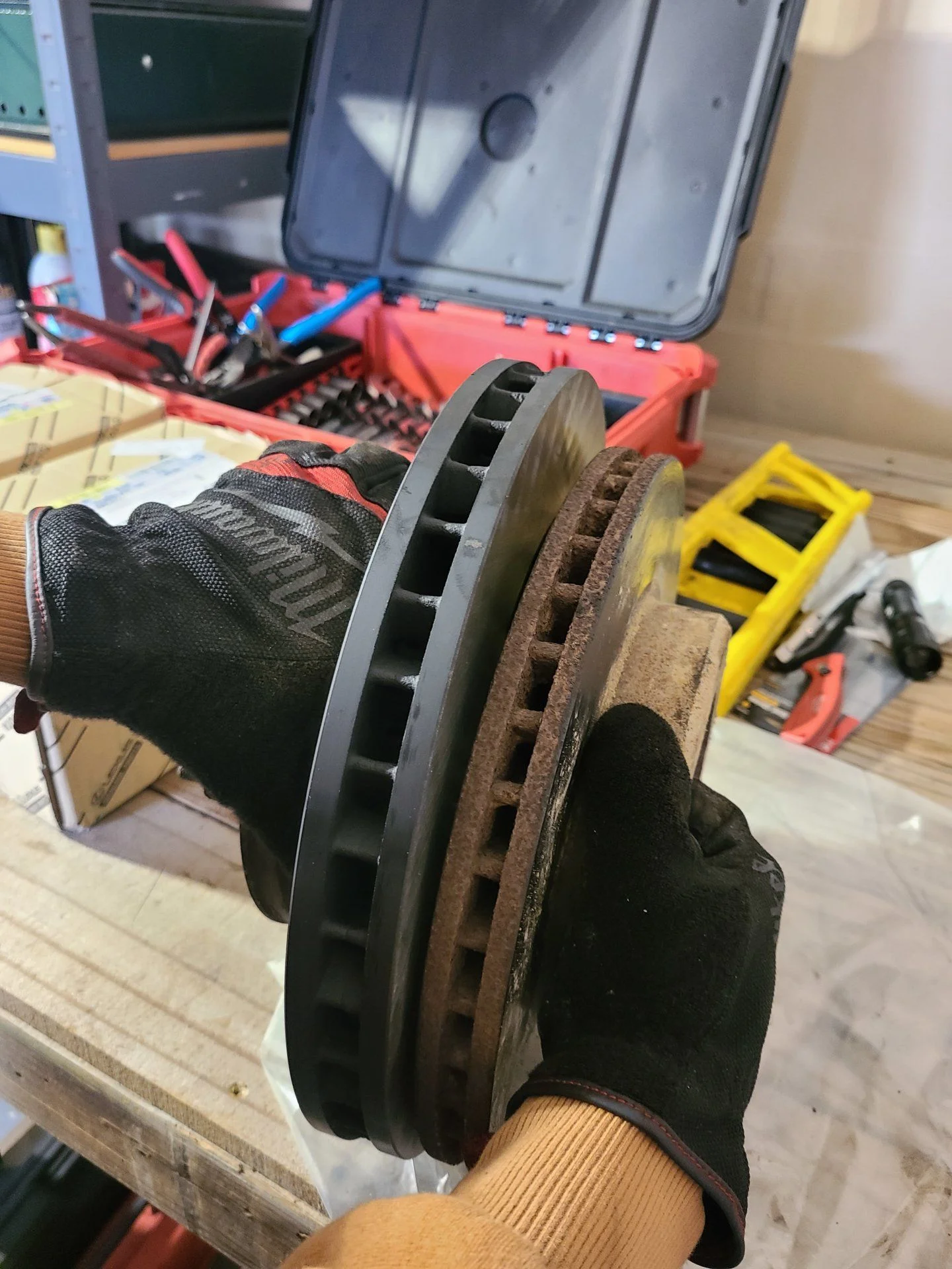

Time to see how different the FZJ80 brakes differ from my FJ80... Only need to do the front axle... well the booster too....
Key note: 93 - 95 Calipers were much more expensive than 96 - 97 calipers...
Calipers are Shiney!!!
I didn't know the front brakes were different, learned something
