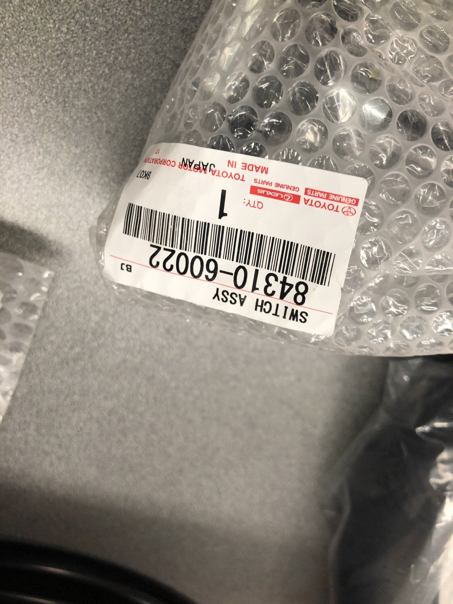

If you need the switch that mounts on the column you can still buy it from the dealer. I just bought one the other day. If you need the relay that mounts under the dash I might have an extra one.

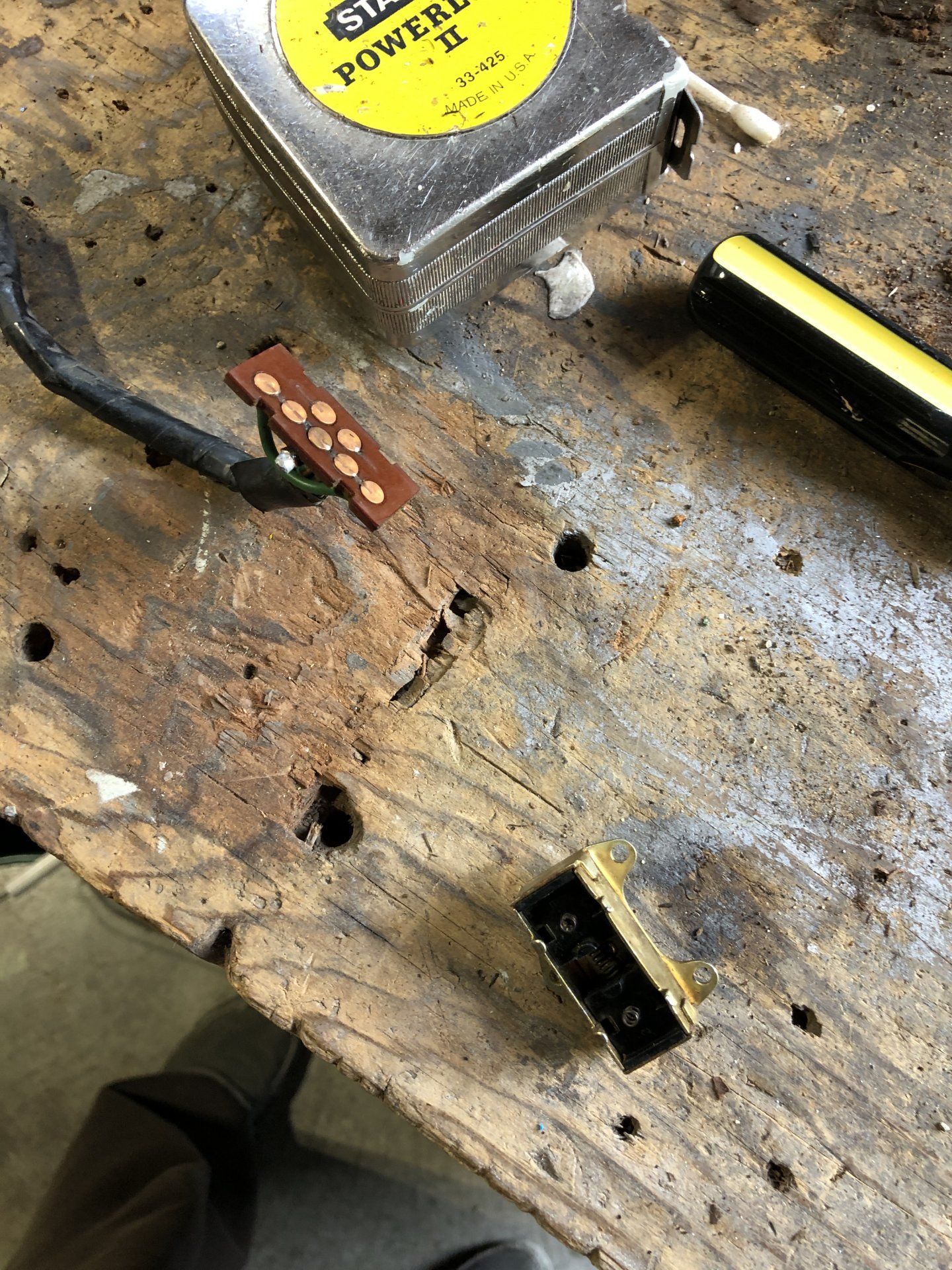

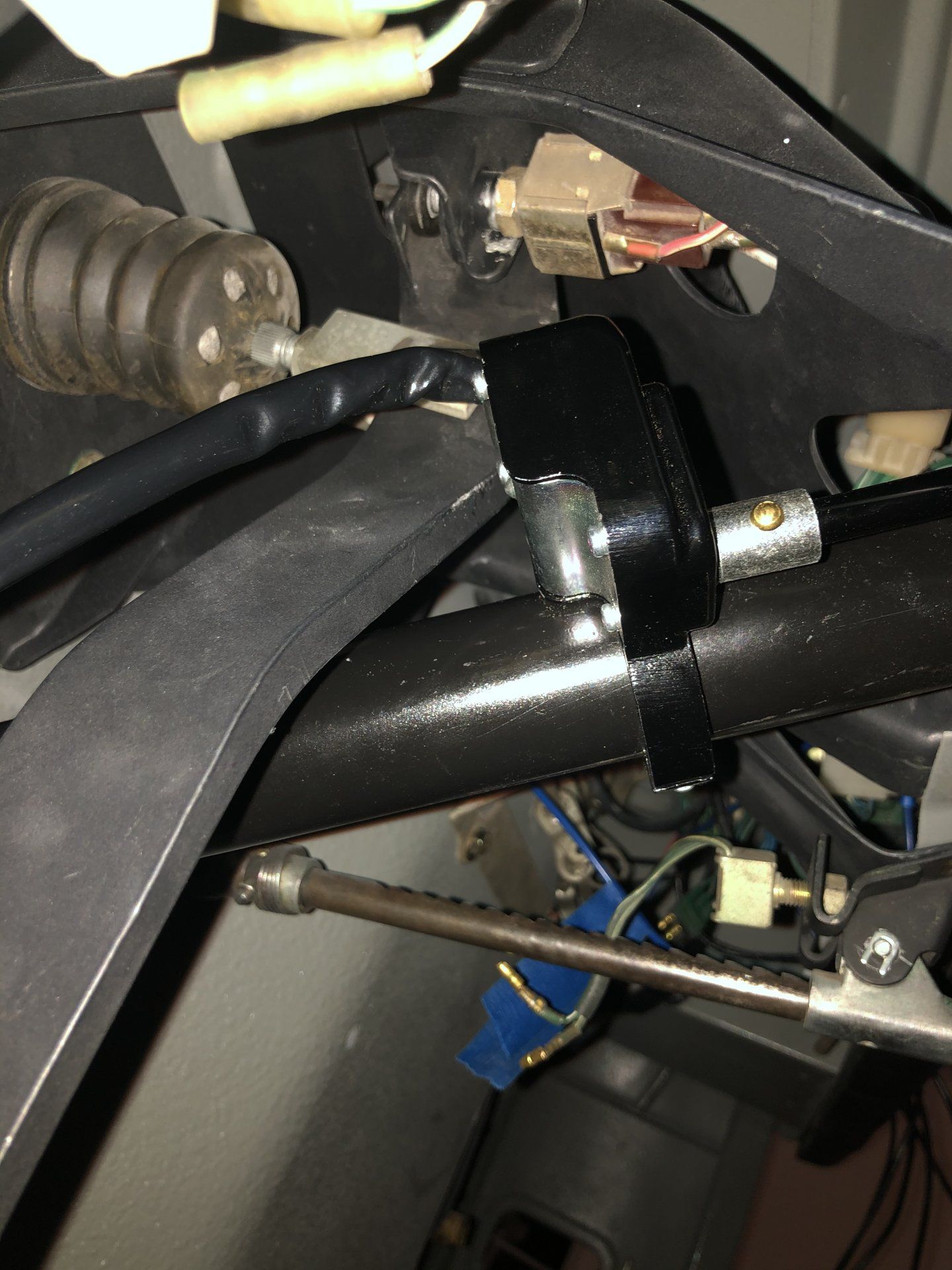

I need this part. Mounts low on the column....I have the signal arm that runs up the length of the column.

You can buy it new from the dealer.

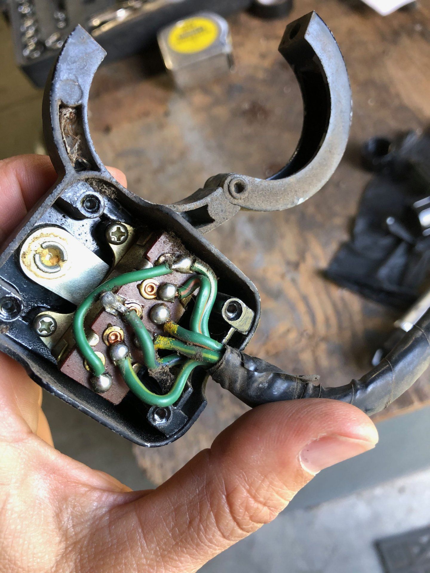

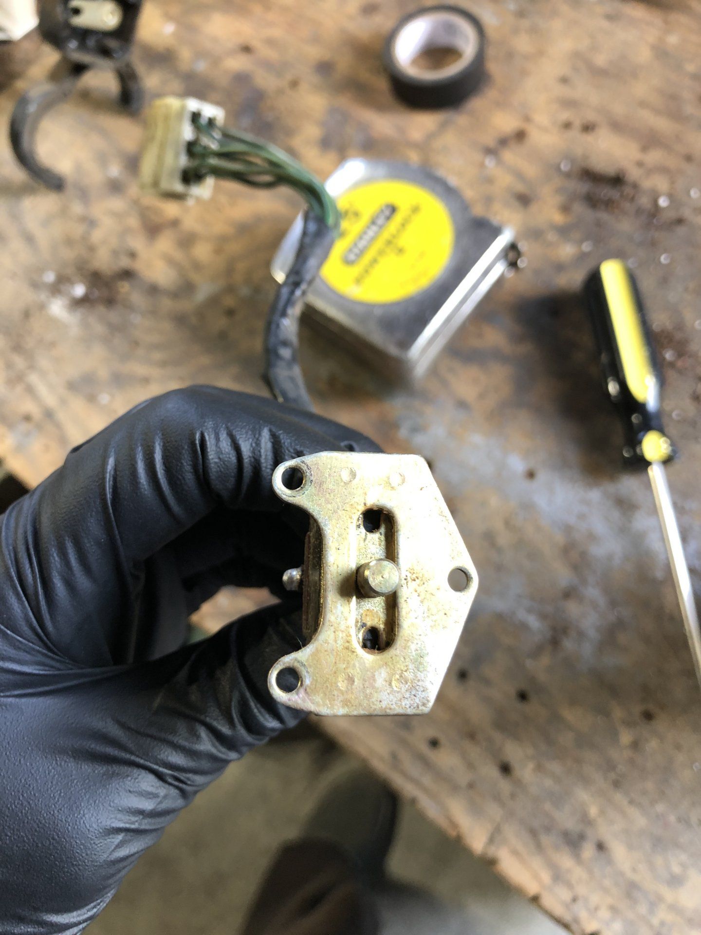

I have the same end as yours. The new one comes with bullet connectors so I cut them off and spliced the old connector on.

FYI it could still be the switch. Those switches have to be positioned just right on the column or you will not be able to get the lever to go all the way left or right. Test this first by removing the switch from the housing and trying it full left and full right. If it works, you know you need to play around with the position on the column.
