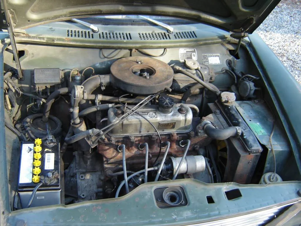

    Location:
    NSW, Australia
    Old Morris 1100....(I think)
    AirheadNut and GTSSportCoupe like this.
  11. gerg
    gerg
    Messages:
    2,943
    Media:
    11
    Likes Received:
    866
    Joined:
    Jun 13, 2005
    Location:
    Centre of the universe
    Hah. I'd love to see a pic of that!

  12. AirheadNut
    AirheadNut
    Messages:
    495
    Likes Received:
    352
    Joined:
    Dec 22, 2015
    Location:
    Whitefish, MT
    Sure enough! Not sure that setup would help much with a turbo 3L, though! :)

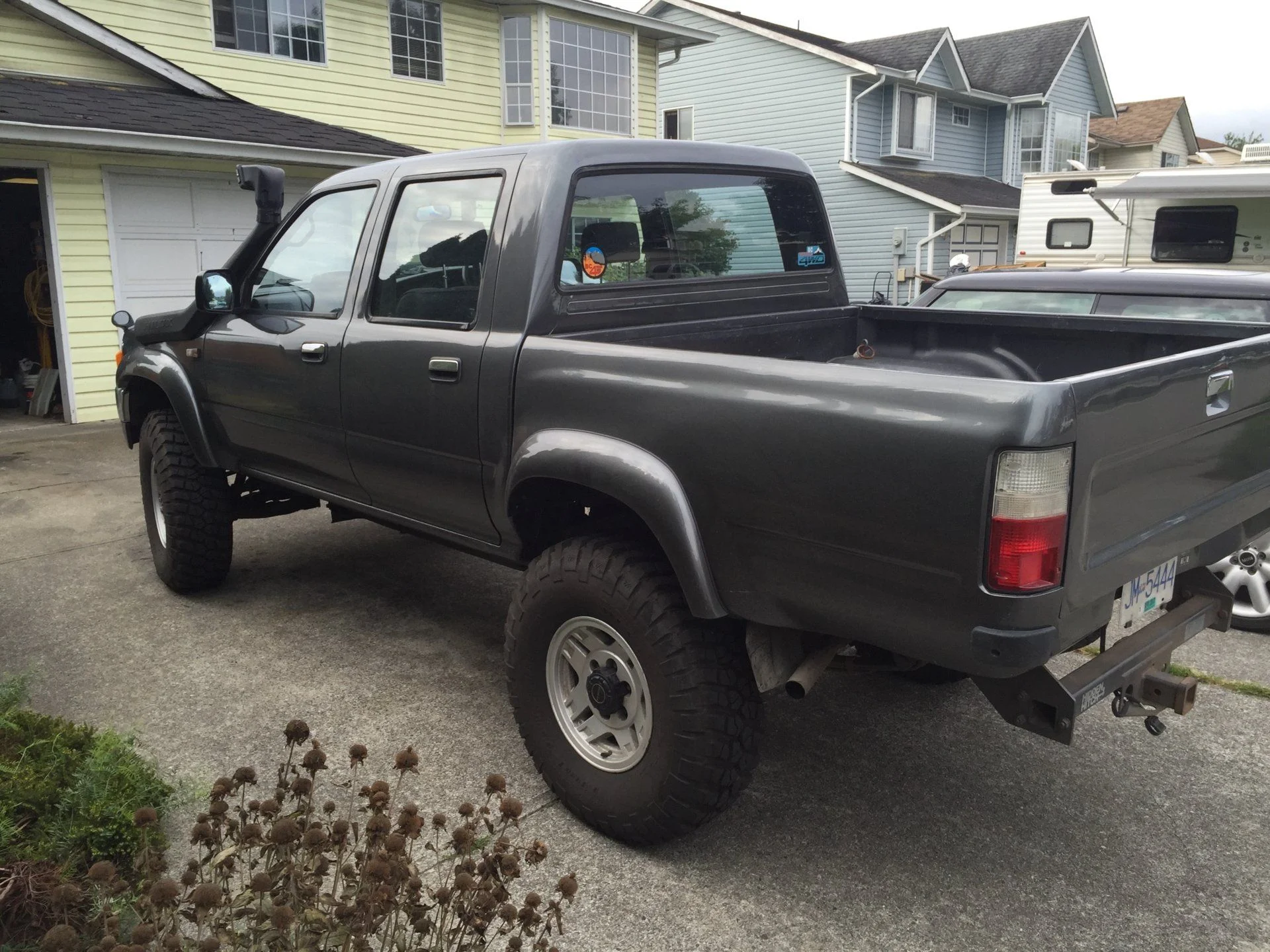

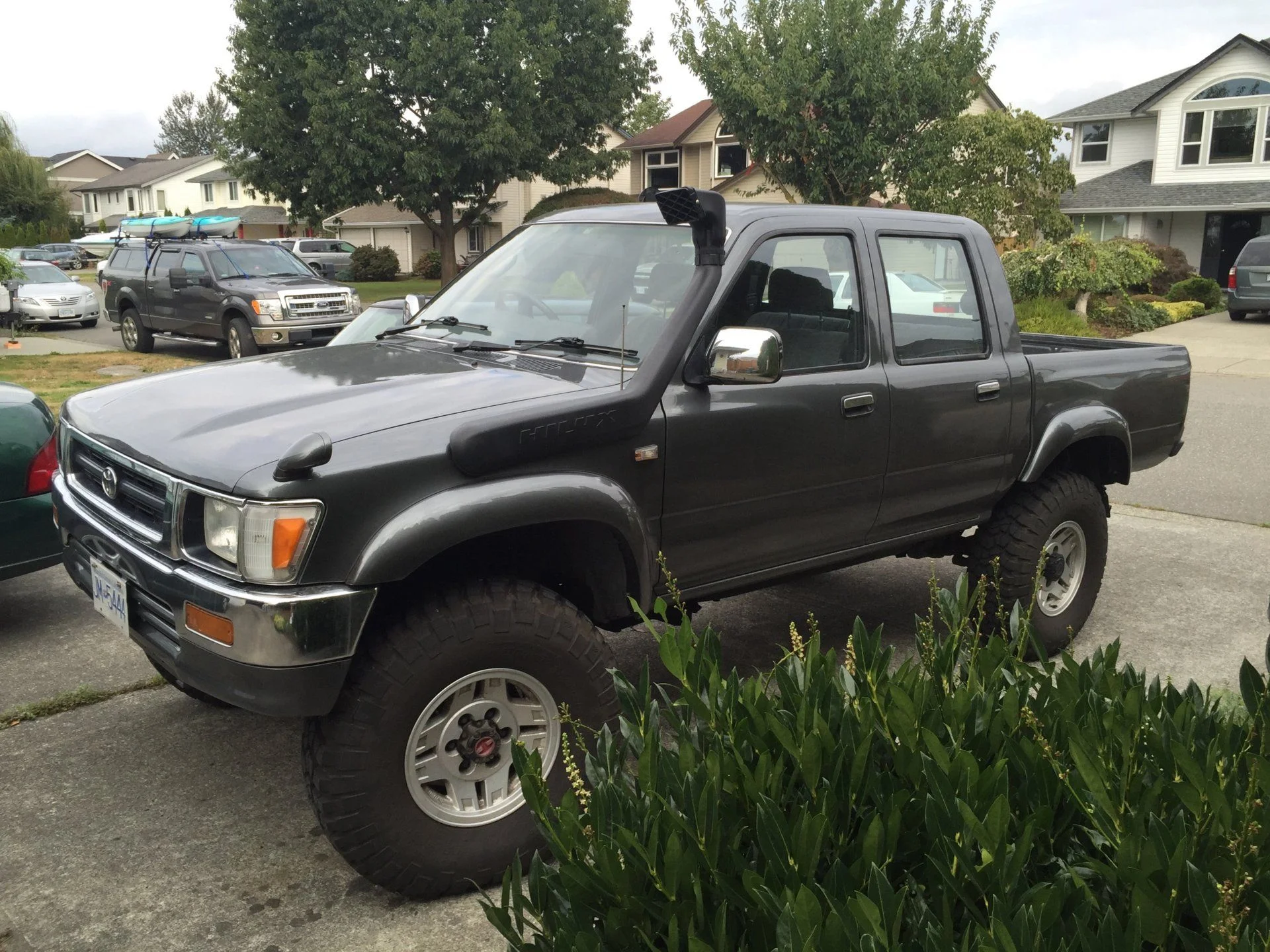

  16. zukin
    zukin
    Messages:
    7
    Likes Received:
    2
    Joined:
    May 10, 2009
    thanks for the info. it doesn't run hot until I hit a hill, though if I have my foot on the skinny pedal it runs hotter.
    I am running the stock fan stroud with the electric fan so it is sealed pretty good.
    another question what kind of boost can I run safely. boost is now at about 5psi.
    here are a couple of pics of my truck.
    IMG_0564.jpg IMG_0563.jpg thanks again.
  17. GTSSportCoupe
    GTSSportCoupe
    Messages:
    4,656
    Media:
    102
    Albums:
    1
    Likes Received:
    1,589
    Joined:
    Mar 23, 2012
    Location:
    Victoria BC Canada
    Nice truck!
  18. AirheadNut
    AirheadNut
    Messages:
    495
    Likes Received:
    352
    Joined:
    Dec 22, 2015
    Location:
    Whitefish, MT
    GTS beat me to it, beautiful truck! An intercooler will definitely help. If you have A/C you may not be able to fit an air to air intercooler, but if you can I would recommend it just because it is a simpler system. I would also highly recommend installing a pre turbo pyrometer so you can keep an eye on engine temps better (high coolant temps tend to be a delayed reaction to sustained high EGT’s). A larger than stock exhaust will also help.
    Not entirely sure re the boost pressures, a stock 2L-TE runs 12psi IIRC on stronger internals, so I would guess that 8-10psi would be perfectly safe, and would also help reduce engine temps if no extra fuel is added.
    GTSSportCoupe likes this.
