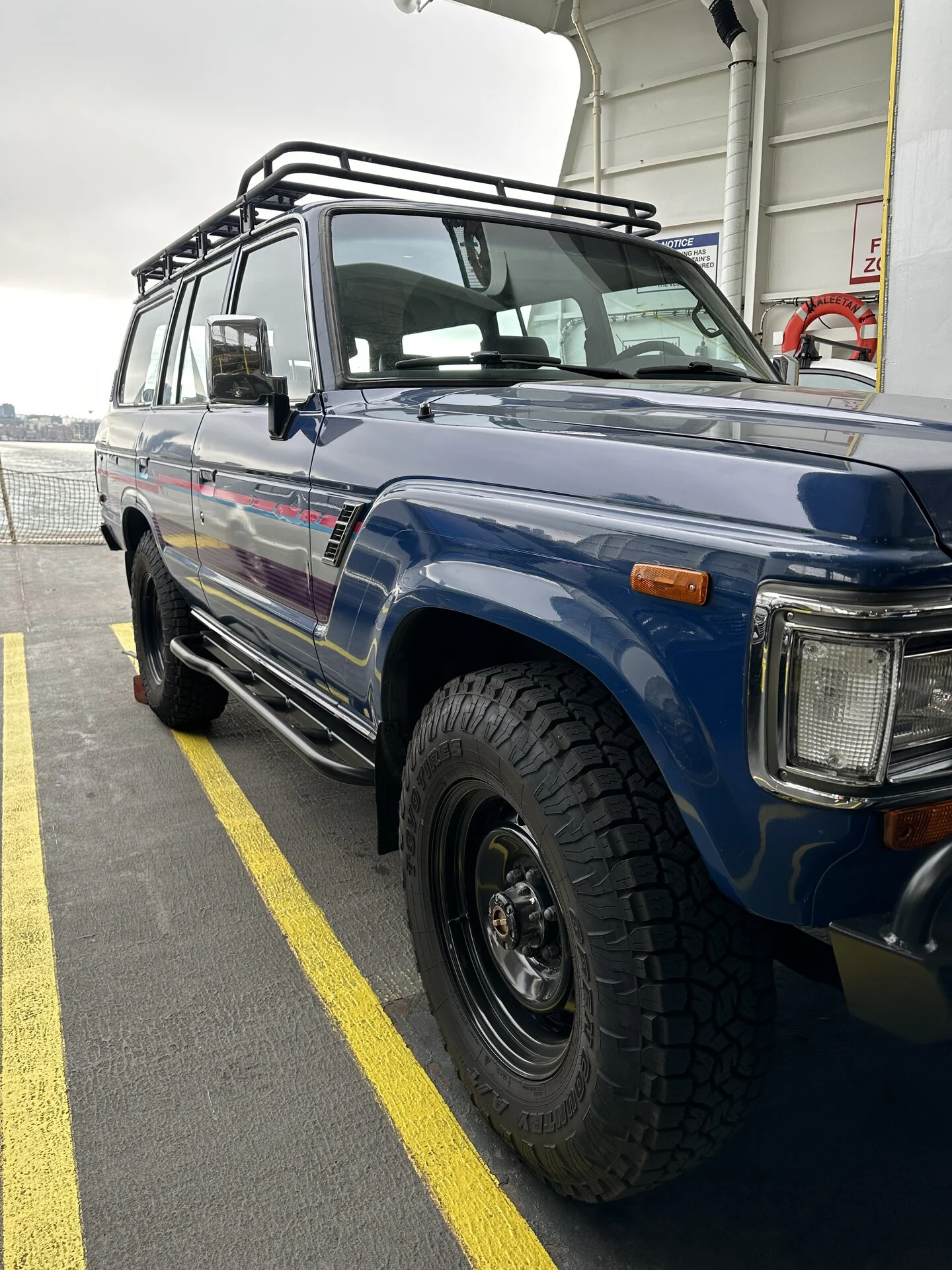

Are you talking the steel tundra wheels? If so yes they fit. You will probably need wheel spacers. You don't need longer lug nuts. The spacers come with their own lug nuts. You first bolt down the spacer with the original lug nuts. Then the spacer lug nuts you bolt the wheel down with. It does add a second failure point. I feel they are as safe as your original lug nuts bolting them down? I used 1.5" spidertrax wheel spacers. Haven't had any problems and have had them for over a year.
HTH
You got the part number for these puppies? I want to Techron’s my wheels but not finding options in California with new laws.
Not sure who you are asking? I got my Tundra wheels from Purefjcruiser.com
Those are the fjcruiser (07-2014) steel rims which I got from purefjcruiser.com. 17x7.5 They do require a 1.25" spacer. I used spydertrax (get the fj40 ones they are the same as the fj60/62)
