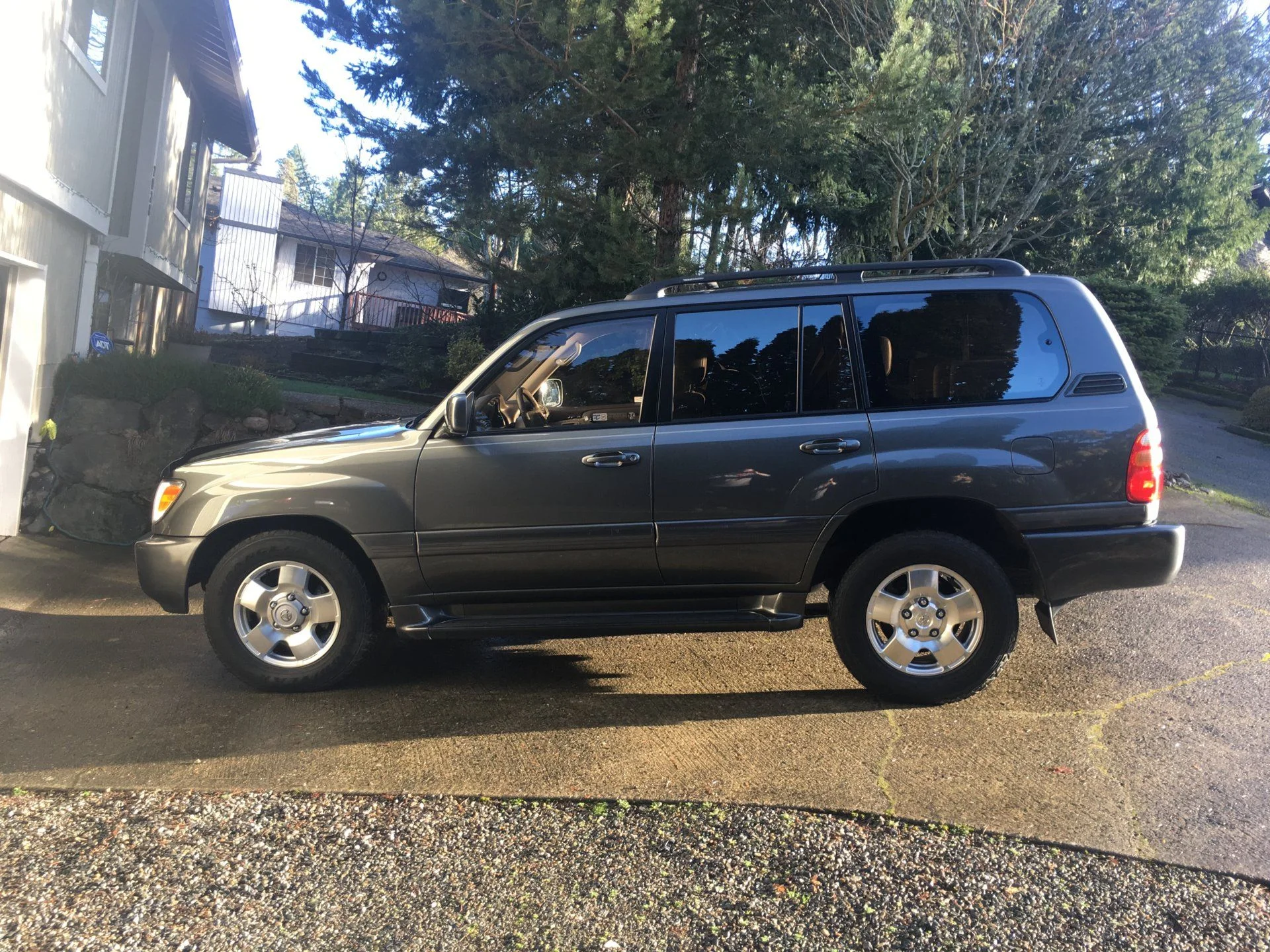

I’ve found a set of Tundra wheels on Craigslist that I’m thinking of picking up. I just want to verify that it’s the same wheels that are in this photo. I am by no means a Tundra wheel expert. Thanks!
Toyota Tundra Sequoia factory wheels
Yes, same.

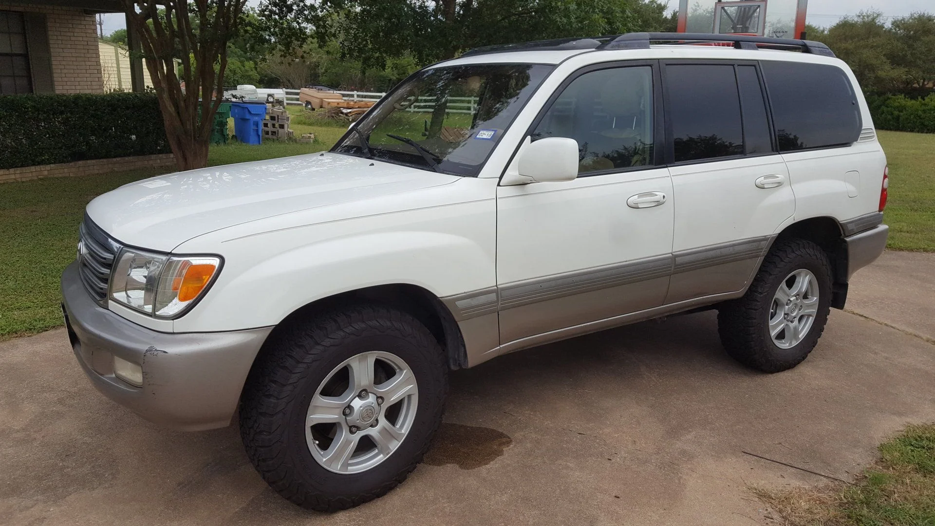

Those are some of the best looking tundra wheels on the land cruiser. I picked up 4 for the exact same price today actually. Won't use them though until I get tires right before summer trips to the mountains. Does anyone recommend spacers with these? Or are they pretty much good to go?
Mine went on w/out any spacers, however I could not use the caps in the front that match the wheel. I had to use the caps from the old wheels which isn’t 100% but looks ok.

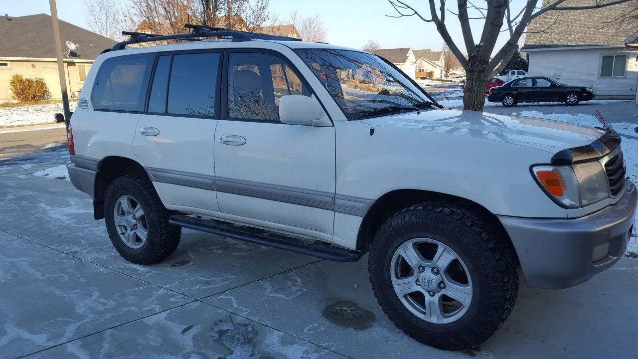

Please note, these are not the same tundra wheels as the ones referenced above but they may work similarly.
All you need is LC center caps to clear the hubs (or you can go without). No spacers required. I’m going to try running 35/12.50/18 KO2s on them with no spacer. We shall see.
I have those same wheels with no spacers and kept my '04 caps in the front and Tundra caps in the rear... I like my setup!
