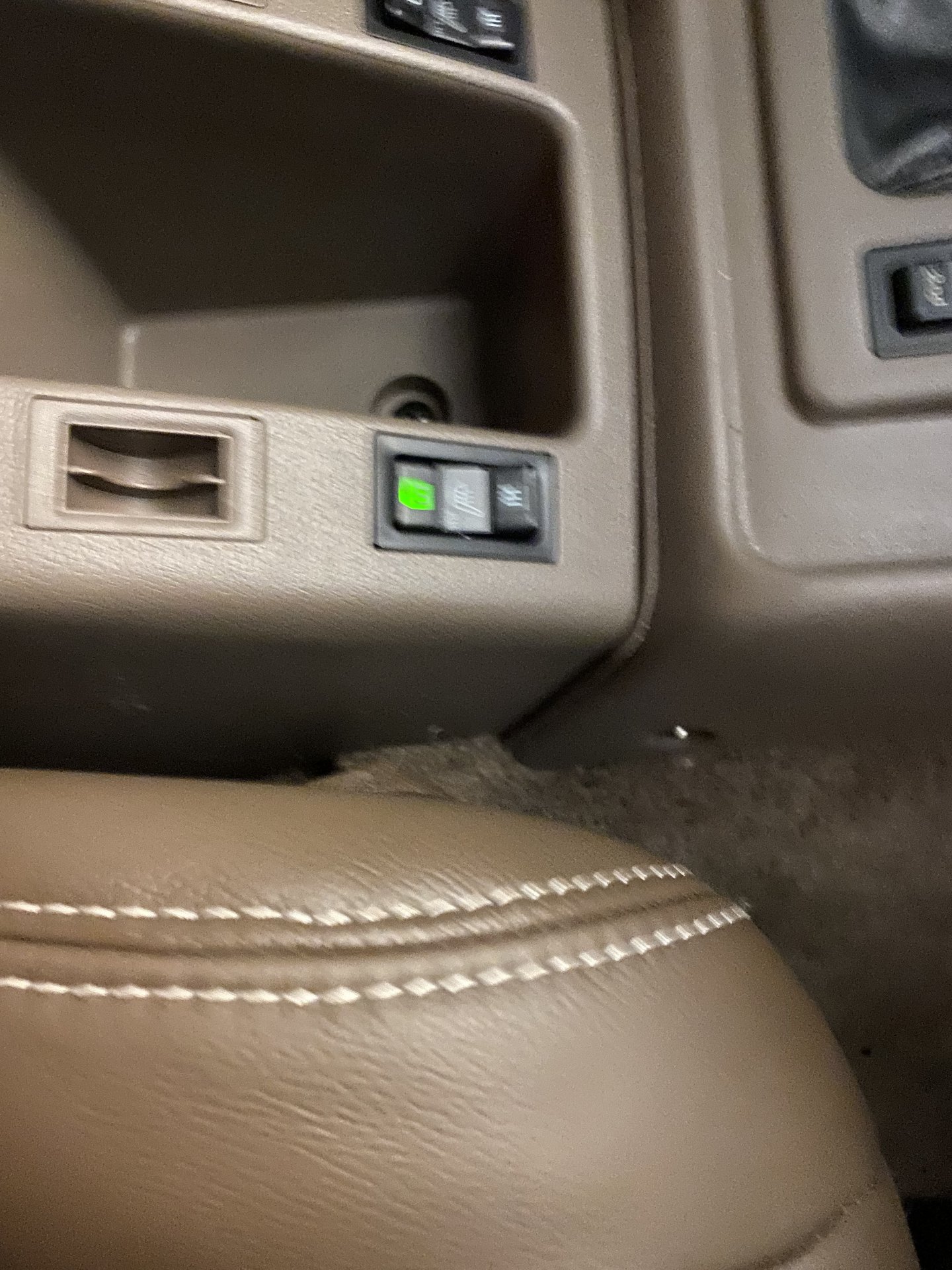

Got the front passenger seat squared away. I did the gamviti gears as the inside one was toast.
I also did the seat heater wiring and wanted to use the factory seat heater switches (this is the way to go) so had to wait on the switches in the mail. Just a FYI I think the later model 80 series have the wiring look for these but I am not sure that the LX450 has it. I used this thread for the wiring.
97 seat heater install with factory switches - https://forum.ih8mud.com/threads/97-seat-heater-install-with-factory-switches.1234843/ and it worked great.
