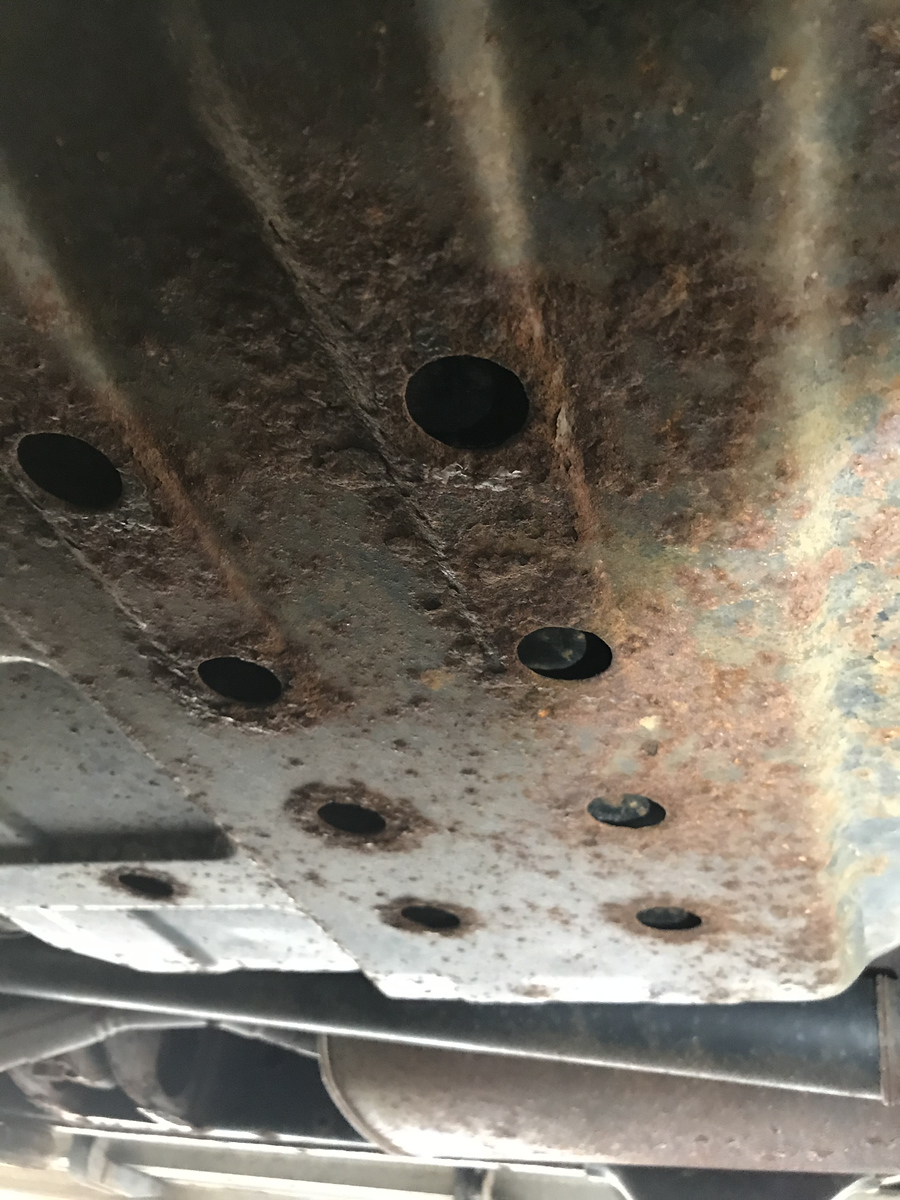

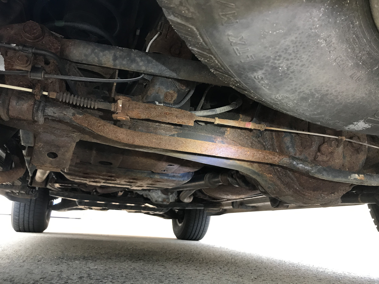

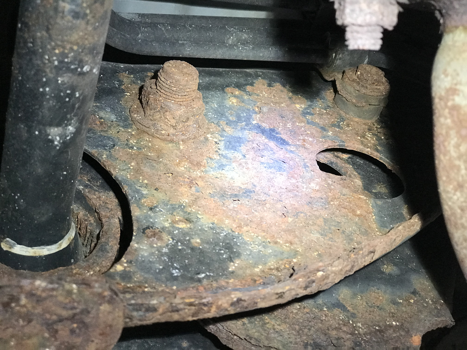

I've recently started searching for a 100 series to build out as an overlander. Found a 2001 LX470 in reasonably good shape with 190K miles. Visually it checked out fine on the outside. All functions are good. TB replaced by dealership, but seller does not remember mileage. But, on the undercarriage, I found this rust. I knocked on these parts with a small hammer and the sound was normal steel. The worst impact of the rust was that the tail pipe behind the muffler has broken off. Seller has owned this rig since 2004 when he bought it with 50K miles. The price is pretty attractive. Should I be worried and walk away?
FWIW, I DIY most everything on my cars and trucks, except for engines and transmissions :) But, I have always stayed away from serious rust repair.
Appreciate your responses.
LOL, that is nothing. I know a lot of us on here are allergic to rust. And I get it, rusty vehicles are much harder to work on, PIIB to build out, etc. That being said, that would be considered an 8/10 if it's a northern rust belt truck.
I feel the same about the mostly surface rust which I was expecting to see in a 20 year old vehicle. Both previous owners have lived in Northern VA within 20 miles of me. I am saying this based on the service records that have all come from the same dealership (first & 2nd purchase) that is down the street from me.

This is a no-brainer for me. that rust doesn't scare me in the east. That is easily fixed by a nice coating of FF or even a rust converter. I would buy that in a second if the price was right and nothing major needed to be done.
I would corroseal, let it cure than do a nice thick app of fluid film. That;'s exactly what I'm going to do in the next two weeks
How much are they asking?
You aren't too far from me- my truck is worse underneath but we have a few very good LC shops in the area, plus I see ads for rust remediation and treatment from other companies as well. It comes down to prep and how much $ you want to spend really.
For a rust belt/east coast truck, that's not terrible. If you are willing to buy from the west side of the country where we associate rust with the Titanic more than a road-going car that people drive, that would be considered unusually rusty.

Yes. DIY is the plan. Most of what I saw was on removable plates and such. I can take them off, wire wheel them and treat appropriately. In a previous Jeep LJ build, I did use POR-15 and FF to treat and coat some small parts. So, I am somewhat familiar with the process.
Excellent, so what's a good guesstimate of materials cost? If it is less than 5% of the asking price, it is probably a very reasonable part of a counter-offer
