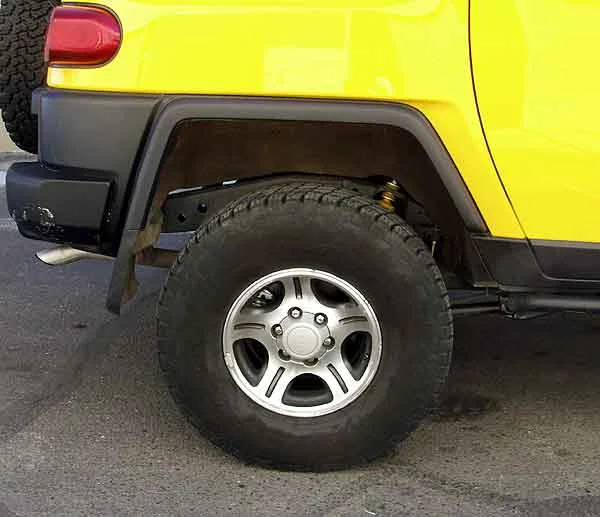

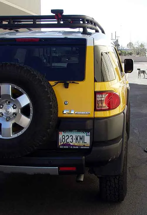

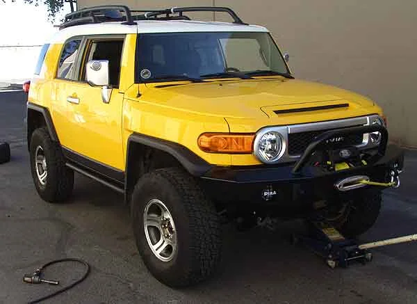

Nope don't fit, the calipers rub the spokes on the front wheel. A 1/4-3/8" spacer looks like it would solve the problem, rears fit fine. Offset, UCA clearance, etc looks good.

As Kevin said, rims didn't quite work, but the 295/75/16 tires had room to spare. It was kinda funny - Kevin wanted to just bolt the rims on one side and shoot photos - I decided to be a pain and wanted to drive on 'em:idea: . They bolted up fine, but kinda compressed my front caliper so I couldn't drive the vehicle:eek: . Did manage to take some nice metal shavings off the back of the rims tho':whoops:

Glad to know the tire size fit fine. Would there be a clearance problem on the body mount with spacers or is your's already chopped by now?

I have not yet done the body mount mod, and with your Daystar lift I would expect no problems for clearance. The tightest spot I saw was up against the UCA forward (I think) with the wheel turned full. Another clearance concern might be the rear window over the tire;)
