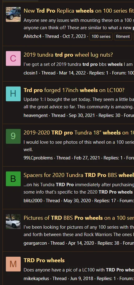

I searched "trd pro wheels", titles only, 100 section only.
