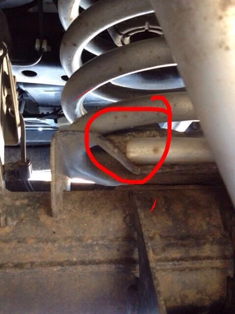

I just watched the video that was posted. It seems to be coming from the rear suspension. That sound is awfully familiar of a spring shifting in the coil bucket. My guess is the spring is rotated and is shifting slightly when there is weight transfer. That is too loud for a shock mount, there isn't enough speed or weight transfer to ram the shock mount and make that sound. I'm betting rear coil right now.

The rear control arms (both upper and lower) appeared okay with bushings looking intact. The one thing I did notice after reading 2000UZJ's post is that the Passenger Side coil isn't seated against the stop on the lower mount. Doesn't seem like it's off that much (pics attached). Any thoughts?
Driver's Side:
Passenger Side:

Rotate the driver side spring. That is the only thing I see that could cause a pop sound. Any weight transfer on that spring will cause it to shift or pop. Since it can't rotate due to the weight, the edge of the coil may be rubbing. Total speculation, but springs shifting make a loud pop similar to your video.
See video (grabbed link from mobile YouTube). You can hear the spring popping quite badly. Similar sound to yours, just much worse.
