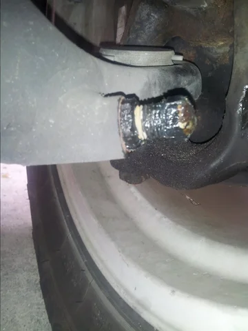

I spent a little bit this morning trying to safely loosen front end components that might cause this. After an hour or so I was able to duplicate what I think is your pop.
Mind you, this is what I created this morning. It sounds exactly like yours. It is much denser or heavier than the sound of a poorly sitting coil spring, in my opinion. It was also repeated four or five consecutive times while making an elevated full turn to the right under slight acceleration.
The turn stop on the passenger side has likely loosened itself (coming outward). My retaining nut was about a 1/8" from the lower control arm. During the hard turn right, the loose stop makes contact with the receiving knuckle creating a fraction of movement in the stop itself but not the knuckle. This movement, even thought minimal creates the hard sounding metal on metal pop.
My solutions, hopefully yours too: Tighten the stop inward (increasing turn radius) using the retaining nut to secure it in position, add a little grease to the knuckle and stop itself. Be sure to check for any rub issues from your tires after adjusting.
You should be all set.
*I wish I had recorded my pop before I greased it. Sorry but it was an after thought.

Well...it was the passenger side steering stop. Joe at Slee showed me where the stop was rubbing, added a little grease and we couldn't duplicate the noise.
Why have I not noticed it before? A habit I got into with my old 3rd Gen 4Runner on 35s was to never turn to the stops because of the rubbing I had due to not trimming enough in the wheel well. I never went to the stops in the 100 due to that force of habit until my wife mentioned the noise and I tried to duplicate it.
