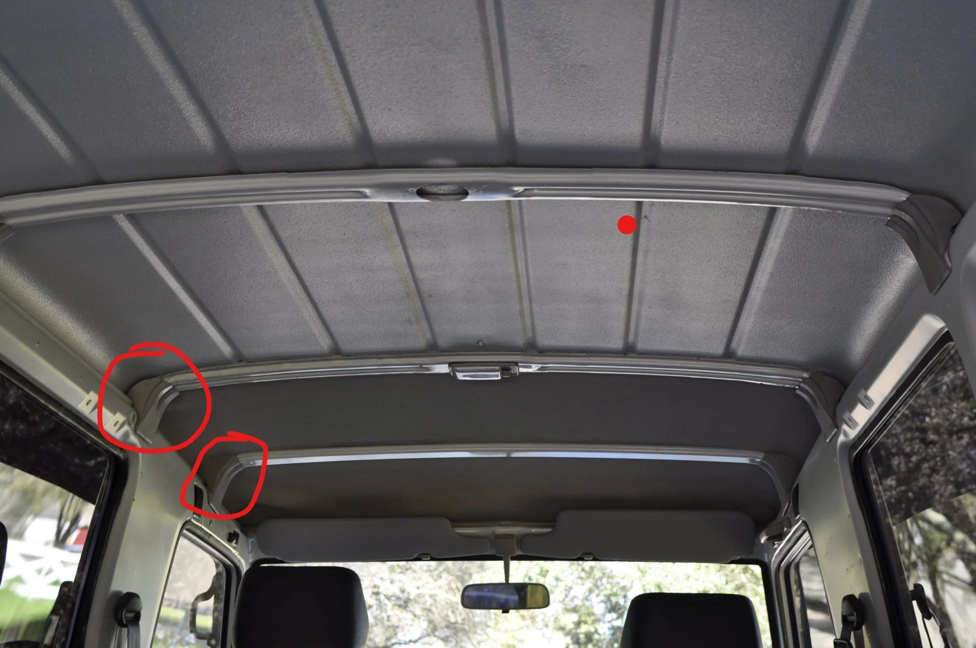

I'm in Virginia and my Troopy failed inspection in Dubai because "FIX INSIDE ROOF PANEL COVER MISSING" This is factually true, but it is a bit eyebrow raising. I thought I would try to just reinstall factory coverings, items 11A, 12A and 13A below:
But when I look at a photo of the roof I get confused...
Do the factory pads not line up to the roof cross-members? I understand the cross members come out so the pads could go under them.
Advice, as always, will be very welcome!
This is kind of important because the Road Transport Authority in Dubai said they won't process any more paperwork for my agent until I get my registrations current, and I can't do that until this thing is sorted.
@John Young - I believe "11A" and "?" are the same pad. I will see if I have some pics and PM you. Yes, all the crossmembers come out easily. Take out the "garnish", unscrew some bolts, and pull down. Easy.

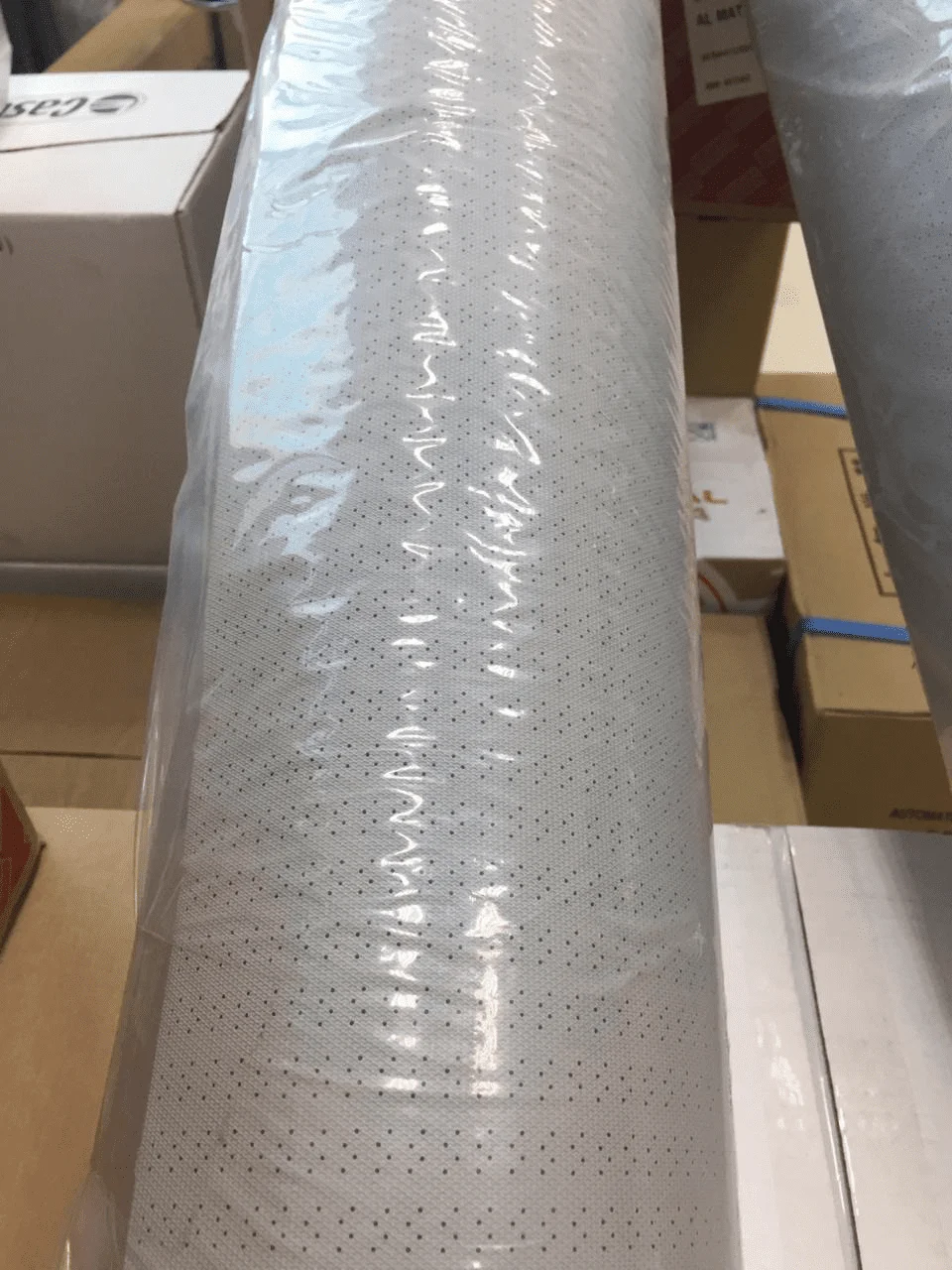

Jan, et al.,
My excellent parts guy in Sharjah, Ryan at Al Mater, succedded in getting 13A and 12A.
From this it looks to me as if this is just flat sheet goods with now complicated moulding, and that the 13A piece (which appears bigger) could be cut down and made to fit in the 11A spot. Perhaps one of you who has actually fiddled with this stuff first-hand would know, is there any reason why we can't cut down a 13A and use it in the front?
