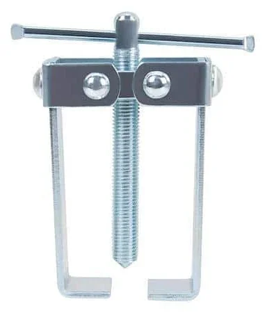

I have something like this (timing gear puller) and that's what I would try next.
Great idea! I have a collection of pullers, I'll give some of them a try. Thanks again.

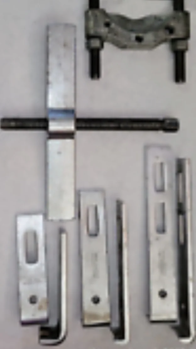

Who makes that puller? I don't think I have ever seen one in my years wrenching.
It is a set from Proto - I bought it because it is the perfect tool for removing gears on the transfer case front output. They're expensive, but I found a used one on ebay.
