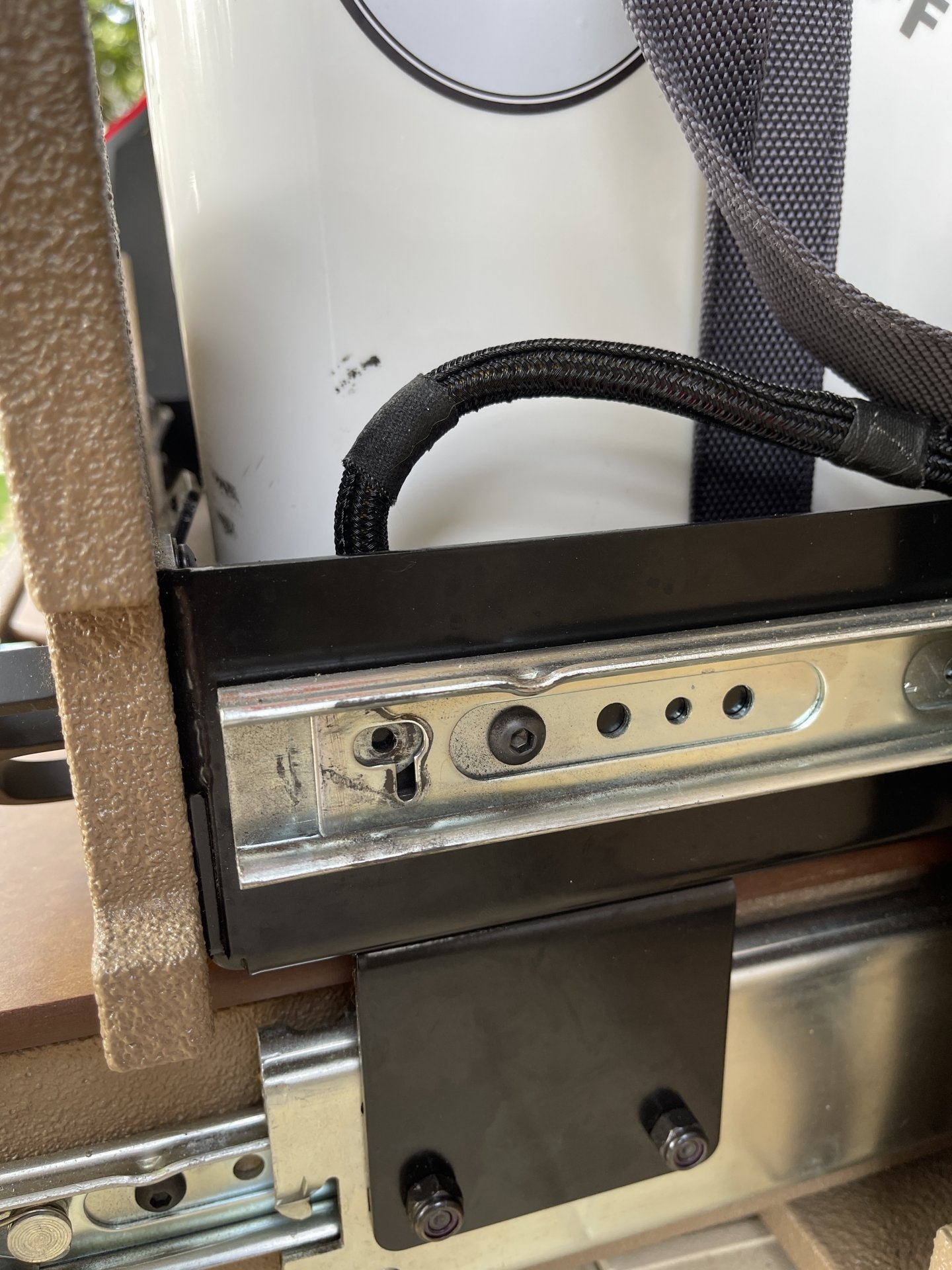

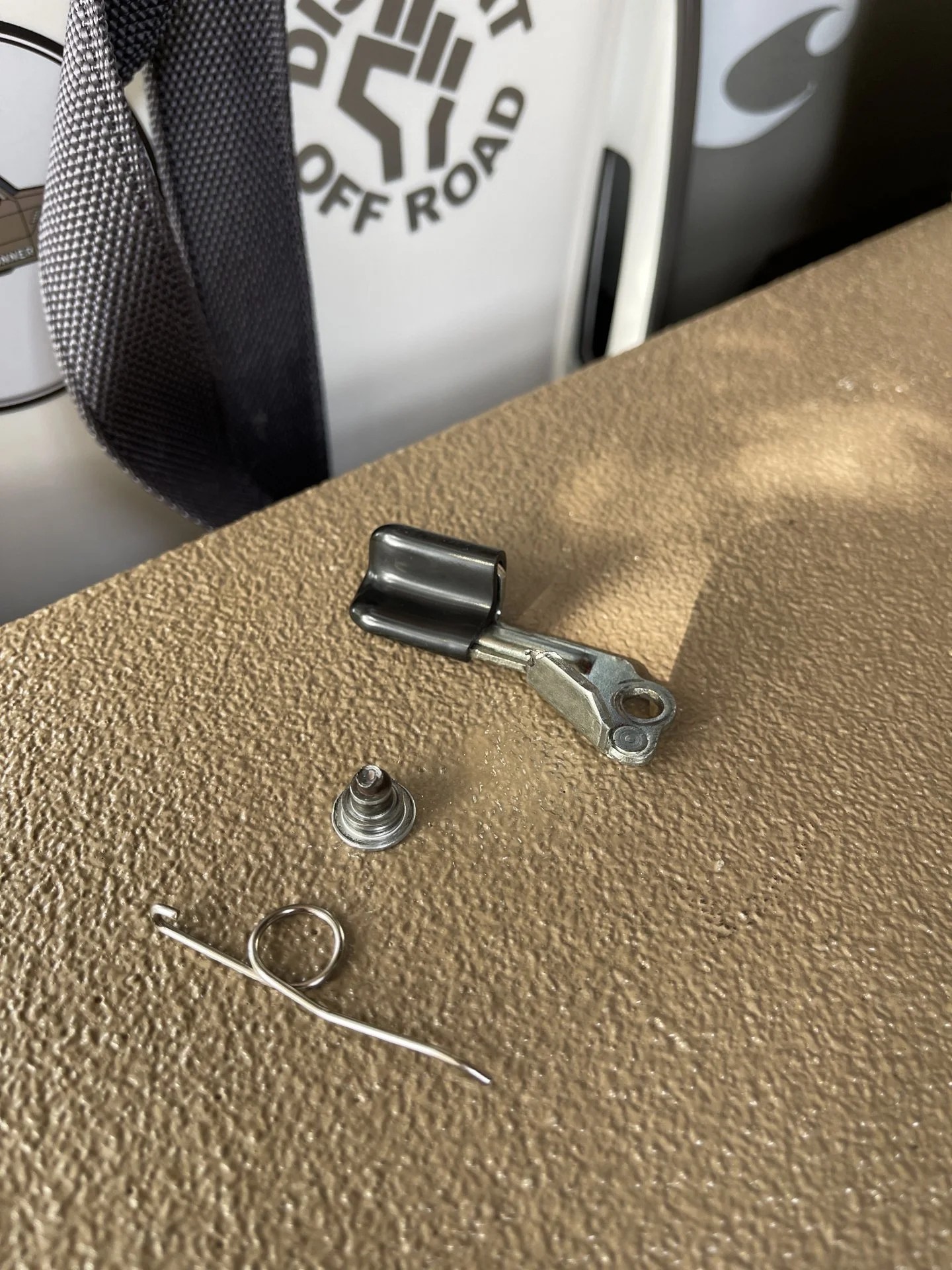

I second this. I have the base alpha and the same experience. I did, however, find one weakness in the latch design recently. This happened two weeks ago...

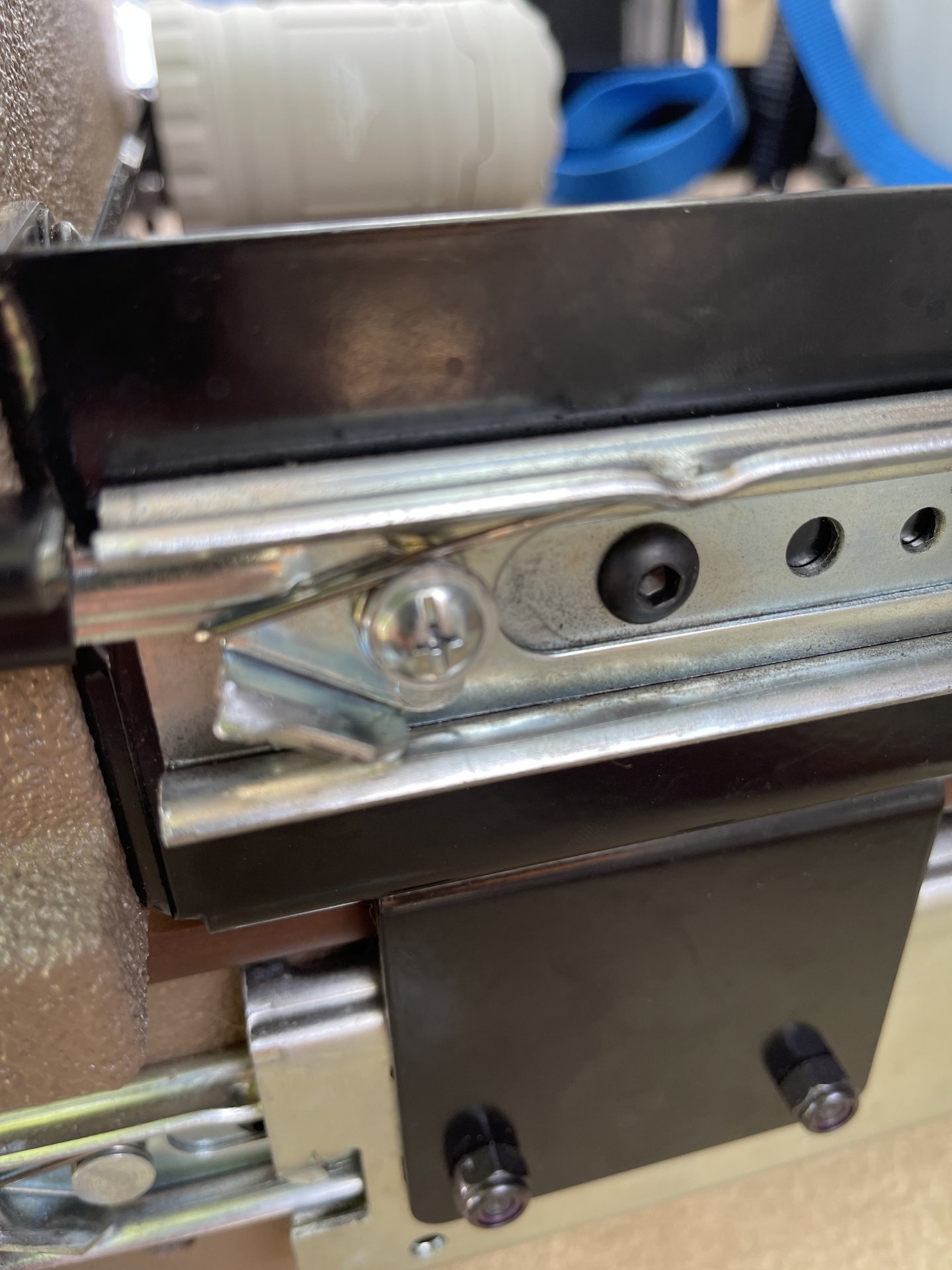

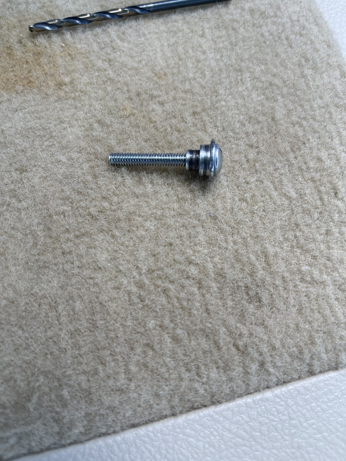

I was able to drill out the latch retainer and found a small bolt that fit nicely. In the end, I think It's a better solution than the thin metal rivet holding the latch retainer. So you might want to hold down the latched when you shut your drawers and avoid unnecessary stress on the retainer when closing.

Contact David if you haven’t already. That may qualify for a new slide based on Accuride’s warranty.
I did and I do. David said this was a first for him. Apparently I'm pretty hard on my drawers 🤷‍♂️! He is going to send me a couple of spare latches. You can't really see in the pictures I posted, but that latch surface is heavily worn. I actually prefer the threaded bolt solution because I can now swap out the latch as it becomes too worn. For the first year with these drawers this was my daily driver for work and personal. I probably put several years of equivalent weekender use into them.

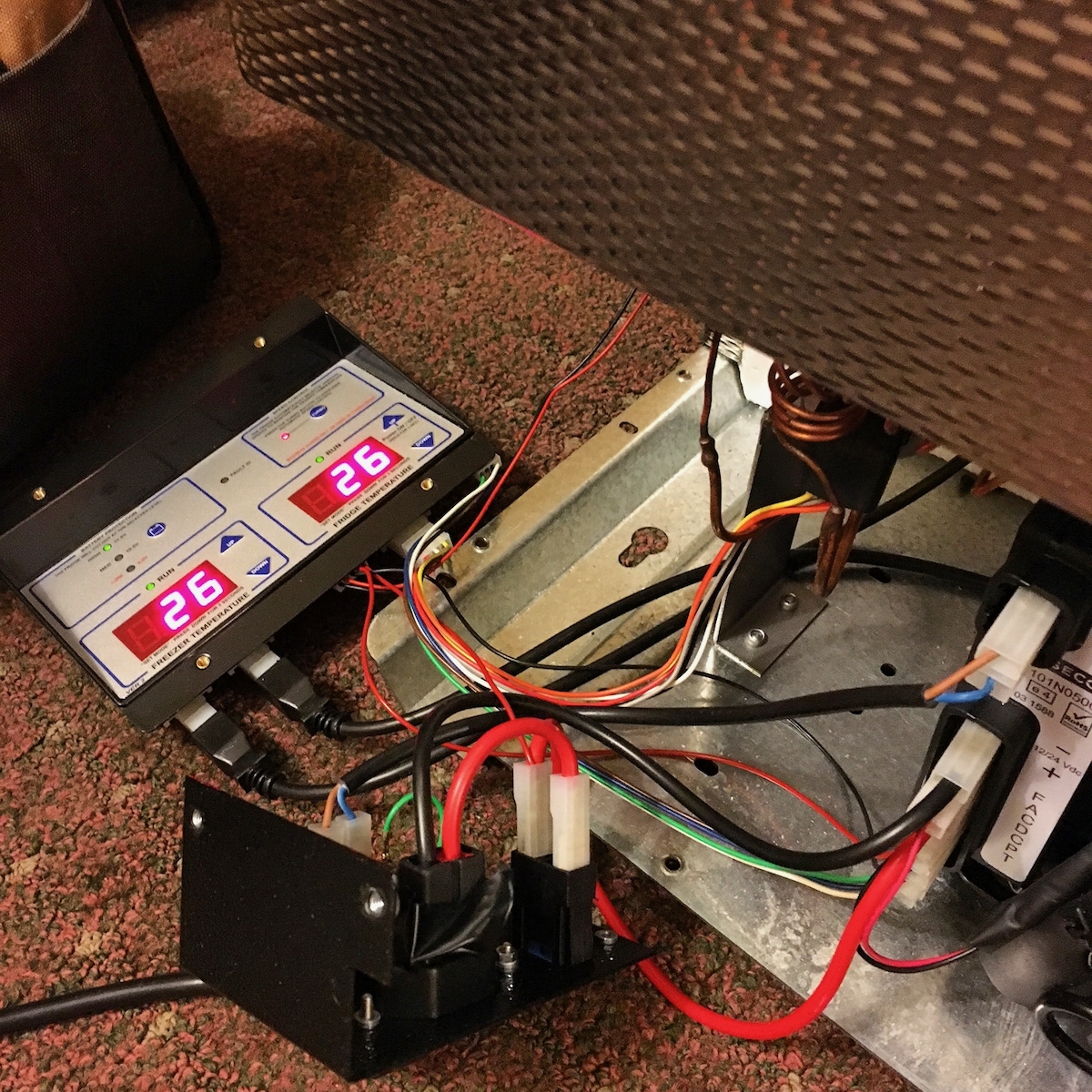

Take the cover over the power cord side off and see what's touching. I bought mine as a demo fridge out of a Conqueror trailer show unit at the showroom in my home town for $1000, while Paul May had them for $2700; a deal I couldn't turn down! Ended up failing a few months later, and despite Paul going way above and beyond trying to get it covered under warranty, in the end, it was a South African version and I was on my dime. Dave from Conquerer (now a Kimberly trailer importer apparently) ended up trading for a brand new unit!
The point of all this rambling is that I had the cover off and there are some small copper coils that looks like they could be persuaded to move a bit without damaging them. Might be all yours needs to quiet it down.

Photos removed from reply but I had the same issue a while back. David had my drawer slide replaced under warranty. It was not an easy install, had to take most of the system apart, but I got it done.

This makes me feel better. Looking at how little material holds the spring/latch retainer I was surprised to hear this was a unique situation. The issue seems to be compounding. As the latch wears, it begins to hit the catch at an angle forcing additional stress on the retaining rivet. Definitely room for an improved design. Beefier retainer and hardened latches would help a lot.
A friend in the industry said there seemed to be a run of slides that had the same issue. Hopefully the replacement lasts forever.

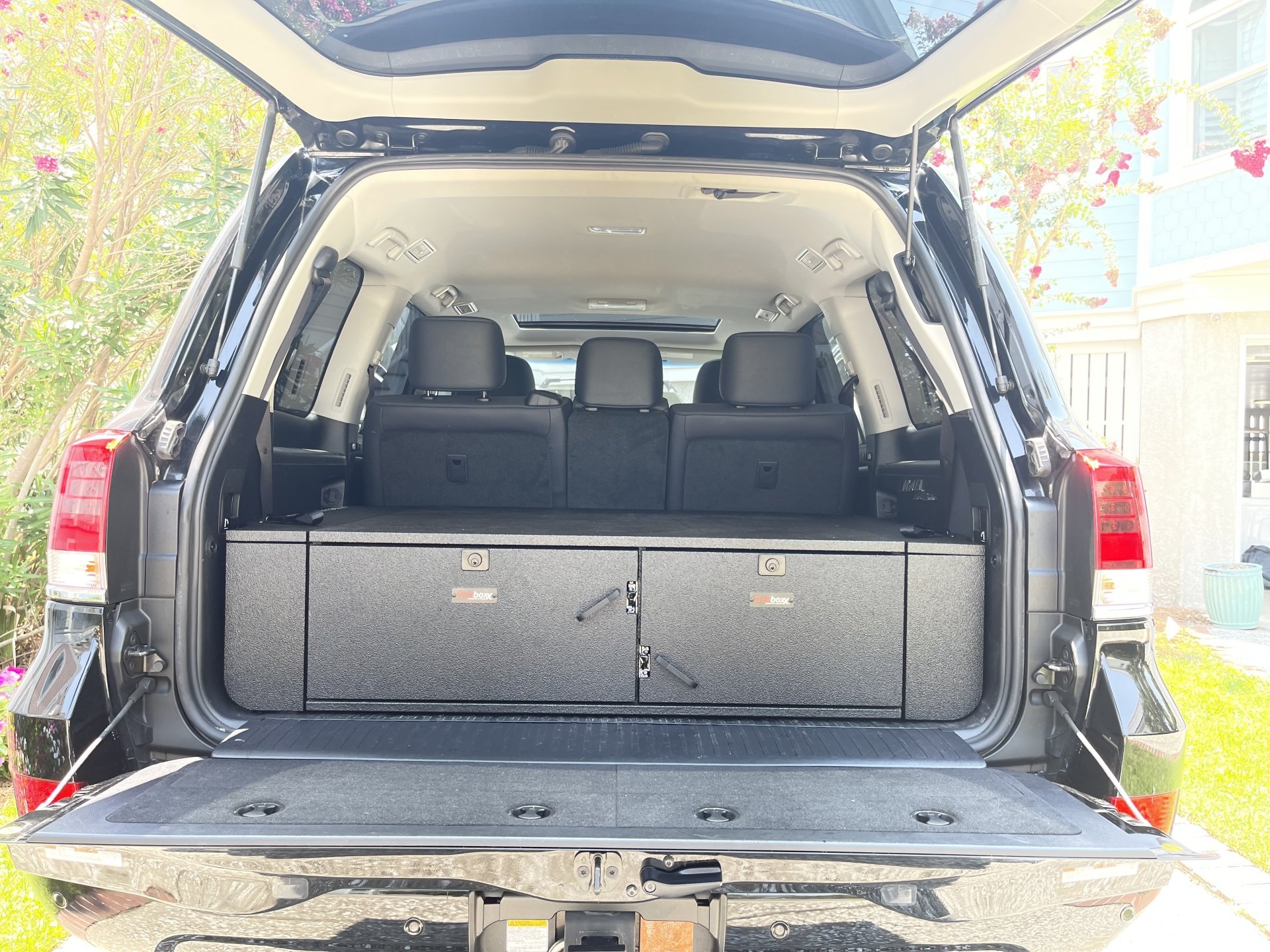

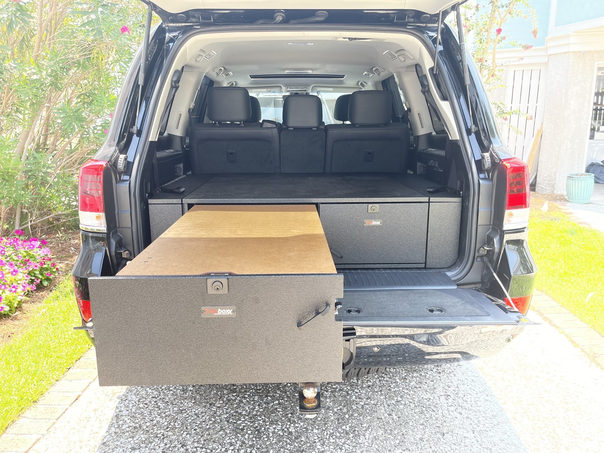

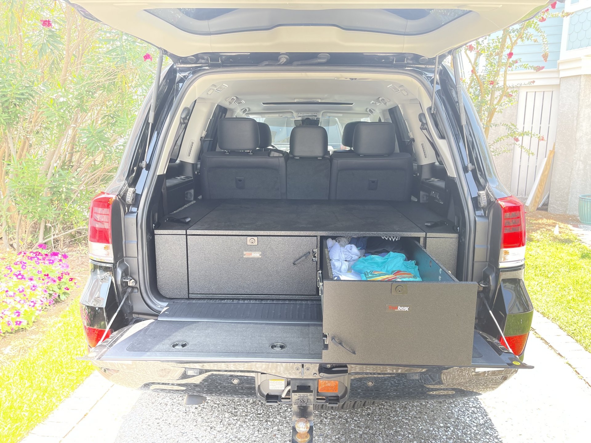

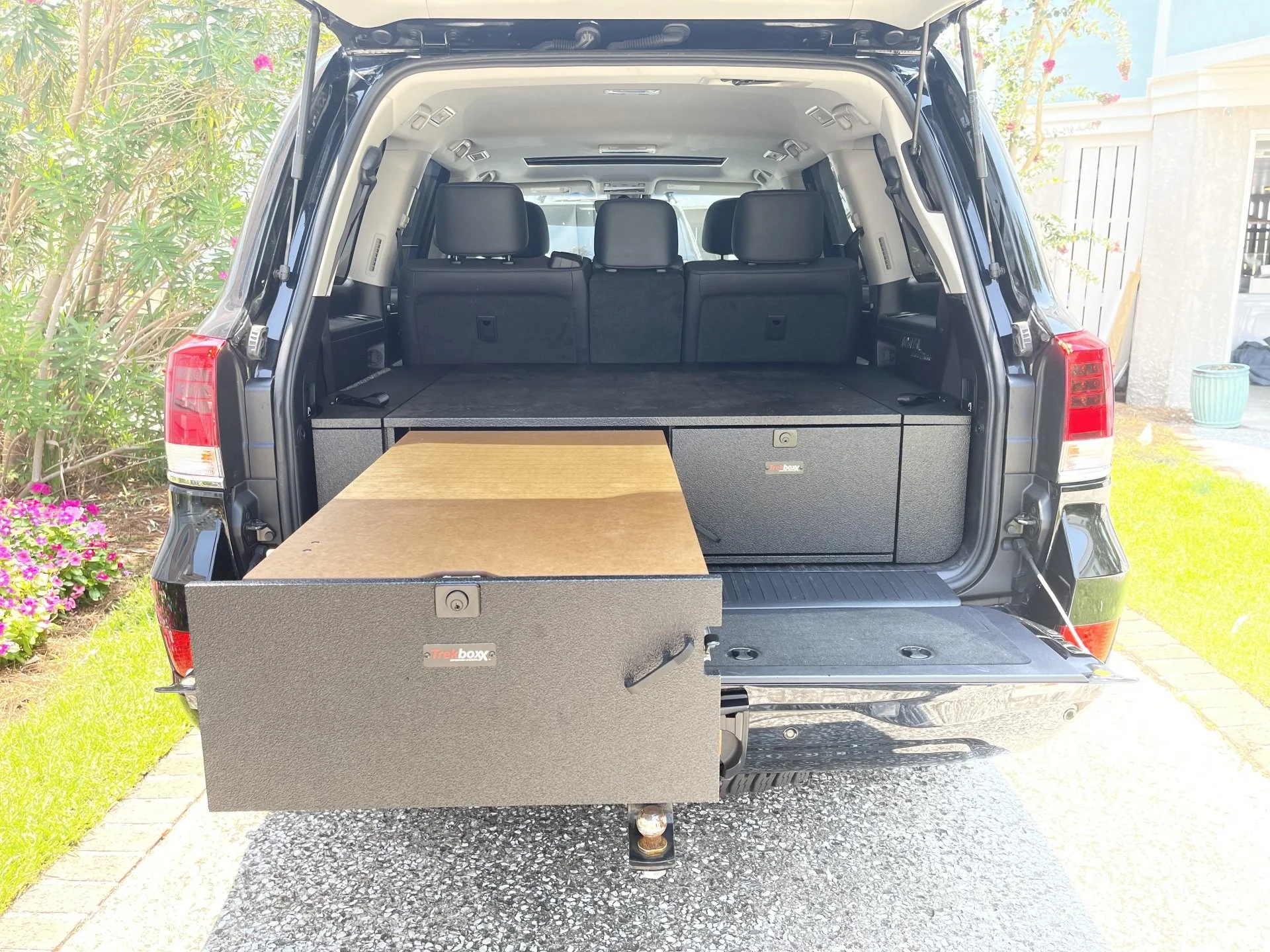

I installed my system yesterday. It took about an hour, not two. That included about 15 minutes to disassemble the shipping crate and unpack everything.
It was shipped to my office and I installed it in 90 degree direct sunlight with no shade.
A few things off the top of my head:
I didn’t realize the system was bolted to the pallet. I’m not sure it said that in the instructions or I didn’t see it.
Installation of the wings and the front two side valances was the only thing required. The whole system was otherwise assembled.
Installing it in the truck required four brackets which bolted into the third row seat bolts. The instructions said to leave these hand tight and then get the system bolted into the brackets and then tighten them.
However the front (as in front of vehicle) two brackets are basically impossible to reach with a tool once the system is bolted in. I personally would tighten the front two brackets all the way before putting in the system if I did it again.
The rear (near tailgate) brackets can easily be tightened with the system in place.
The system has holes and then you use four bolts that attach it to the brackets.
I would note that it is very difficult to see to attach these bolts. You access them by the second row seats which you have to flip up. The two closest to the front of the vehicle are pretty easy.
The two toward the rear are almost impossible to reach. I’m 6’2” and it took my entire arm length to reach them. But once in it was easy enough with a ratchet.
The quality of the system is great. I had to wait 6 months from the date of order due to supply issues with LineX. It was worth it.

Looks great! Yeah, it's a reach to the front (rear) bolts. I will be adding an access panel to the back of the drawers in the near future. Once we can come up for air after getting through this backlog due to the shortages.
