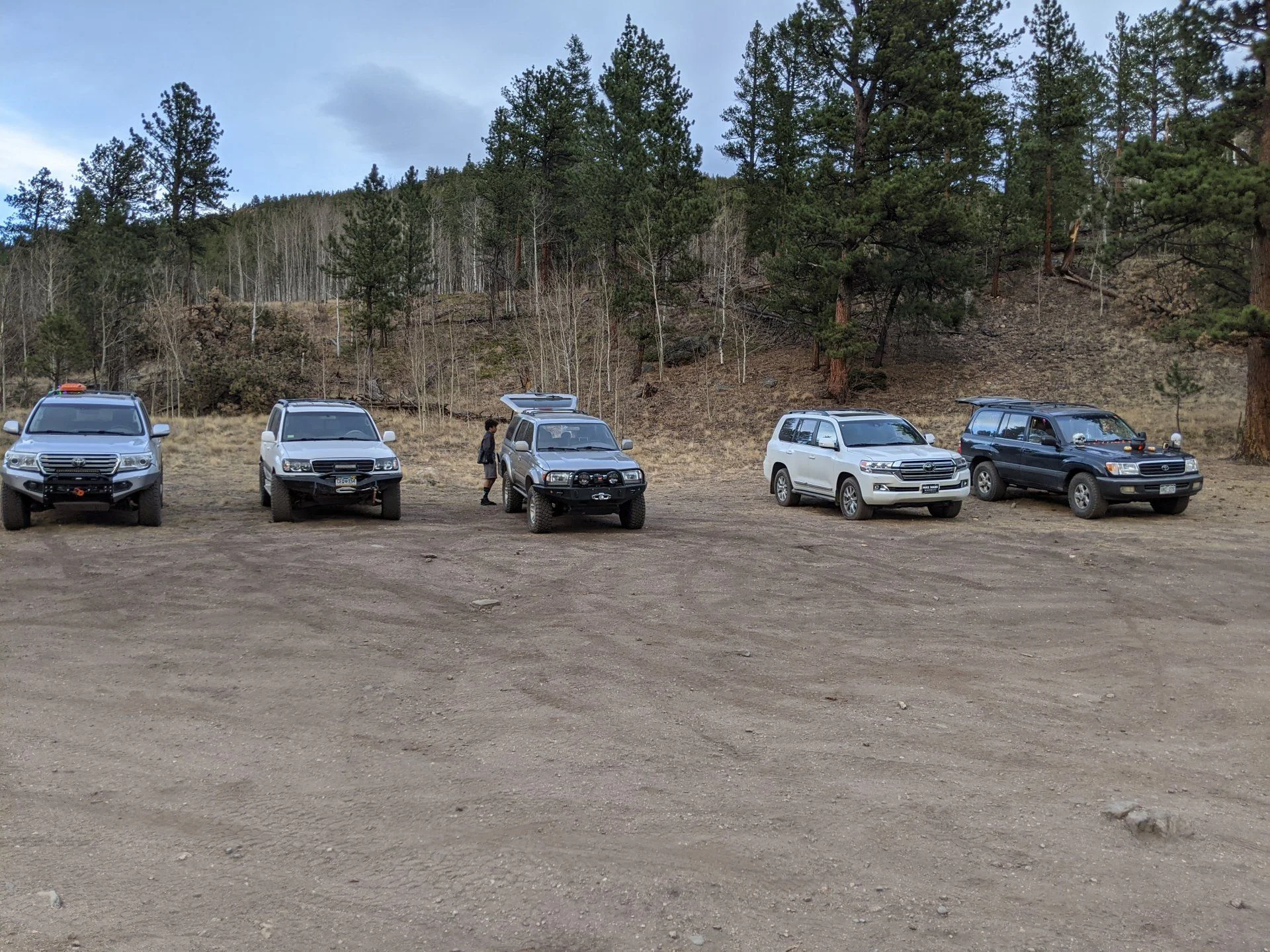

I was itching to take the truck out on a trail. I had spent over a year researching and watching videos of others wheeling their trucks and I wanted in! I had posted on Mud asking for trails nearby. I was told a local club (Rising Sun) was about to have an annual wheeling trip and they said I could come along. I gladly accepted. That weekend, I packed up the family and we headed out. This was an important trip because it could have made or broke the reason I purchased the truck. I wanted to wheel and camp! But I'd never wheeled before. Crazy to buy a truck for that reason without having done it before, right? We hit the trail with the club and afterwards and the wife and I were hooked.

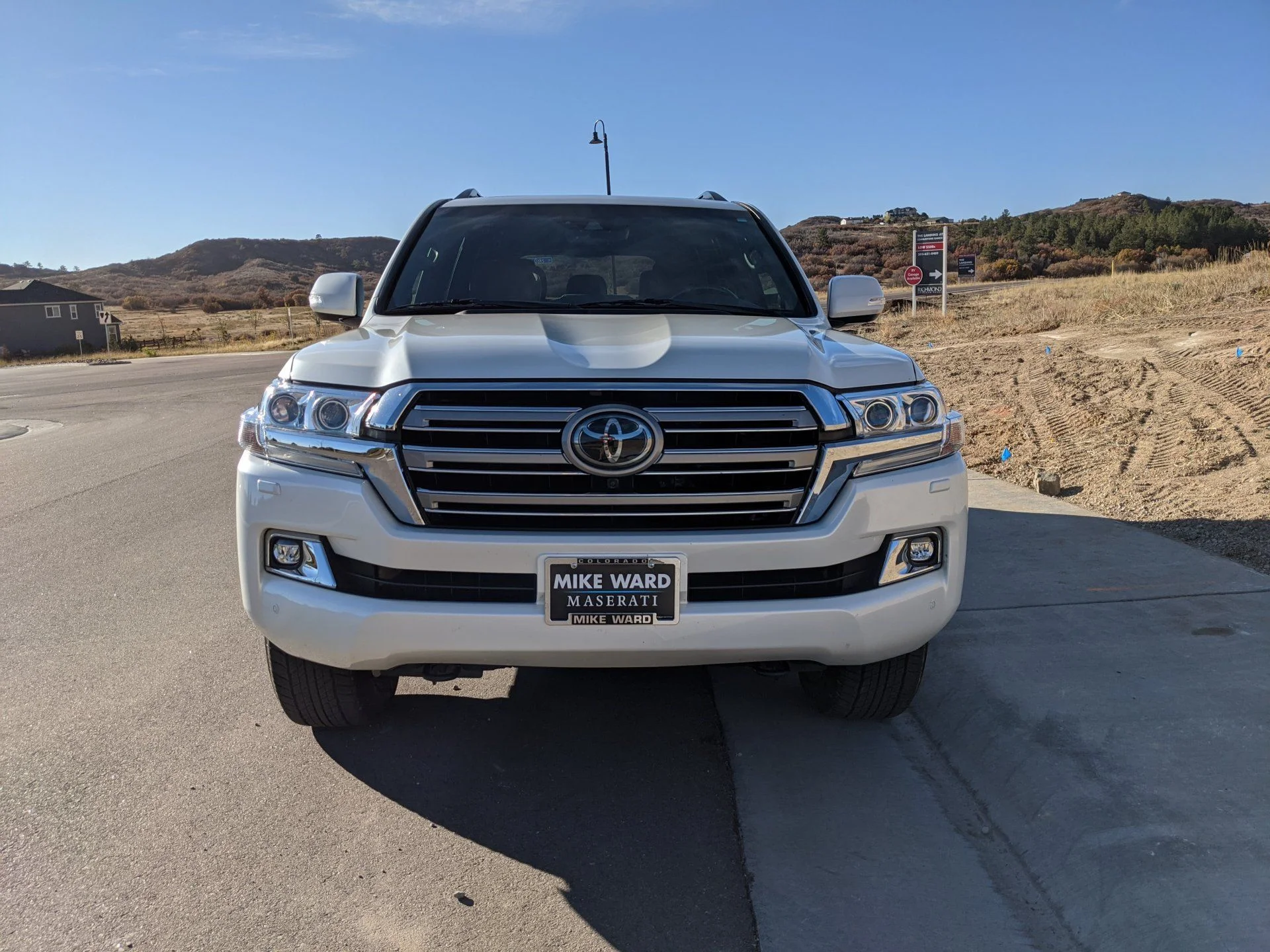

Here's a few photos of the truck just after purchase.

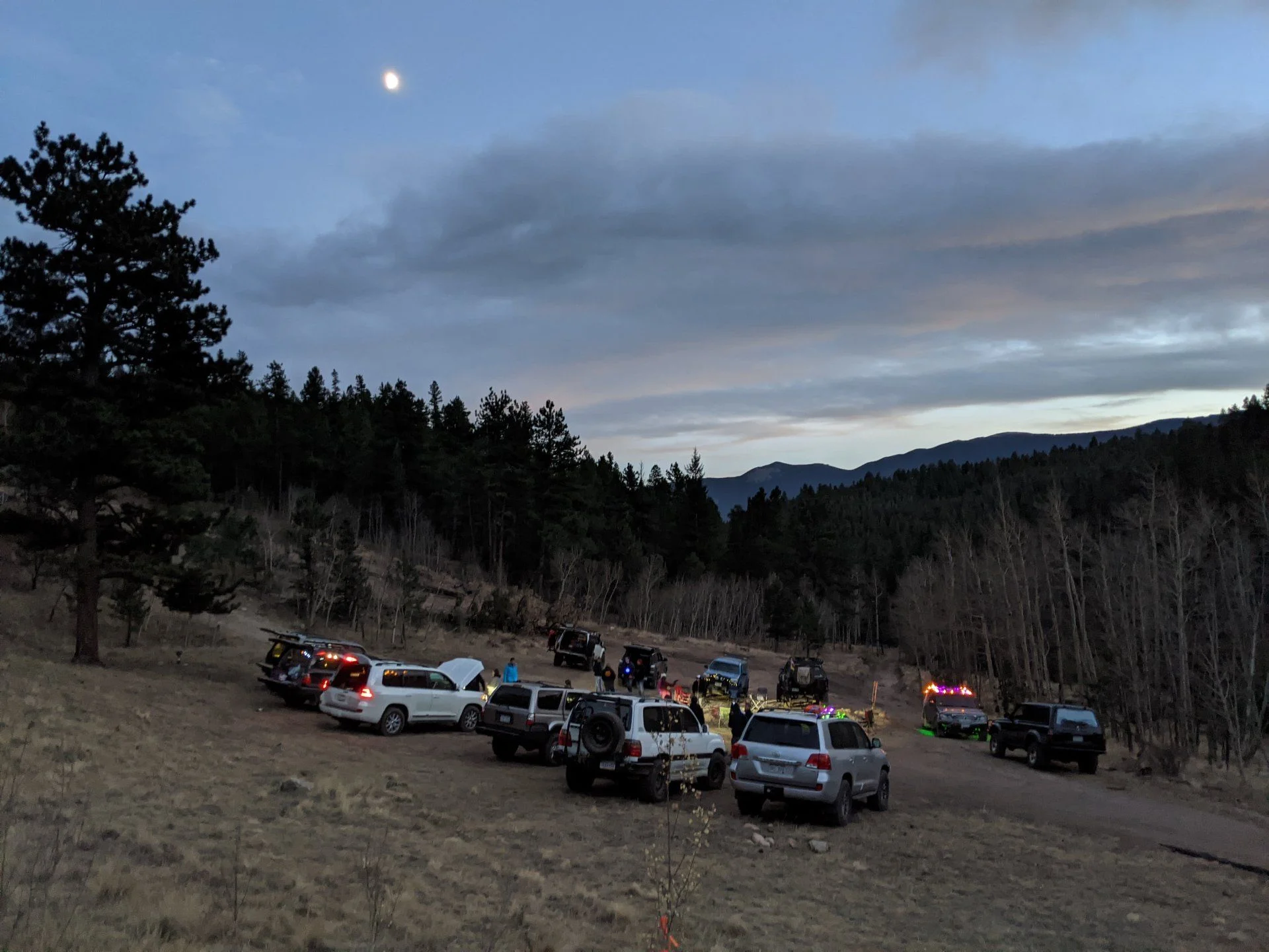

Here's a couple from the vehicle's first trip off road.

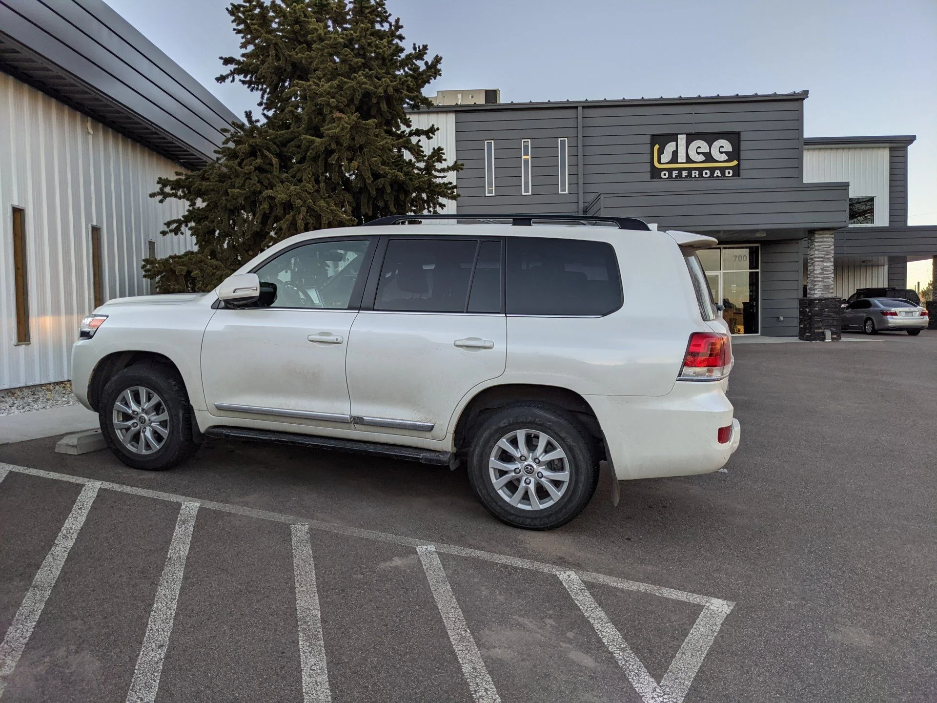

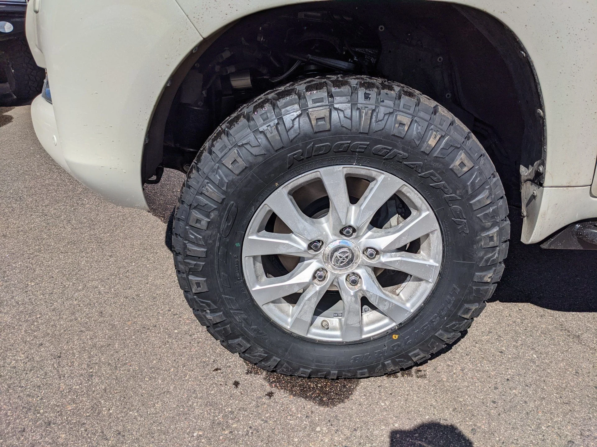

After the first wheeling trip, we wanted a little more safety while wheeling. The stock tires worked, but we were worried they would tear off-road. Not to mention how lucky we were to only scratch the running boards. It was time for an upgrade.

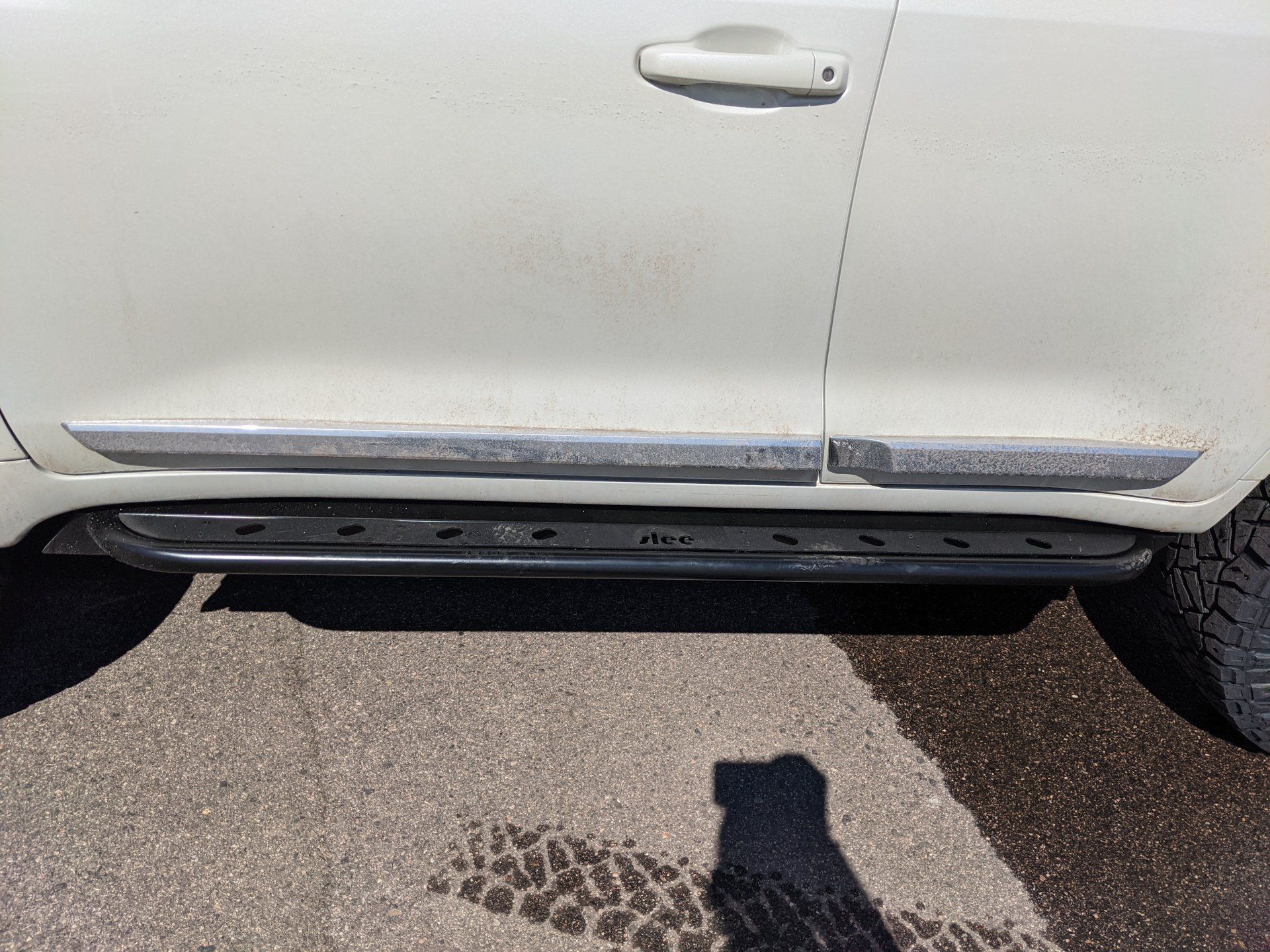

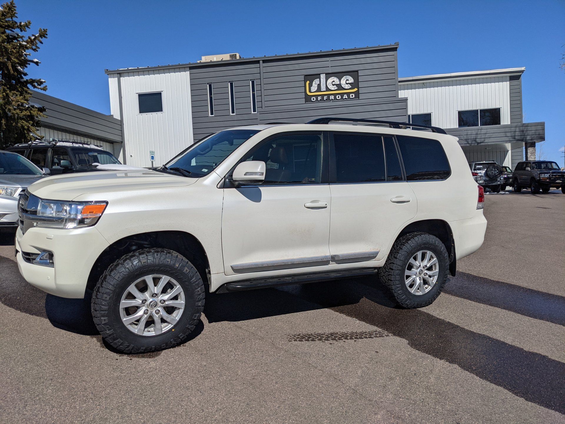

After a lot of reading I decided on Nitto Ridge Grappler LT 285/70/R18 on the stock rims and the OME BP-51 shocks and lift. I spoke with Christo and Amory at Slee. They suggested I add SpiderTrax spacers to help the tire clear the KDSS arm. And while we were at it, let's throw on some sliders. Here's the before:
And the obligatory Slee photo. I think it looks great sitting on 2722 rear springs. Exactly what I was picturing.

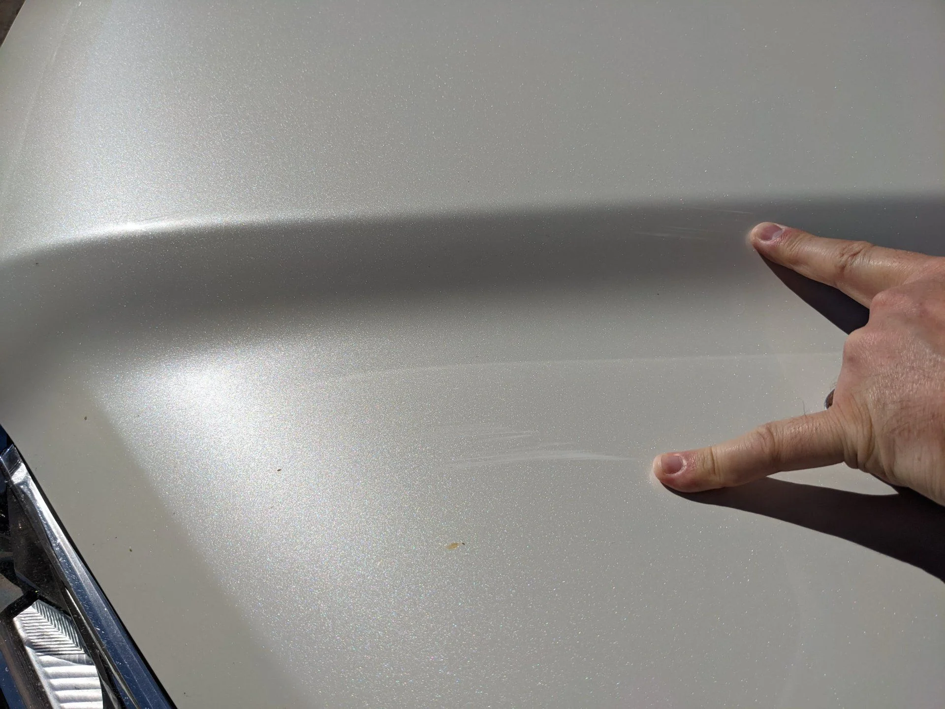

There were a couple set backs along the way. First off, before I installed the NaviPlus unit, I was thinking I'd utilize the stock USB location. To do that, I needed a USB-PAC cable. There is a local car audio shop nearby that sold them. I took a little drive to go see them. While I was on the highway, a car in the far right lane kicked up what looked like a piece of siding. The siding hit the hood, bounced and hit the driver's side A pillar. Awesome. There was a huge scuff on the hood and the A pillar had chips of paint missing.
I got a hold of a body shop and took the vehicle there. After going several rounds with insurance, they decided they weren't going to pay for the paint manufacturer's and Toyota's recommended policy of painting the whole side of the vehicle. I was not happy. In the end, the shop suggested that I take the money insurance gave me, fix the hood, and use some touch up paint on the pillar and then cover it all in paint protection film. I covered the hood, the A pillars, the front fenders and 8" on the front of the roof. I was happy with this as it will protect the paint when we're wheeling. That was a couple weeks without the truck while it all got sorted out. I do need to add more PPF to protect the doors and rear pillars.

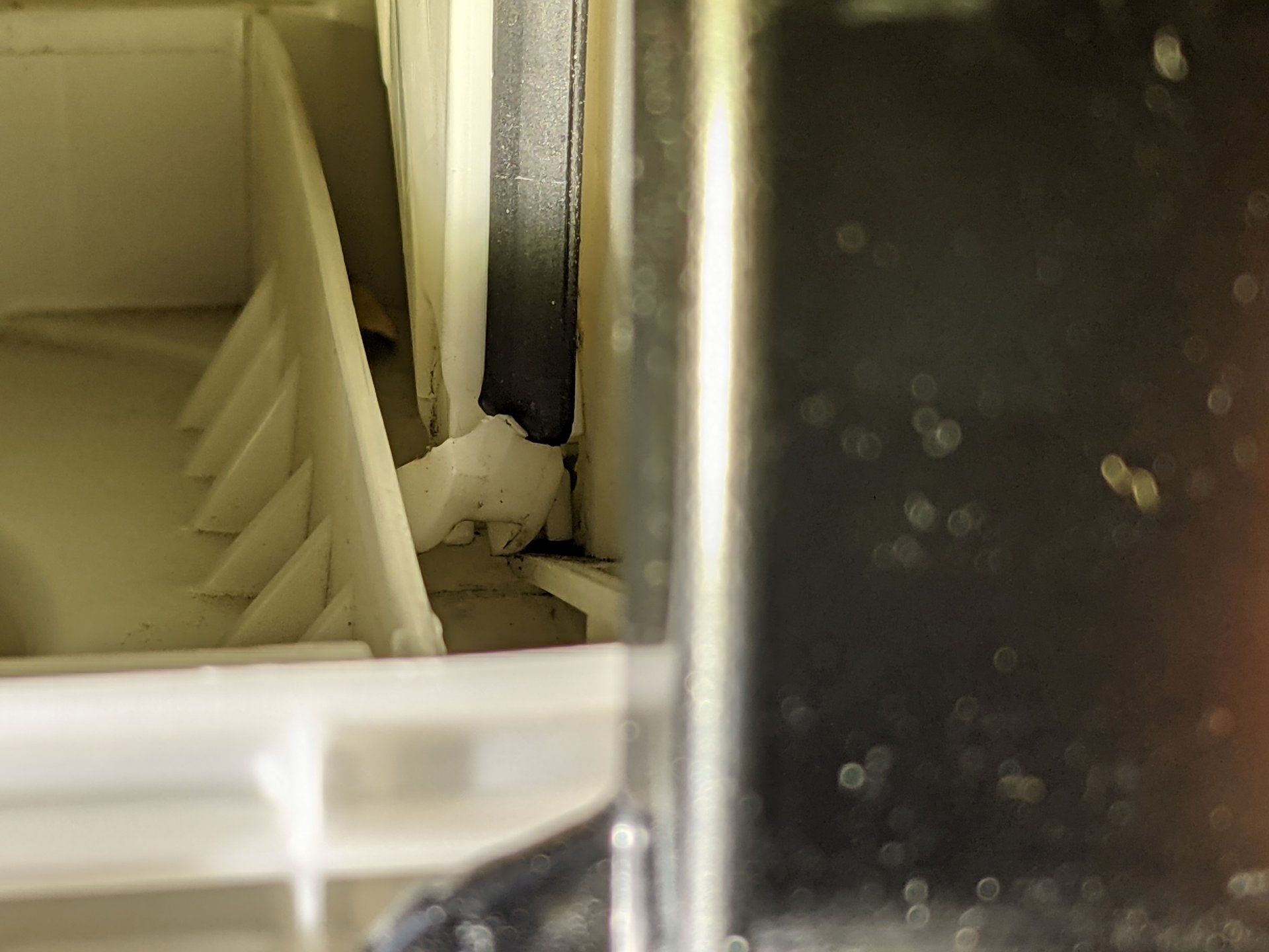

Secondly, the dreaded HVAC recirculation door issue. Before buying the truck I had read about the recirc door problem. I knew I should have checked for it. But the day I went to test drive the truck, I just totally forgot. I was too enamored. But the door was broken.
Luckily, the factory warranty still applied until December of 2021 or 36000 miles. I booked an appointment at Stevinson Toyota in Lakewood. They told me that even though I had the CarFax that showed the vehicle being serviced at Toyota dealerships, that there was little chance anyone would claim that they broke the door. They also said that the local Toyota Regional Service Manager would have to come by to look at the door and see if replacement would be covered under warranty. The 200 was supposed to be gone for 2 days, but it ended up being 6. However, in the end, Toyota agreed to replace the unit. That's great, because otherwise it would have eaten into the mods budget!

This is definitely the plan. The next phase is listed as electrical, but I've only got the 4 RG tires and the stock spare. So do I go for electrical next, or a rear swing out that can carry the RG tire? The original spare will get me safely home if I go slow, but it would be nice to have that RG spare. Lots to think about.
Any reason you haven’t purchased the spare yet? If you’re worried about size, you shouldn’t have a problem with it fitting in the stock spare location. I have LT285/75 17” Ridge Grapplers (34”), fits fine.
I had asked that question before the install. I was told that the 285/70/R18 wouldn't fit in the spare location. I've read here a few success stories, but no detailed info on removing a bracket that could block the tire from tucking fully underneath the chassis. What I need to do (which I've not had time to do yet) is take down the current spare, take off a wheel and just try it. There's a blizzard happening right now, so I doubt I'll get the chance this weekend. Maybe next weekend. I'll also need the torque spec on the wheels.
