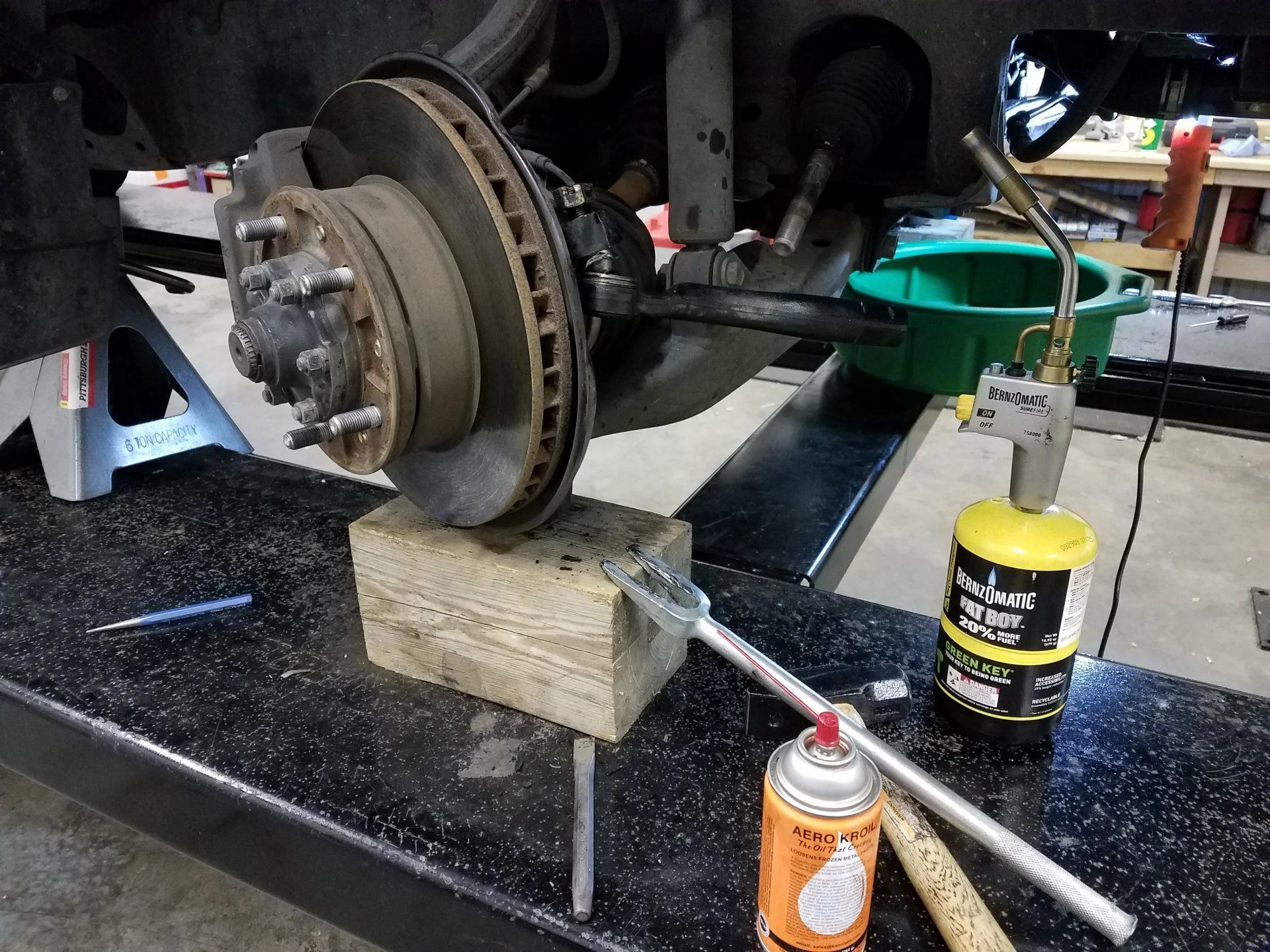

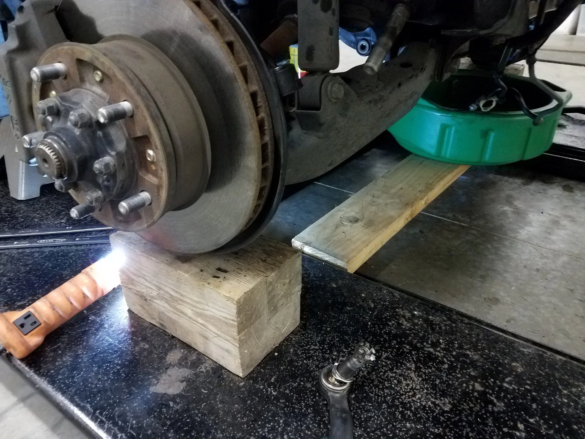

Does anyone have a better tool for removing TRE's than a pickle fork? It's just not getting the job done.

Okay, what now? I used the advice from MUD and used my old race to install my new race. Now how do I get my old race back out?
D'oh, Usually would use thick side to thin so that you could brass drift it back out on the slight lip exposed. I think you might have to drive both out and start over.
I keep old races as drivers but ground off the od so they come back out

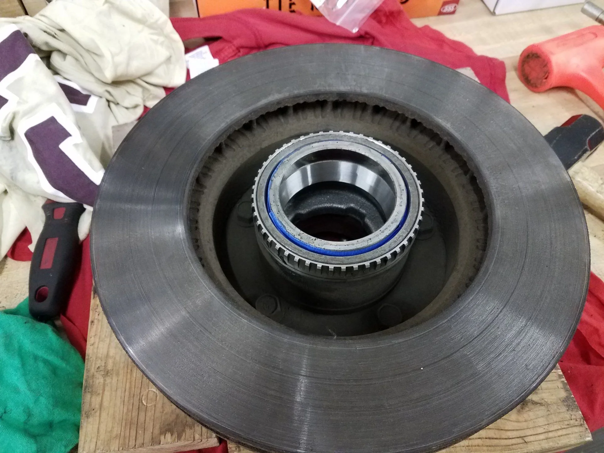

Do you guys think I could take these both out and reinstall the new race? Or am I going to need to buy a new bearing?

if you are punching with brass drift(so it will not damage the race), then yes, push it out enough to pop out your old race, then push back in.

Got the races out and back in. Got the bearings packed. Followed the FSM when putting it all back together.
