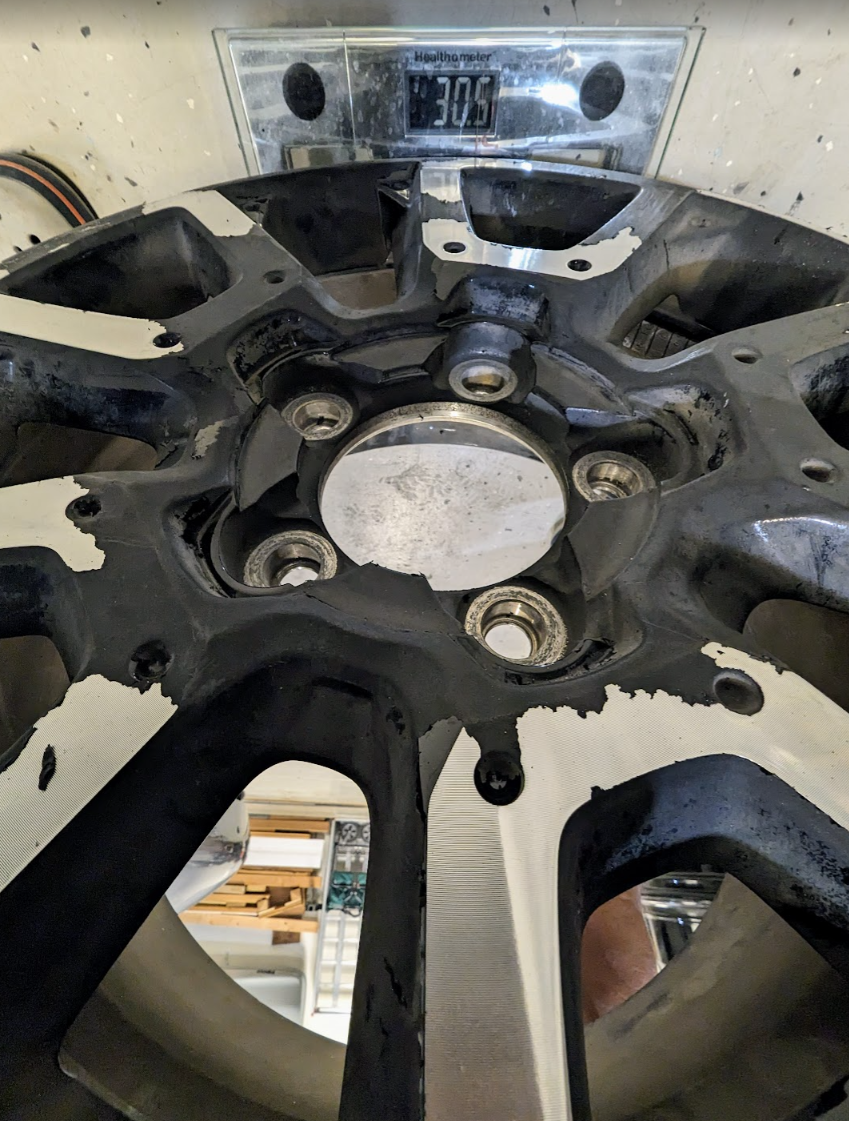

Since I have it handy to scale, these Tundra 18x8 +60 OEM wheels are 30.5lbs.
I strongly believe any of OEM wheels are going to be stronger than most aftermarket stuff that are commodity these days.

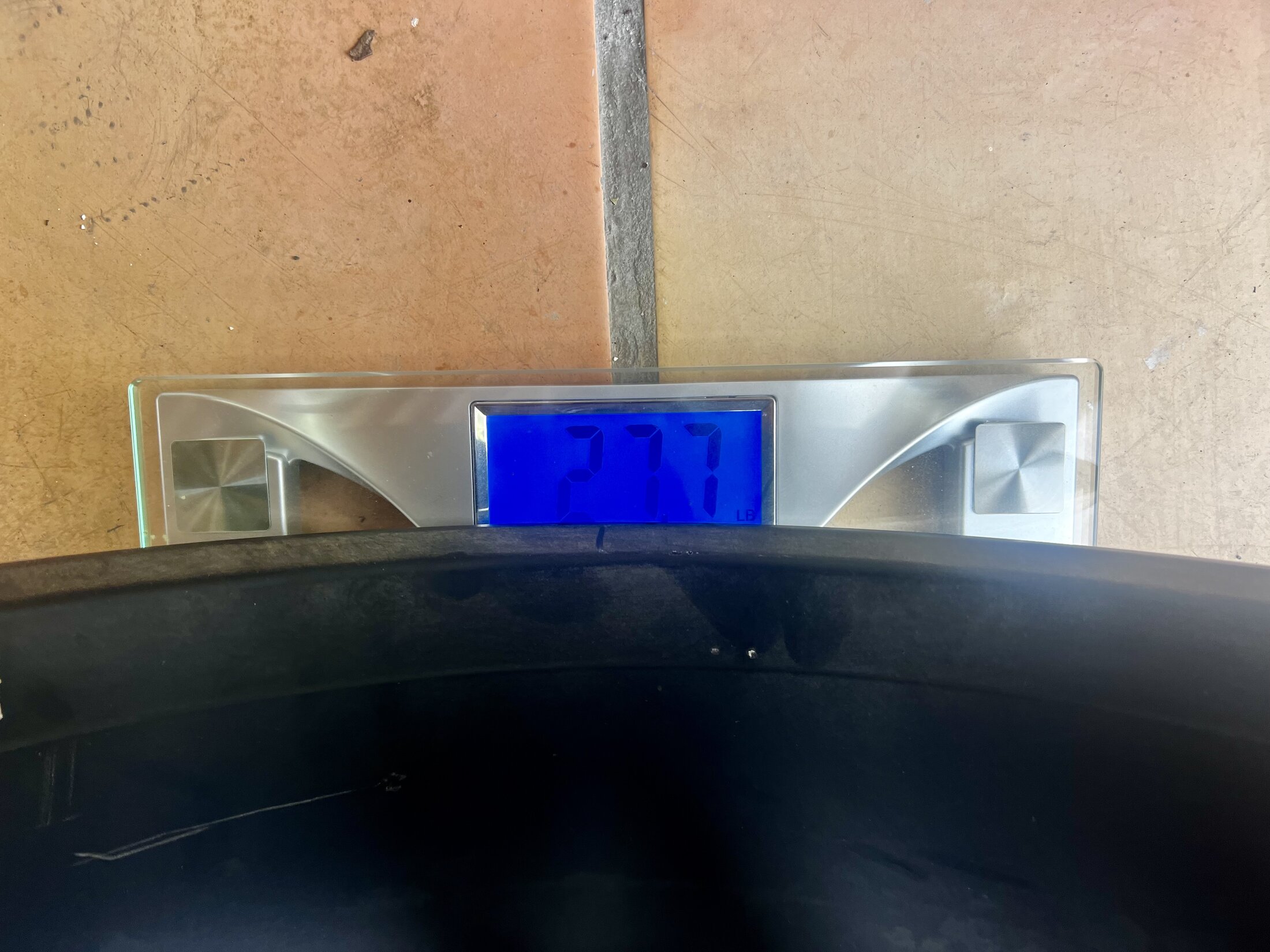

Ya got me curious and motivated. Put one of the BBS wheels I just got on scale. 27.7 with no center cap or TPMS. Difference of 3.3lbs over stock.
Will I notice weight difference in driving and handling after putting 33s on them? Absolutely not. It MIGHT end up being an even wash with bigger tires and lighter wheels.
