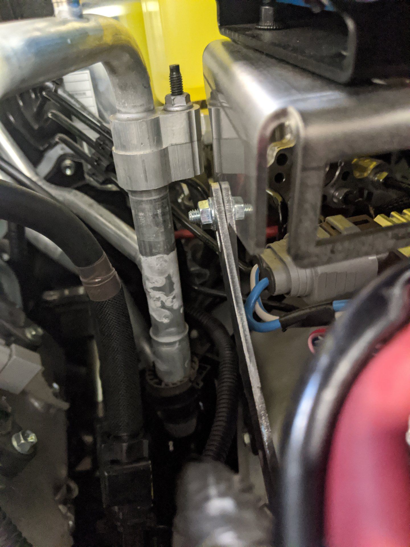

kept getting the check engine light after clearing.

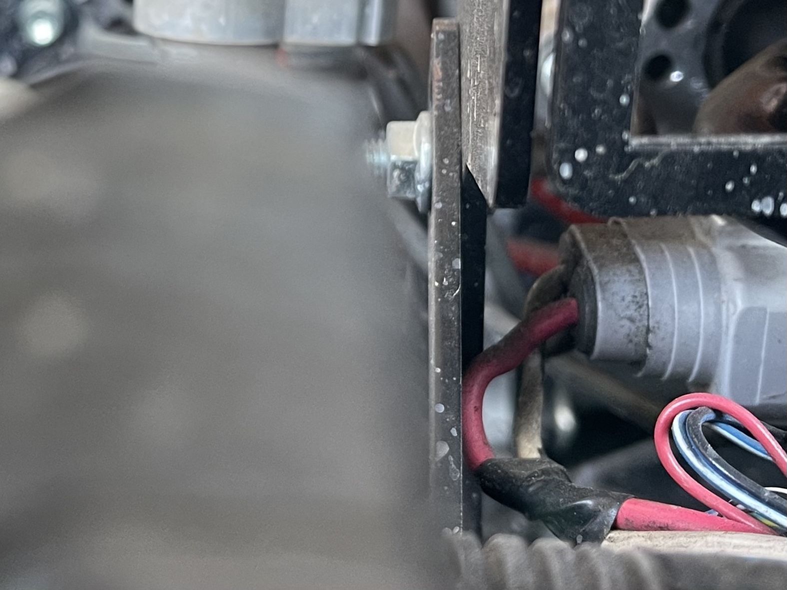

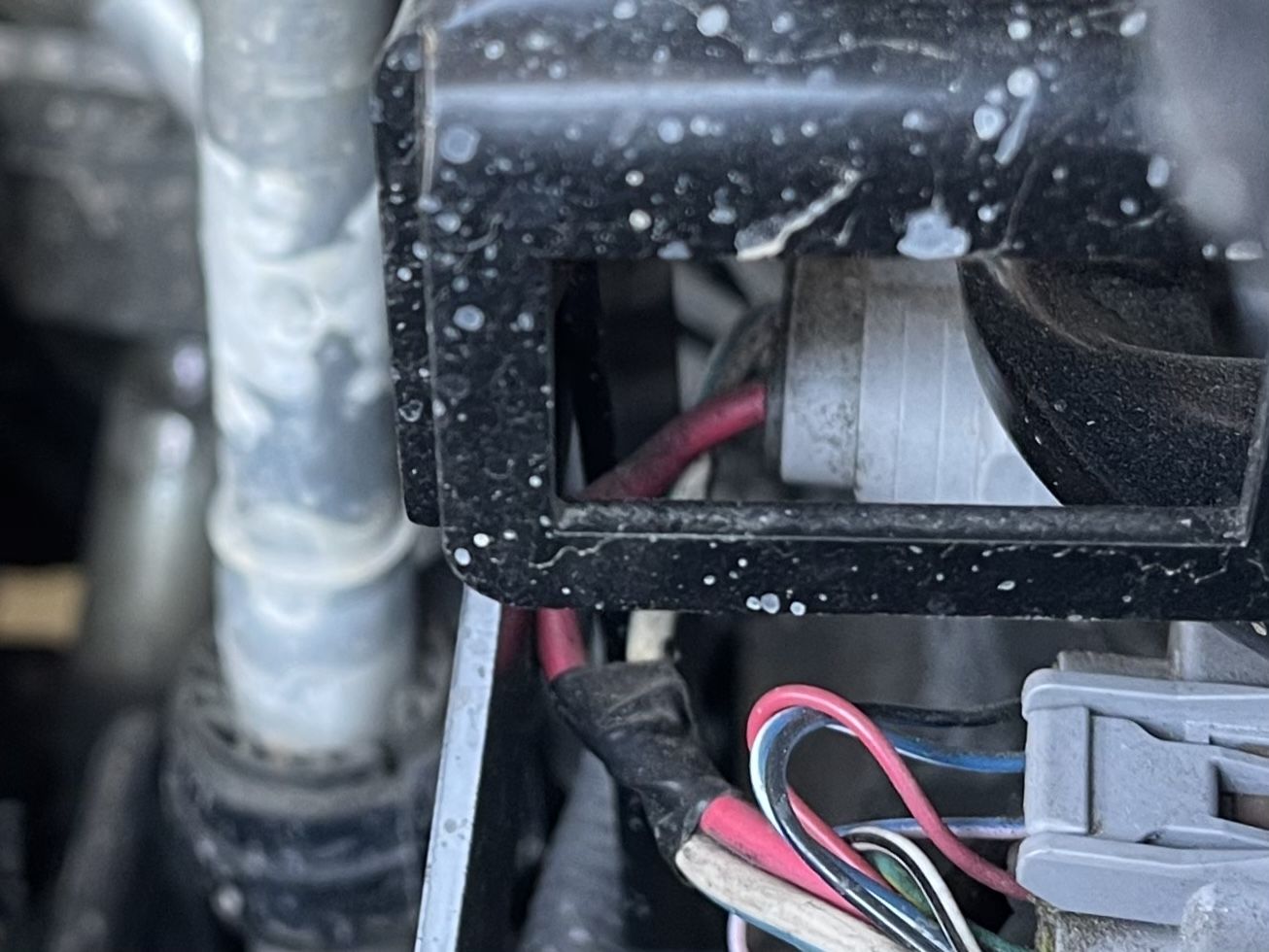

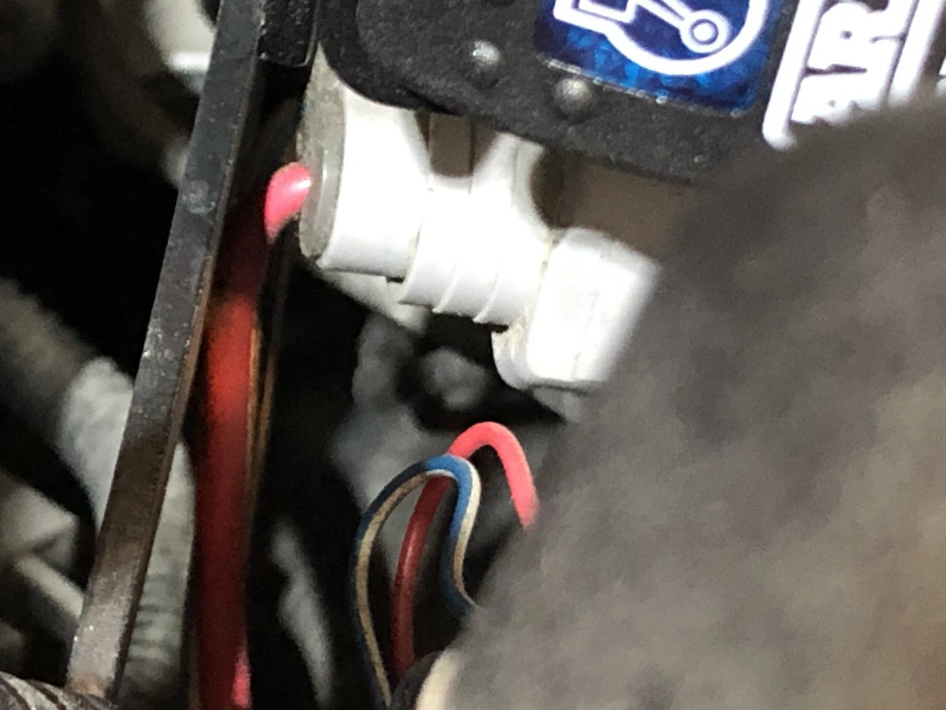

Started to do some dismantling and noticed same problem as Charlie; Bracket had pinched / rubbed wire in very short order. Some fabrication adjustments and wrapping the wires hopefully it’s fixed.
Can others with the Slee compressor bracket go check theirs? Seeing it twice sounds like a pattern...
Is anyone from @sleeoffroad able to comment? Did both of us mess up the install?

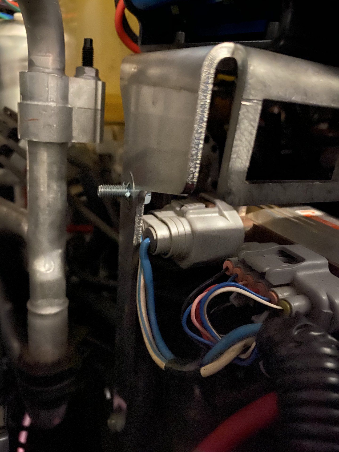

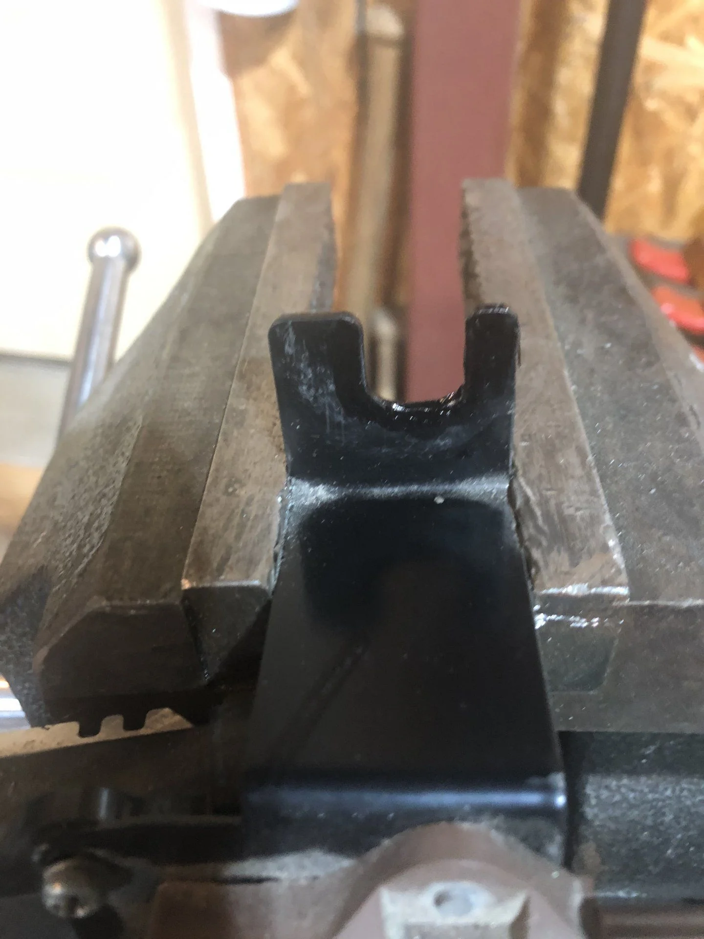

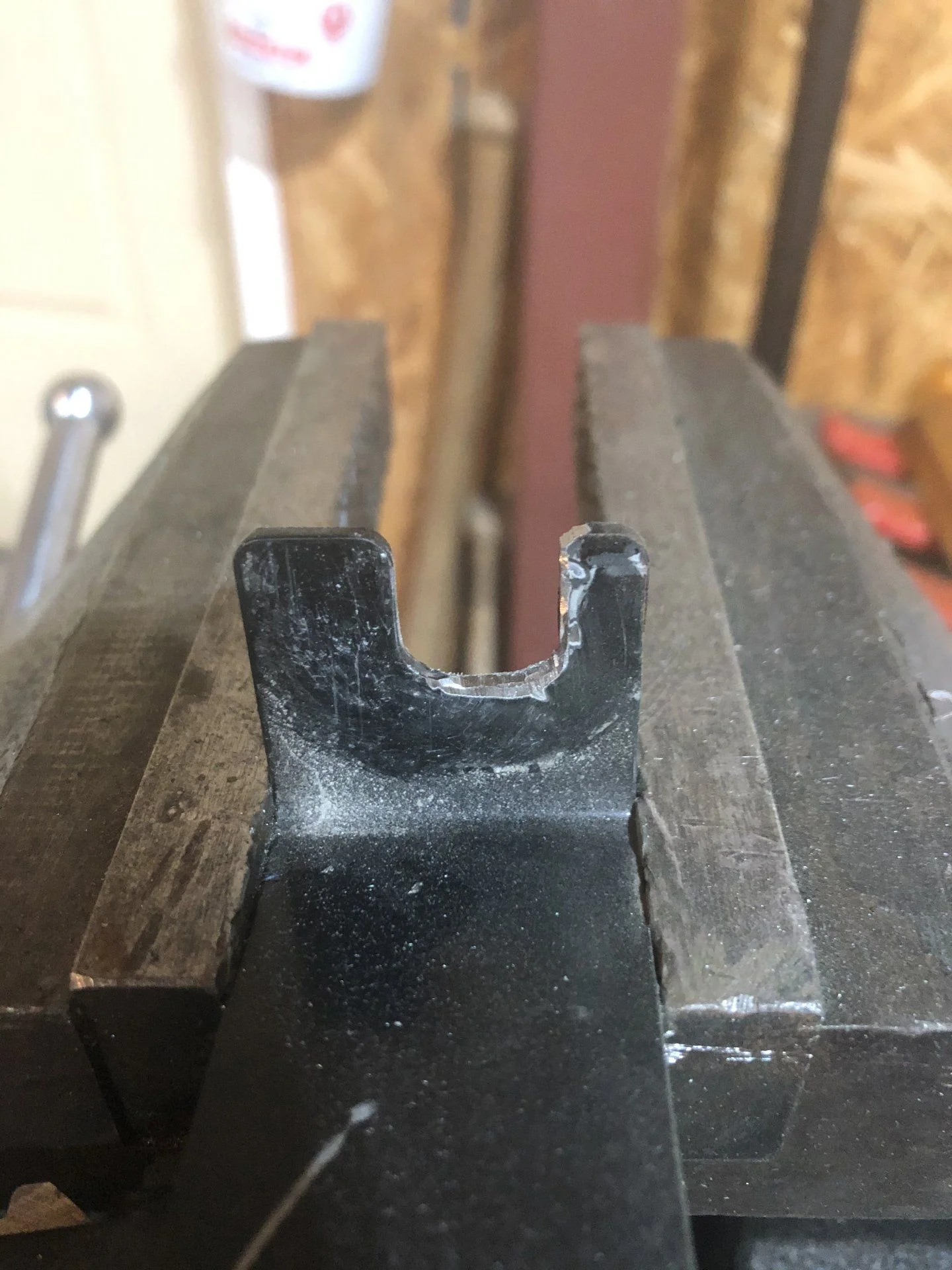

Thanks. I couldn't achieve that much space. I ended up opening up the notch in the base mount and eventually replacing the controllers with the Hewitt Tech (both problems solved).
originally:
increased notch clearance with a hacksaw and file:

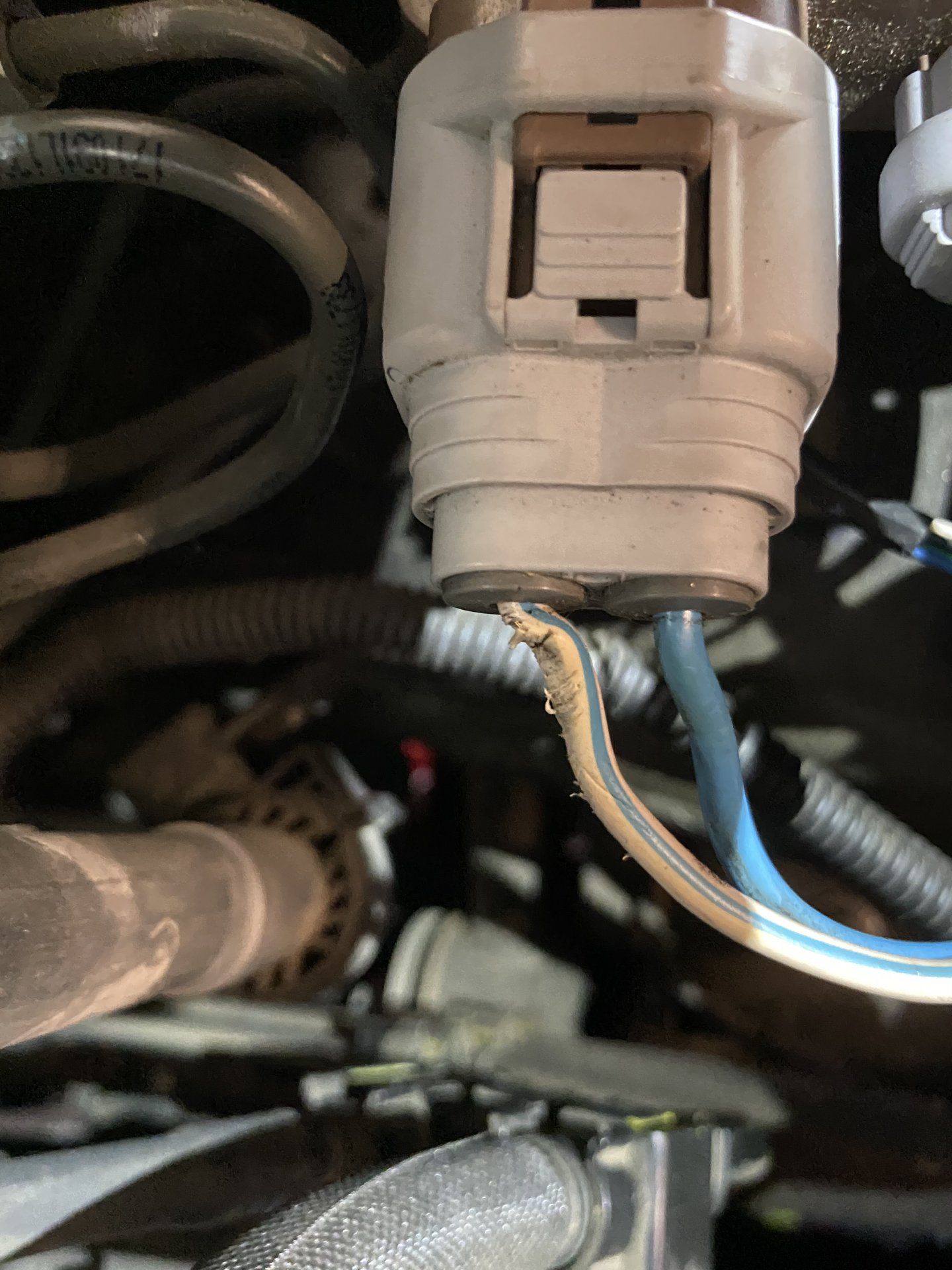

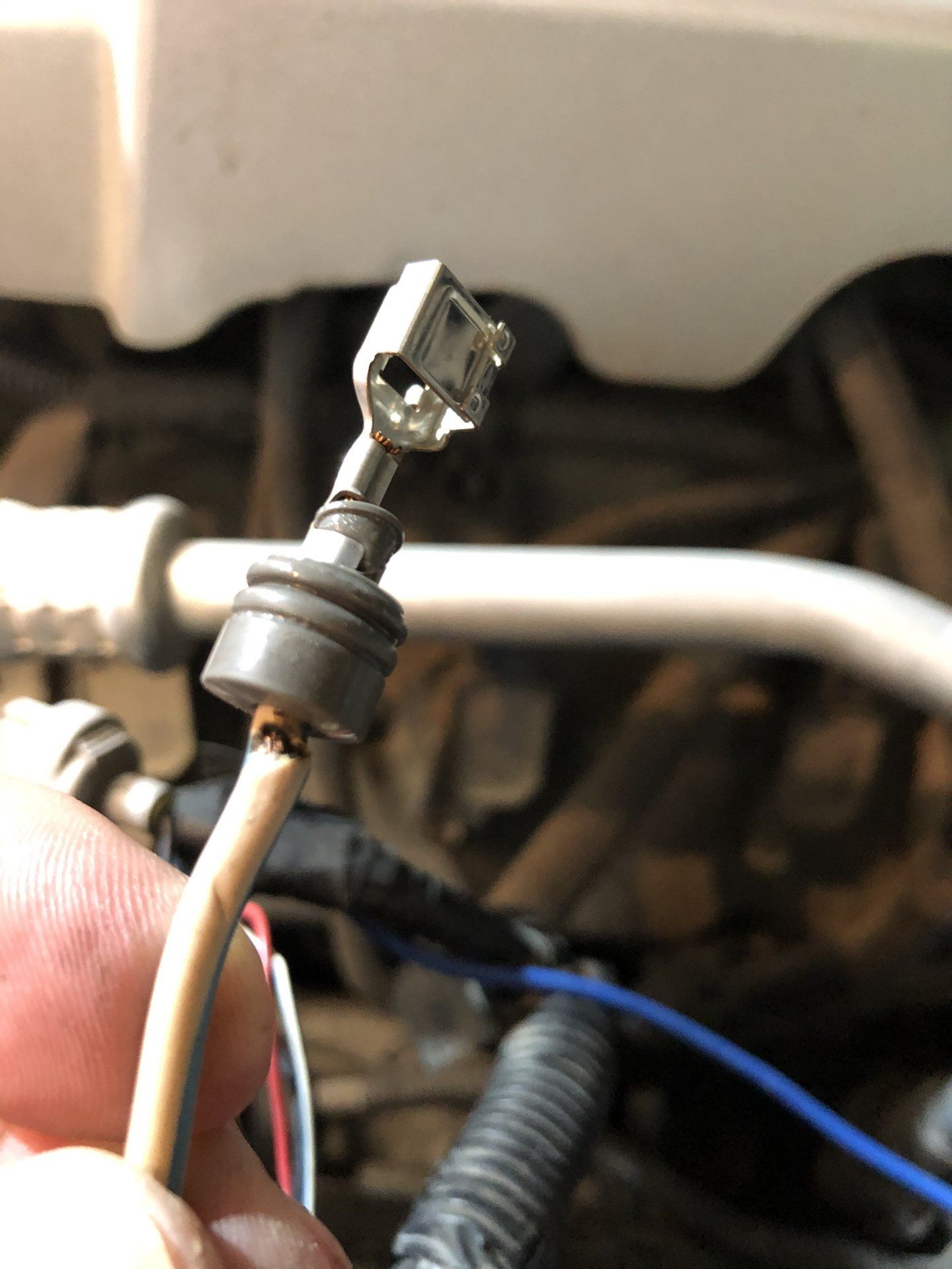

Thank you. That's a solid lead! I did relocate them six months ago for the slee air compressor bracket kit, so I wonder if if I have some long term damage from rubbing, etc...? Since I moved them with the slee kit, I don't have the same locations as stock. Do you recall if it is the brown plug plastic one or the other (maybe black?) that is bank B?
@CharlieS RTH- any tips on extracting that wire from the connector?
Sorry, I've pulled so many connectors apart it doesn't ring a bell. There is usually a locking function, a tab, a cover, something that clips them in.
Thank you! I got the connector about, but no joy.
Just checked mine... looks like I got lucky during install.
Thanks for all of the shared experiences on this thread! I was dealing with this CEL for a few weeks and it also seemed to happen about a week after upgrading to a clone ARB twin compressor I got on amazon. Post reset. it would work for the day but would always come back. After reading this thread, I found that one of the wires going into the the top AID (Air injection driver) had been cut into by the slee bracket also. Not sure why it was fine when I had a single on there but nonetheless, I assumed it may have fried the part somehow so I ordered a new one (89581-60010) and it seemed to do the trick. It's been over a week no recurrence.

I also took to my Slee bracket with a de-burr tool and a metal file to round the edges.
I figured even if I installed everything correctly a wire could shift or move and the edges are pretty sharp.
