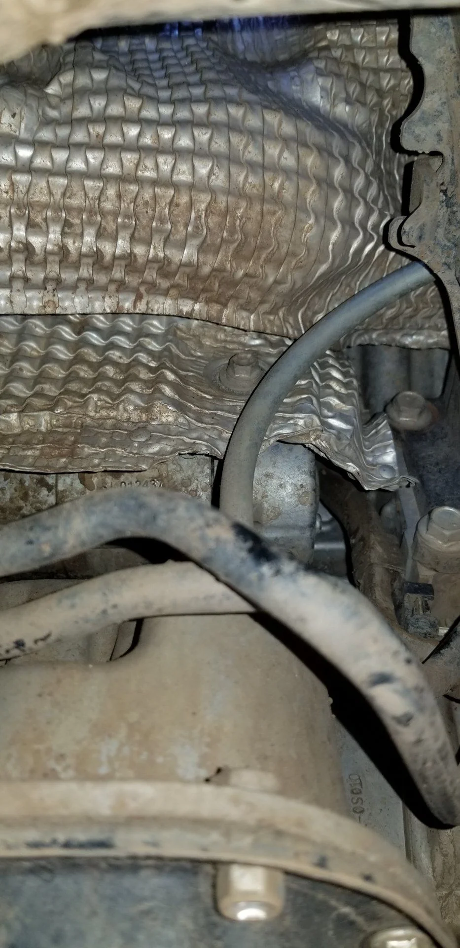

This is not going to be easy.
The issue is the smaller solenoid that is piggybacked to the starter (lower thing in the picture). It serves 2 functions: 1) Pushes the starter gear forward to engage with the starter ring 2) Relay power to the starter motor itself. The problem lies in #2. The goal is to jumper power to the starter at the braided copper wire. Yet don’t fry anything else by accidently grounding a hot screwdriver on something.
The jumping has to be timed with pushing the “start” button. Which gives about a ~5 second window of time, where #1 happens. And you manually do #2.
I haven’t done this personally, so take everything with a grain of salt. I think I would practice to see if I can jump the starter first (hear it spin, it won’t hurt anything). Either by way of using a jumper wire to the screwdriver (perhaps lots of tape to insulate things except the tip…you definitely DON’T want to accidently ground out anything). If you can do that, then have someone coordinate with you to push the starter while you do #2. Make sure the vehicle is in park!
There is a large gauge power wire leading to the relay (in picture, lower thing, right bolt). It is enclosed by a plastic cover. Perhaps instead of a jumper cable, one could try to bridge that hot wire/bolt on the back of the solenoid/relay, to the copper braided wire.

Just to confirm, the insulated wire shown in the pic above will not help trying to put power to it?
I have an insulated long screwdriver. Is there something else I may be missing that would allow easier access to the braided copper cable?

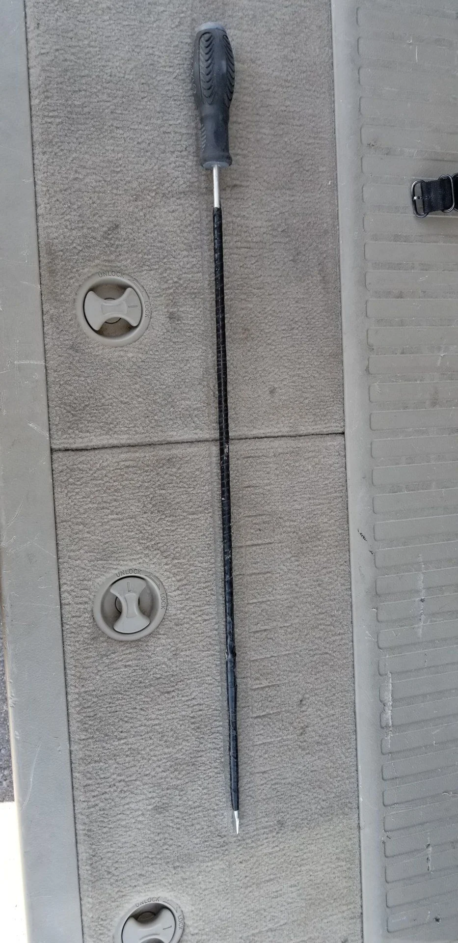

Man this is super info to throw in the brain for the boonies. Two foot long screwdriver? Wow! Never seen one that long! (Cue Michael Scott...) ;)

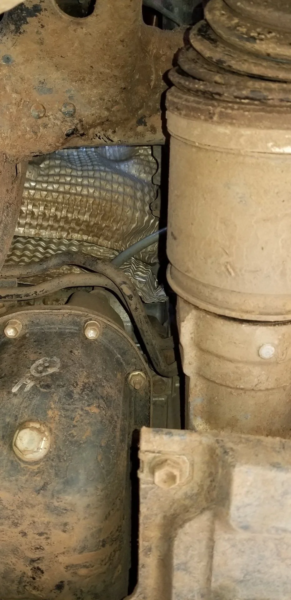

It's been a couple years since I had to do this start.
I needed to get out of the office so I went out to the parking lot to walk through it
Laying under the truck, just inside the passenger wheel, look up at the right side of the engine block, past the oil drain plug you can see 2 heat shields.
look closely and remove this bolt, then fold the foil back to reveal the starter and wire to the solenoid.
place the end of your insulated screwdriver on the bolt where the cable attaches to the solenoid.
Have someone push the button and energize the screwdriver.
gratuitous screwdriver shot for @Markuson.
Ha! Nice!
