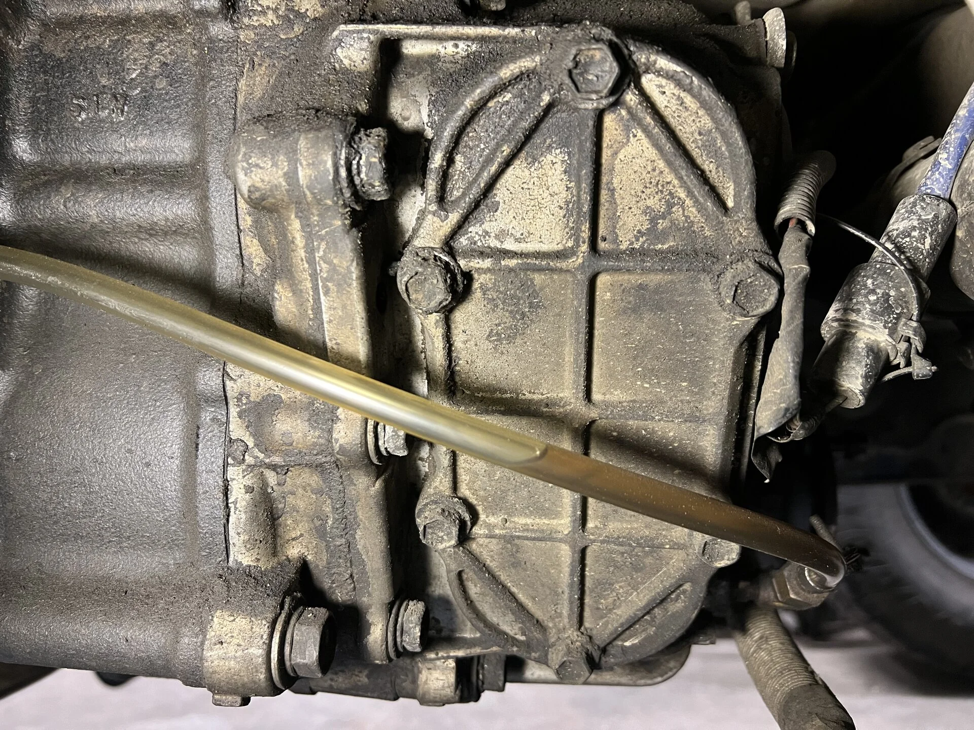

Does this mean the seal between the transmission and transfer case has finally given up? This is after sitting for a couple of weeks. Last night I noticed the fluid about an inch in the tube at the bottom. Now it’s definitely higher.
That would certainly indicate the fluid level is sitting quite a bit higher than the fill plug. The fluid is coming from somewhere and the trans is the obvious culprit. Given it has a bypass tube, I'm assuming fluid migration has been an ongoing issue?
This is the first time I have seen fluid in the tube. I installed the tube preemptively knowing this “common “ issue. This was one of the first mods I did when I first got the Ute . I haven’t driven it since the fluid showed up since I still have the front axle apart for the elocker install. Waiting for the last parts from you guys to get here.
