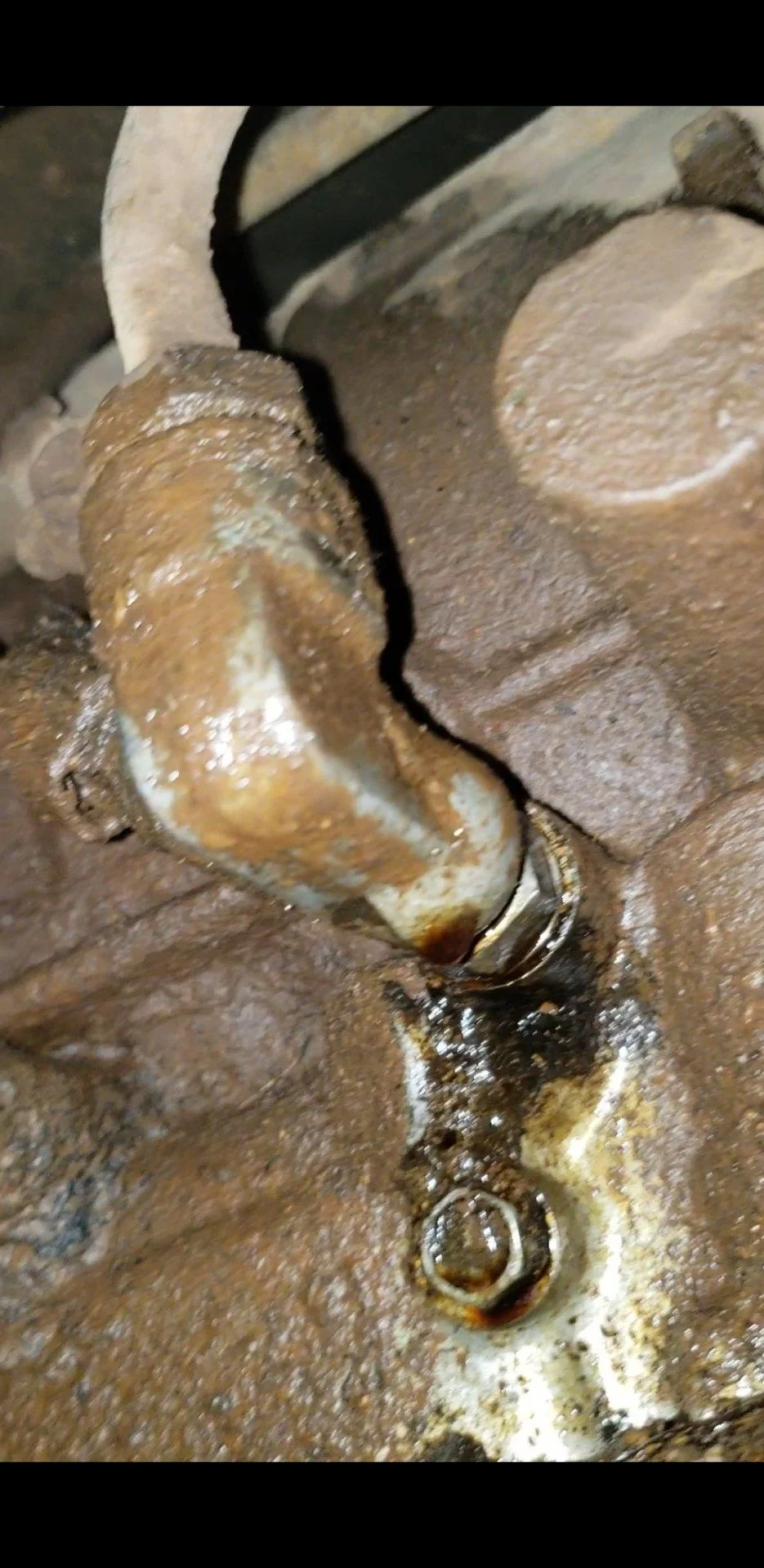

Today I decided to repair some things and I found this transmission oil leak, someone knows how to repair it.
that is one of the pipes leading to the front of the vehicle
no direct knowledge on this fitting, the 90 has a jam nut to keep the 90 in position
looks like an oring boss type fitting
try tightening the jam nut first,
if tight the oring may be bad
