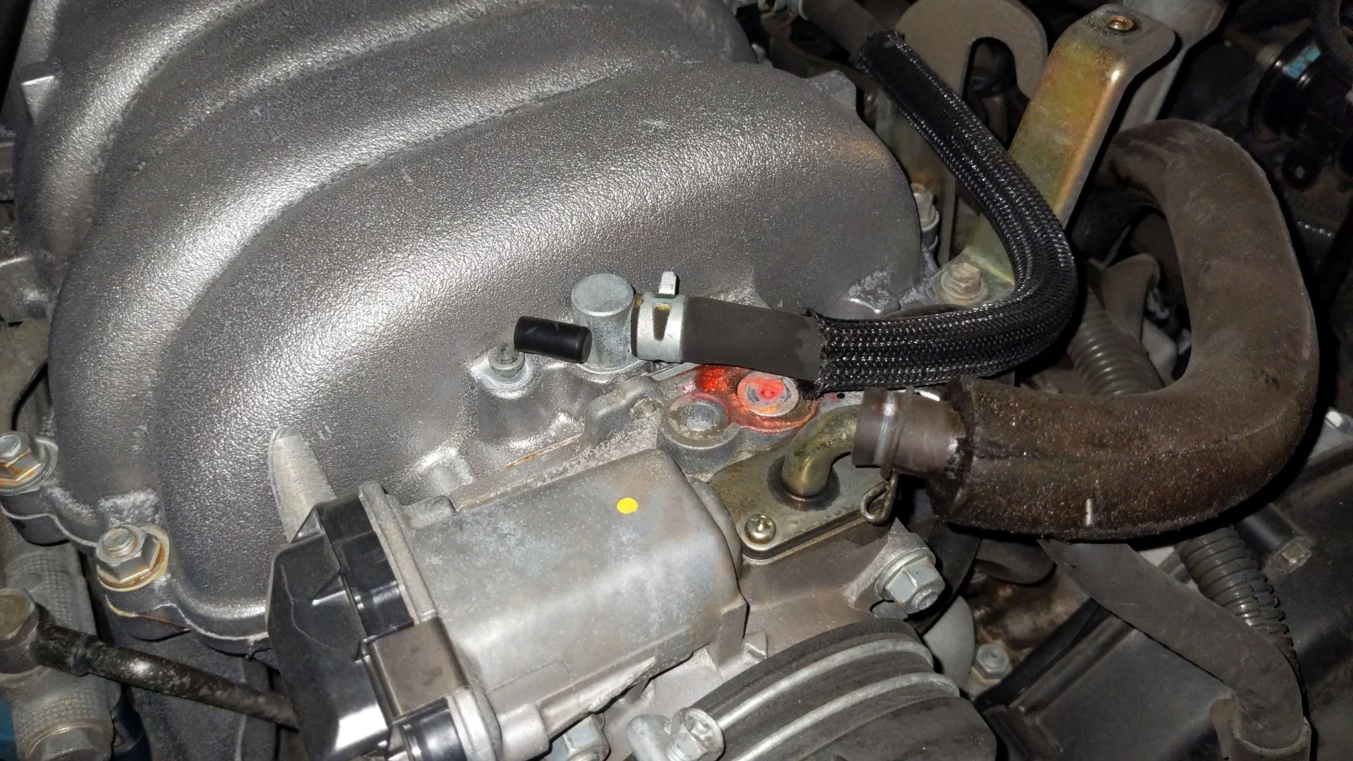

Similar issue here on my end. I thought I was leaking power steering fluid until I changed the oil and saw this on the transmission:

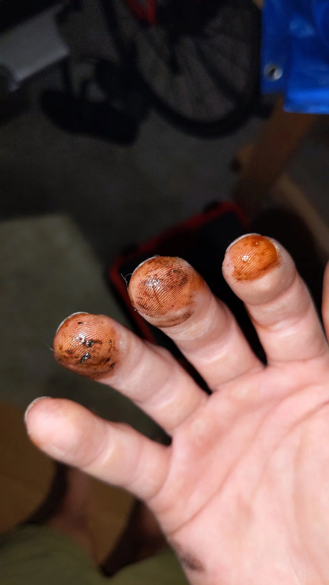

Wiping it off, it looks darker than coolant but its also pretty dirty:
I checked my coolant and the reservoir is nearly bone dry. I need to give it a fill. There is still enough in the radiator though so no heat issues so far. I looked at what WRP2 posted earlier and saw this, which tells me I may in fact be leaking coolant out of that spot on the manifold, but not as much as he was:
Any thoughts here? Leak on the tranny looks pretty dark, but I'm also dangerously low on coolant...I will get some of the toyota super long life coolant for it, but does that leak look dark enough for me to need to take it to the dealer or a shop?
Get a flashlight and look under the intake manifold into the valley underneath it. If its stained red or still wet even with coolant then I'd say you have coolant leaking into the valley and down the back to the bell housing. Think about how much grime that red coolant is going through to get to the bottom of that bell housing. it will make it look really dirty. Thats what happened to me. I never suspected coolant causing that leak and I chased a transmission leak for weeks before I found the info here and found out it was coolant.
The oil at bottom of your bell housing weep hole. Can be ATF (red) or engine oil (brown). My first impression looking at picture, was engine oil. Key will be which is loosing/low fluid.
Your low coolant, may or may not be a leak. Very often coolant systems are under filled, after a service. The throttle body leaks are generally so minor, they have very little effect of coolant level. Top coolant with your year correct i.e. 98-03 Toy LL Red. 04- Toy SLL Pink. Do this by driving with both heater set to max. Then park level or better yet, with front end higher than rear of vehicle for 8 hours. Then early in the morning, before sun warms the air, radiator or engine. Check that the coolant level, is to the top of radiator (to the neck under cap), by removing radiator cap. Then top reservoir. If you add any to the radiator. Repeat topping the next day. Keep in mind when look at coolant reservoir, it's level will vary based on coolant temperature.
Look over the engine, from top to bottom all four corners for sign of coolant leaks. This includes head gasket. Especially if coolant level drops again.
