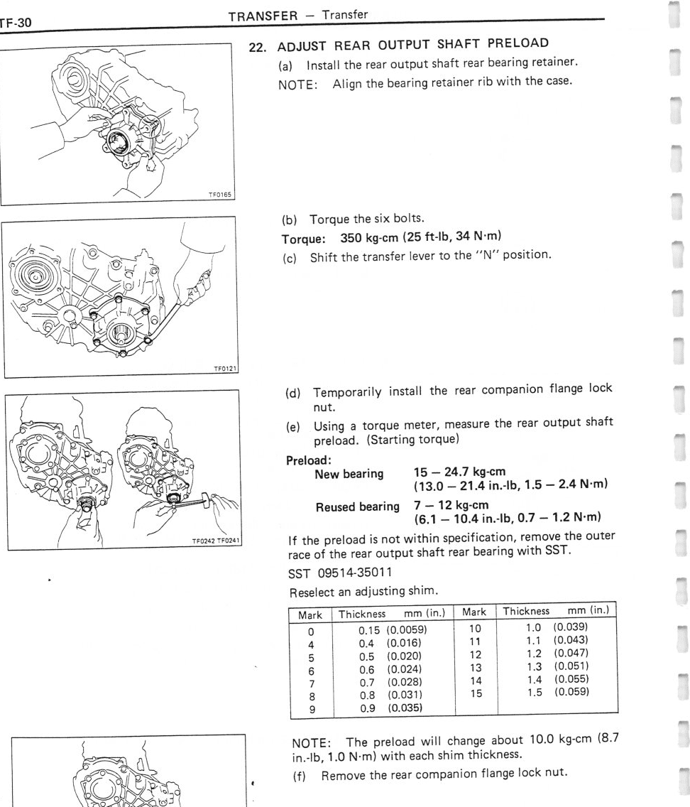

does anyone know the torque specs for the rear transfer case output shaft cover?
I know the flange nut is 94#
Thanks!
25 ft lbs. good time to check preload before you put the drive shaft back on.
